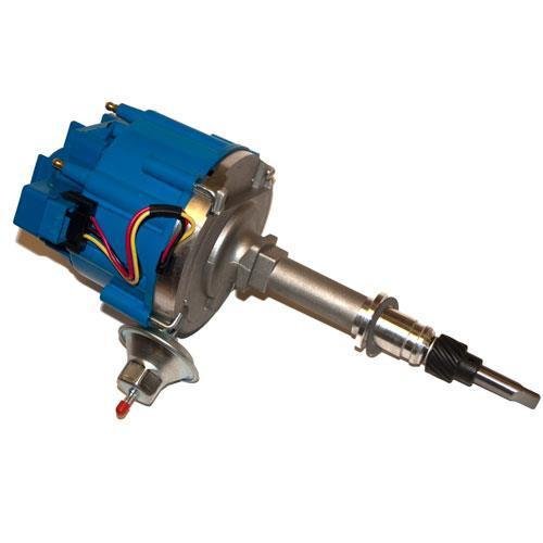

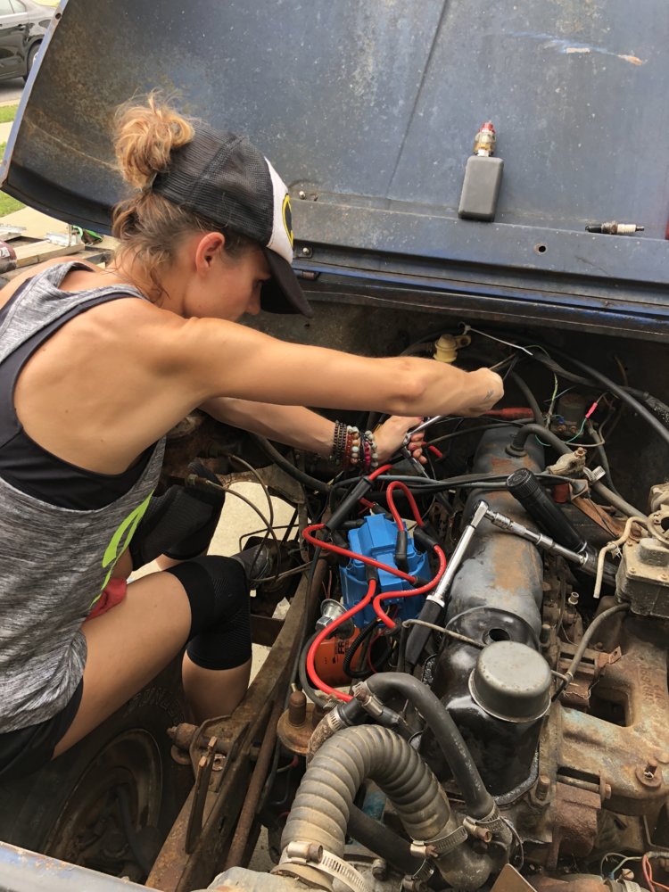

In my effort to get this beast running, I ordered an HEI distributor, plugs, wires, oil, filter and marvel mystery oil. I also picked up a used battery from Autozone. It all came in on thursday.
United ignition wire 6516-3
My supervisor is a Nurse, so I robbed a syringe from her and shot a couple cc's of marvel mystery oil in each of the cylinders. I bypassed the solenoid and tried to turn the engine over. The wires heated up like a $10 dollar space heater from dollar general. With the starter locked up, I turned the engine over a few times via the fan. It rolls over smoothly and you can tell there is some compression there as you turn it. I plan to test the compression after the starter I ordered comes in. With the starter not working, I left the rest of it alone and moved on to tearing out shit that shouldn't be there like 12 feet of water hose for the heater. Sometime in this Jeeps life, the heater core must have gone bad and the solution was to put a coupler in the middle and leave the hose dangling underneath the thing. I had plans to be up early for a road trip anyway. The starter comes in Tuesday

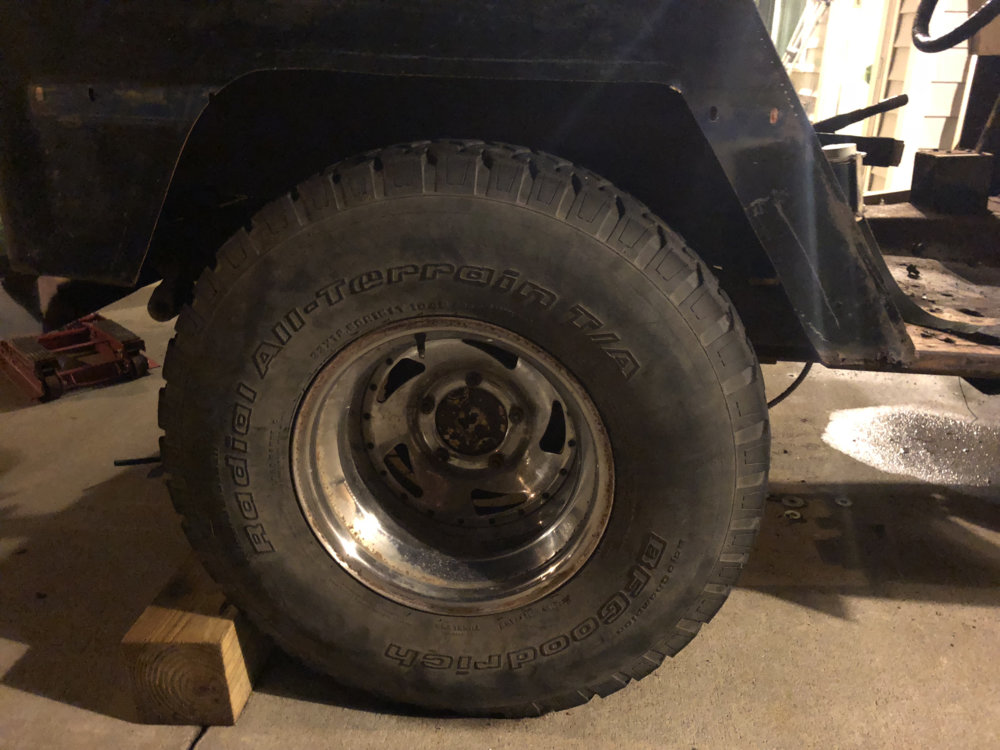

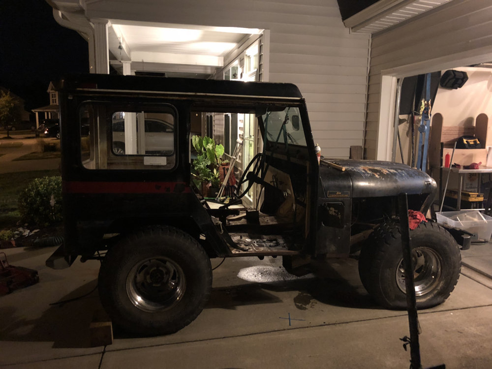

So, the sawzall worked its magic and removed a bit of excess sheet metal from around the rear tires. There will eventually have to be another cut and smooth everything out to wrap the edge with trim rubber but for now, I am clearing the tires and can't rock the vehicle into the tread. Someday, new springs will help this as well.
As you can see from the side view, my $100 wheel and tire package leaves a bit to be desired...
When I cut wheel wells, I cut the exhaust off with a short stump from the header. When I did... acorns and bullshit. It had a few holes which could have cheaply patched up but, I could hear something rattling around and had my suspicions. I'm glad I chopped that nonsense off. The instructions from the HEI advised gapping to .45-.50 so, after a quick lesson on gapping spark plugs, my supervisor learned to install new plugs, wires, and an HEI distributor. (HEI: United ignition wire 6516-3, plugs: NGK GR4GP, Wires: Taylor Cable 74249) We wired the new distributor to the old power wire for the coil.
I had her fill the radiator, and then taught her to change the oil and filter. She also thought it was a good idea to add a bottle of Marvel mystery oil to the mix.
While not coaching her majesty, I installed a Holley might mite fuel pump and replaced the rubber hoses to the carburetor, bypassing the old mechanical pump. I didn't get a good photo of that, I'll have to take one after I move the damn thing... the tank is out, soaking in evapo-rust. In the process, I also pulled out the filler tube. When I bolted the new might mite into place, I put it right in the way of the fill tube. If you're wondering, the C-channel frame at the back is too narrow to put it in there and there wasn't another good place to stick it at the time. While the tank is still soaking, I dropped the pickup hose for the mighty mite into a gallon gas jug and wired it up to a toggle on the dash so the fuel pump can be isolated. Eventually this beast will get a complete rewire but, for now, it's running off a switched ignition wire into a toggle and down to the pump.
With fuel and electricity flowing, it was time to try the beast at running. I have a video of the second start after adjusting the timing but, it won't upload. Suffice it to say, SHE RUNS! The vacuum advance doesn't work (meh, whatever.) so the only real issue is the carburetor seems to be leaking from the accelerator pump or the bowl. OR the damn mighty mite is over pressurizing the carb. I might try a pressure regulator... rebuild kits for the carter YF are incomplete, and a new carb is around $200, which I don't want to spend. You guys are rapidly talking me into a 4.3 swap which is why I went with an electric fuel pump in the first place!

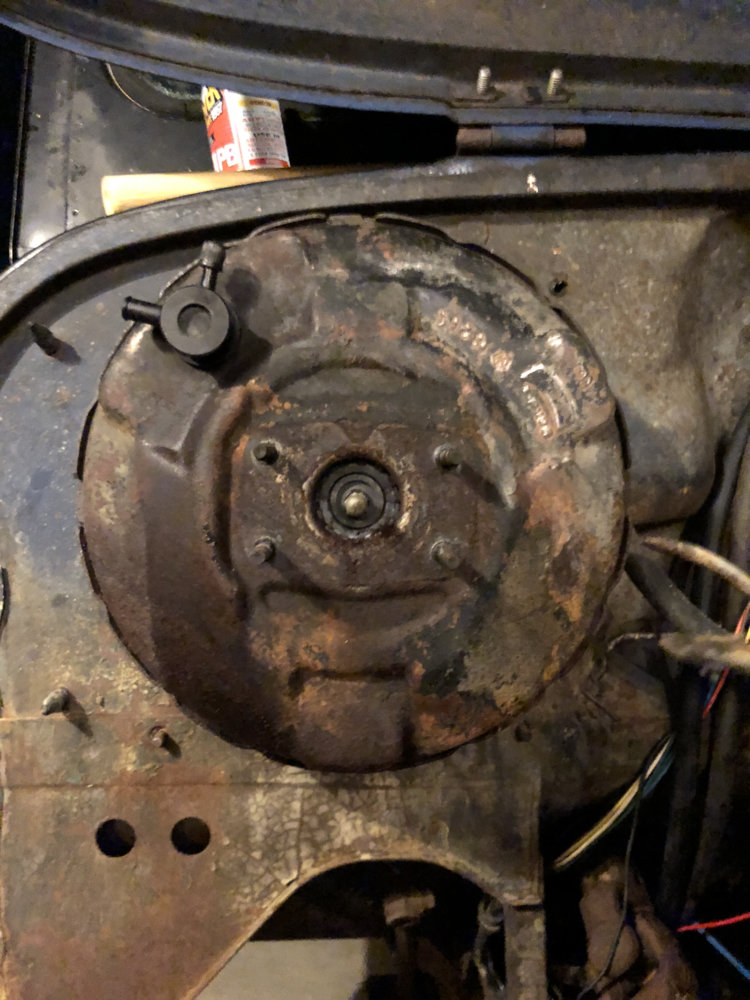

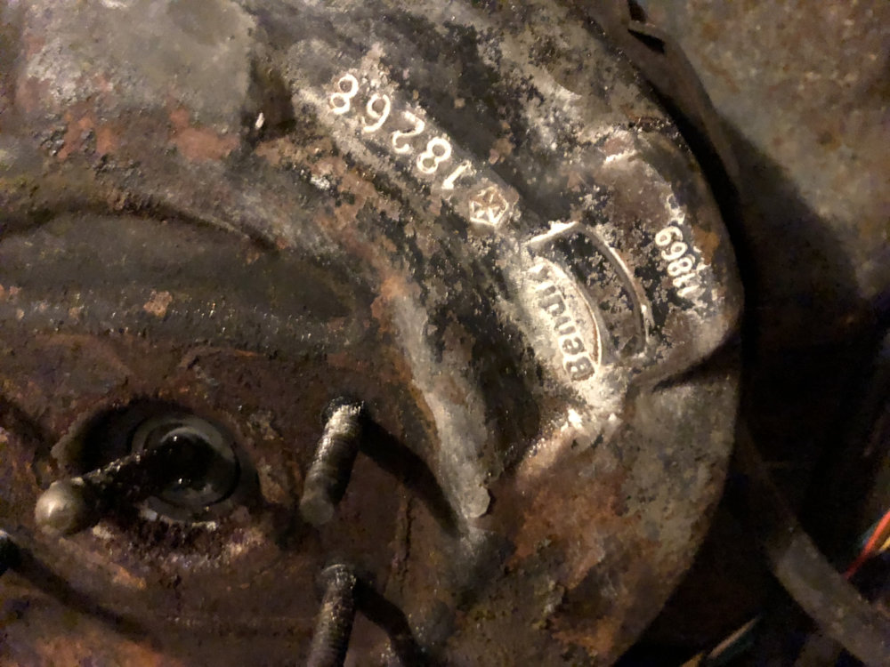

So, the brakes are complete garbage in the mail jeep. We started out this project by literally beating the brakes off this beast. Somewhere in its life, the master cylinder was abandoned in its place and a booster, master cylinder and linkage was bolted in. Unfortunately, I have no idea what it came out of. If I can figure that out, I can replace the completely locked up master cylinder... if you know what this came out of, I'd appreciate the insight. I've been looking at part number cross-references and various websites but cannot figure out what this shit came from...
Your googlefoo must be broken... '70s Cuda
bendix 18268 - Google Search
What do you think they're missing?
I saw the 70’s barracuda stuff too... Am I silly to think I’ll find one that looks exactly like it? So many of he stampings are different and the Plymouth forums discuss these boosters all having the same Chrysler numbers but markedly different brake boosters... supposedly the Hemi vs non-hemi cars had a different bolt spacing.
I’ll ru with it and see if the cuda master cylinders are the same and will bolt up.
If it IS from a barracuda, does that mean I can call it a ‘Cuda now?
