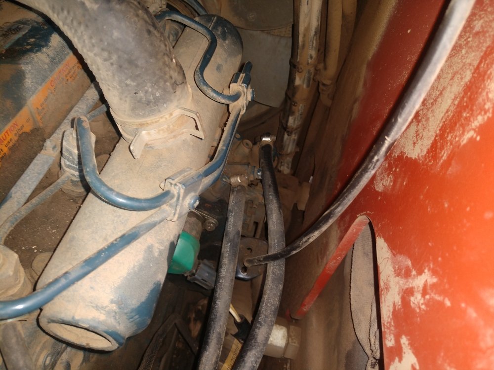

This is the best picture I can get of where the fuel lines go into the engine. The line on the right goes into a little contraption that has a lever on it for priming it. I can take the line loose and pump the lever and fuel comes out.

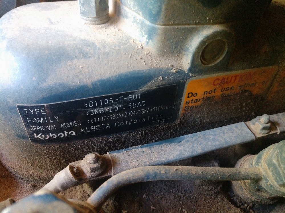

How old is the engine? Is it a tier3, tier4I, 4final? Also what family and hp rating.
Pic of the engine tag? I may be able to help.

yeah that looks like a little rotory injection pump will it try to hit at all if you use the hand primer to prime it up and then crank on it if so that could indicate a supply/lift pump issue
No it won't fire at all after I use the primer lever.

2012 should be tier 3. I'll look and see if I have an engine manual for a D1105. Let you know tomorrow morning.
You can also contact engine power source in charlotte. They are a kubota dealer, they supply all our engines.

In your picture, the green cover, with an electrical plug under it; is that the starter, or perhaps a fuel solenoid?
To start, do you have to move the throttle lever open, & then pull the lever all the way closed, to stop the engine? Or just turn a key, to start & stop?
That's the fuel shutoff solenoid.
Sent from my Moto Z (2) using Tapatalk
Is it an external mounted solenoid? If so just disconnect it electrically and mechanically and just move it to the run or off position by hand or could even verify it is going to run position when when it won't start.
Yea it's just got 2 wires connected to it. Will it shut off if it starts without it connected? My concern is having a run away engine.
