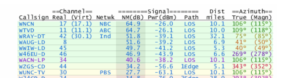

Antennaweb.org will tell you what you should be able to receive, direction/distance to towers, etc. Mine is not on a rotator -- I just pointed it in the general direction of the majority of towers. Do pretty good off the backside, too, get a Myrtle Beach station (tower is in Dillon, SC).

Like me you're pretty much line of sight to the towers on Hwy 70, aim in that general direction and you'll get most. I have an antenna sitting on bedroom floor leaning against the wall, picks up quite a few, then the cat decides to sit in front of it....

Being 10 miles from them definitely helps. I'm sure if I didn't have it on the opposite side of the house I could get more channels.

If the leaf antenna dropped channels 5-50 when it rained, then they suck. You should be able to pick up any of the networks from your house with a 6ft long piece of bare copper wire. Channel 4 out of Chapel Hill is a bit more challenging. That's the only reason I have an amp and a rotator.

with no leaves on the trees i can see the tower strobes from my house, don't get more line of sight then that, you'd probably be the same save for the trees, though i suspect your elevation is just little lower as well. The rolling JoCo prarie
Just learned something. Thank you!
I have this one just sitting on top of an armoire in our house.. Does everything I need it to except for Channel 4 out of Chapel Hill
I can pick up PBS out of the Greenville relay better than I can get it from Chapel Hill. Channel 25 over the air.
