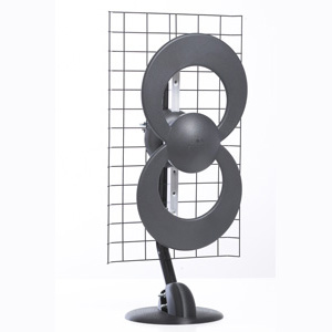

I have this one just sitting on top of an armoire in our house.. Does everything I need it to except for Channel 4 out of Chapel Hill
i've got the same one doing same thing
If the leaf antenna dropped channels 5-50 when it rained, then they suck. You should be able to pick up any of the networks from your house with a 6ft long piece of bare copper wire. Channel 4 out of Chapel Hill is a bit more challenging. That's the only reason I have an amp and a rotator.

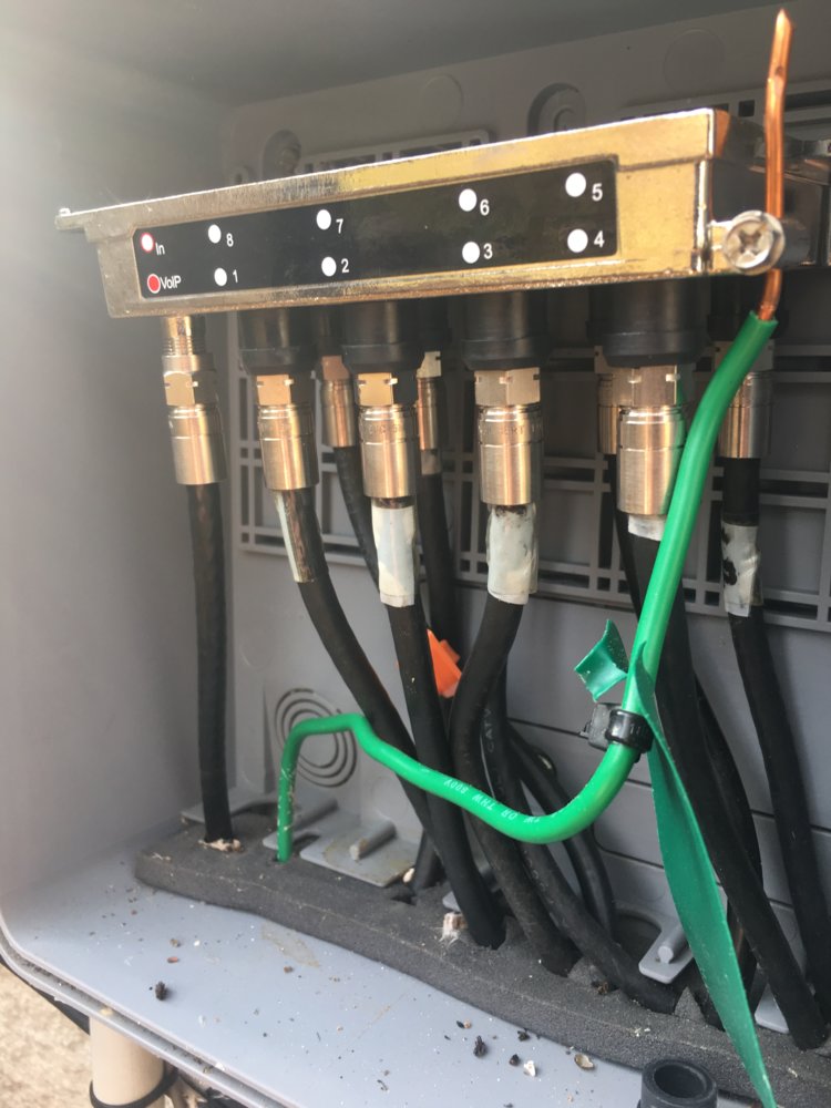

The cable all the way on the left should be the one from the cable company. Unplug that one and plug in your antenna.
Of course, this assumes that you don't have a cable modem (internet) or VOIP phone or anything that you're intending to keep running.

And there lies an issue, should’ve specified. I do have a modem for the net and when I plugged it in there pre posting this I lost the connection. Soooooo.....
Oh, in that case, you're gonna have to figure out which of those other seven wires goes to the modem. Leave that one connected to the one that comes in from the street, then hook the others to your antenna wire with a splitter.
Technically you can use the same wire as a middle bus for both the internet signal and your TV antenna, they use different carrier frequencies. However to keep them well separated you may need to use a modulator splitter on both ends.

that said - if you just have the one modem, it's going to be easier to just find the line going to the modem, and disconnect it from from that block and direct-connect it to the line coming in from the cable company (as Shawn said, probably the far left), so those 2 are now independent of the block. Then connect your antenna line coming into that spot on the far left instead. that will give you antenna access in any room.
