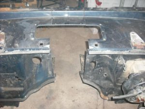

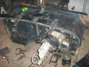

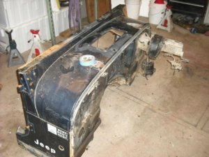

Cut tub in half 18" behind the firewall :)
Tomorrow I hope to cut the center piece out to narrow the width.
I'll narrow the rear section later. I chopped it there it will make it more manageable to move the pieces around.

before.....
during
after..
will redo the tunnel area, just tacked it up for now until I get more stuff in place.

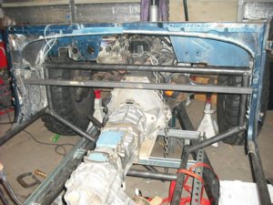

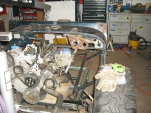

Changed the base chassis design around some.. This is actually my 2nd pass at this. I had the cowl at a few different heights before I settled on this position. I switched to round as I just wasn't able to fit things as I needed them to be with the square tube. Up front I'll need the flexibility of bending the round tube.

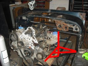

Just the main belly section roughed in for now. Working on the cowl section. Not much to see or look at but FINALLY got some of my major dimensions and component placement sorted out..

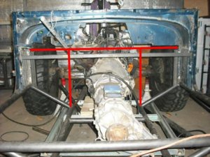

A few angles. The red line is where the cross piece will run. That bar is in the same plane as the firewall and will also hold/brace the brakes, steering as well as be a support to other items inside and out.

Anyway... some pics..
Yes i have that PBB build bookmarked. Though not the same seeing any 'narrowed' tub helped me decided how much to chop.. He cut like 10-12" i went for 8"
I revised the cowl tube work some, slightly adjusted how the cowl will sit on the tub work. But I'm much happier with this and how everythign else will start to tie in..

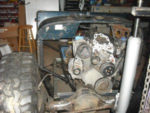

Motor mounts and brake pedals will be here today.. I need to take a break from the garage for a day... Have house stuff to catch up on..
Some pics... Red stuff is whats coming next...
