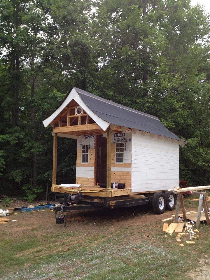

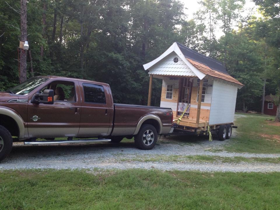

this playhouse was 13’-4 to the leak and a hair over 8’ wide. Hauled it 3 hours no problems.
the shed I moved had 2 4x4,s going front to back, I bolted another between them to put a strap around and some old leaf springs as sliders under the front and it hand cranked right up on my trailer with a come-a-long.
