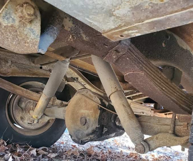

Also, can anyone identify this rear end for me?
Definitely looks like a dana, and the frame and suspension is screaming first gen Ram to me, so I'd say either a 60 or a 70.
Duane
That's definitely a first gen Dodge. I just hope it's a full floating axle.
It is if it's factory. The only semi float 8 lug they used was the Chrysler 9.25, and its cover looks like a stop sign.
Duane
Duane
My first thought was a Chrysler because of the plug. I'm guessing it's a half ton variant. Been awhile but I know more than one assumed they had a 60 and it be that 9.25.

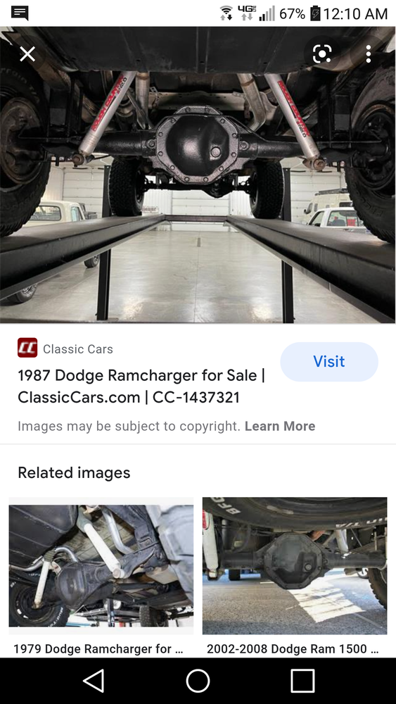

Here's a good shot of one. Shock mounts and all.
I saw the plug too, but from the angle of the pic it looks like a Dana cover.
