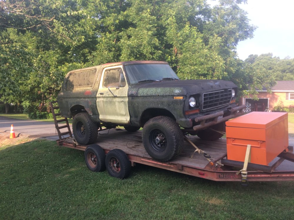

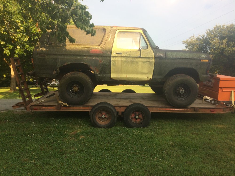

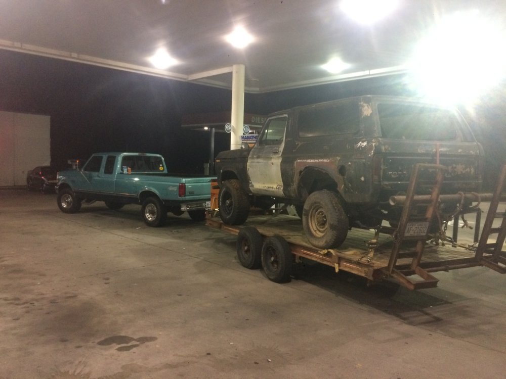

So I picked up another project last night... can't decide what do with it.
1978 Bronco body (sheet metal behind cab is rough)
Sitting on shortened 1979 F350 frame.
Kingpin 60 front
60 rear
T18
np205
460 (hasn't ran in 5 years)
Not sure whether I want to think about tons, whole drivetrain swap or what... or just build the bronco?
Got it for a steal and don't know what to do with it.
Sell your current axles, tires and rims. Put the 60 front in the YJ, sell everything else, buy a 14 bolt and some 8 lug rims and 40's.
Sucks that I got rid of a set of 8 lug H1's less than a year ago...
I have also beat on my jeep pretty hard and it has taken it so far.
I am really tempted to sell the YJ and do a 203 doubler, chromo's up front, 14 bolt, and 460 on propane with 42's... with the low 1st gear in the t18, the 460 and doubler I should be fine with the stock gears welded until I can upgrade them?
Edit: I may end up getting this thing running, taking it to some truck pulls, then part it out (keeping what I want to for my next project.)
I really want to build a stretched YJ truggy.
Make a cab and bed for it, linked, tons, 40+ tires with some sort of powerful motor.
I think we all have the problem of seeing potential in everything we come across. "oh, that would look cool on tons with this and that etc..."
It is hard to decide on one thing and just stick with it for a lot of people. Especially me.
You sure that doesn't have an NP435? Oh, and sell me the tons:smokin:
It's got Borg Warner cast in the side of it.
I kinda like the sound of tons... but if I get rid of them, I'll let you know
You know, I didn't realize they used T18's. But, I guess they did.
This is all new to me. This is my first real venture away from Jeep running gear.
I could use some advice on what I should do to get the old 460 going though. I've read a lot online, but there are a few opinions on what to do when a motor has sat for that long.
I wouldn't mind the 205...just saying haha.
What is a 205 worth?
I can't verify its condition yet, but owner said it worked and it does shift in and out

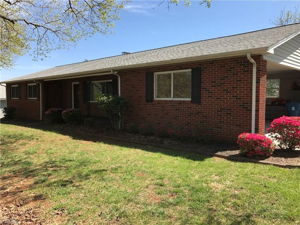

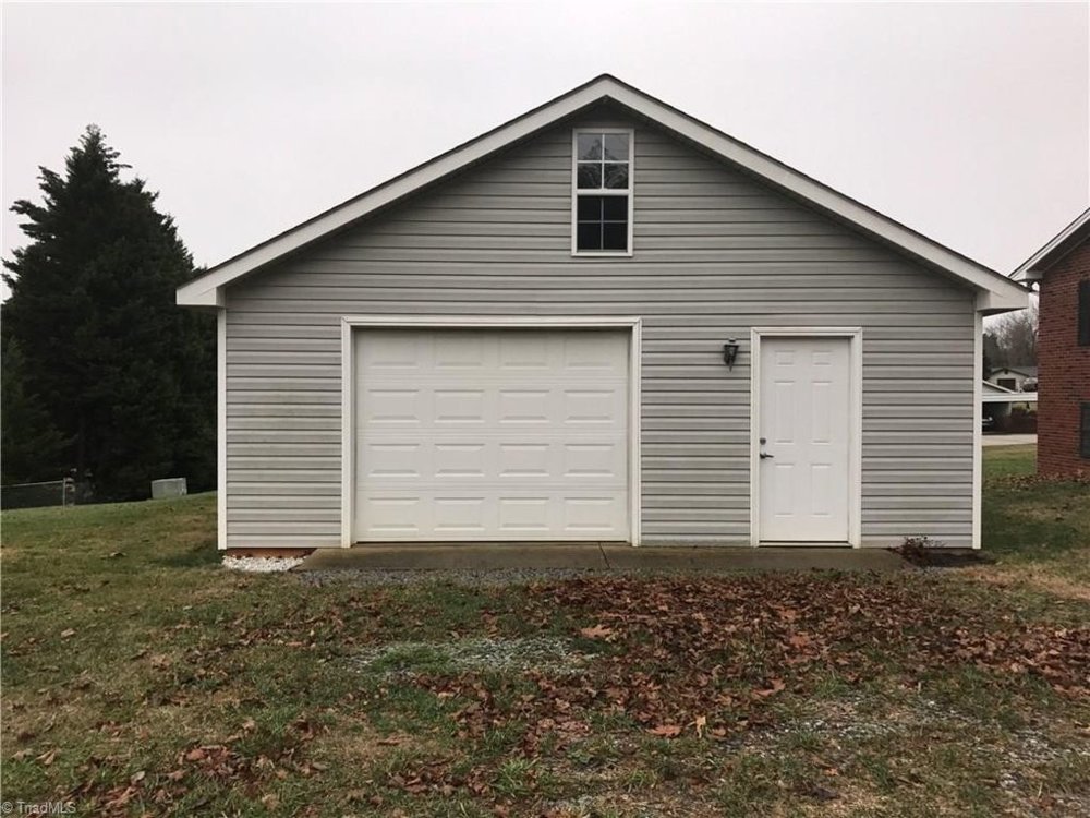

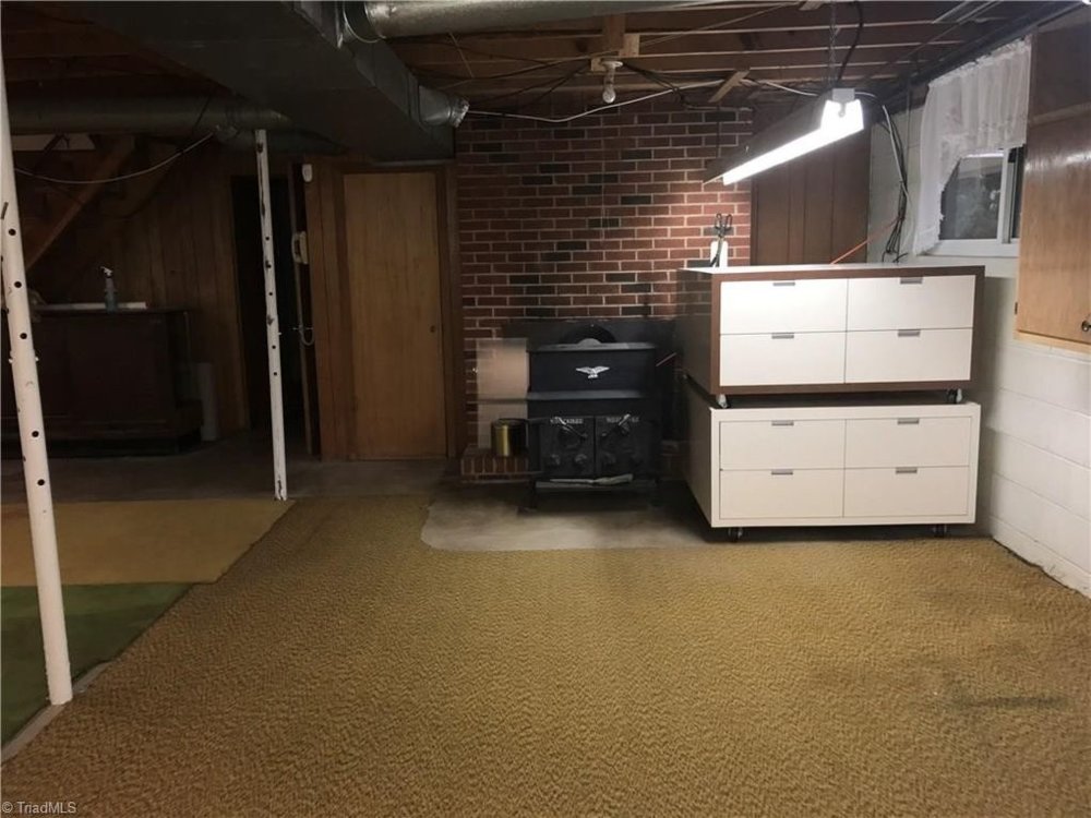

I sold my 7.3 a couple weeks ago to put a little more money in the bank so I could buy a house.

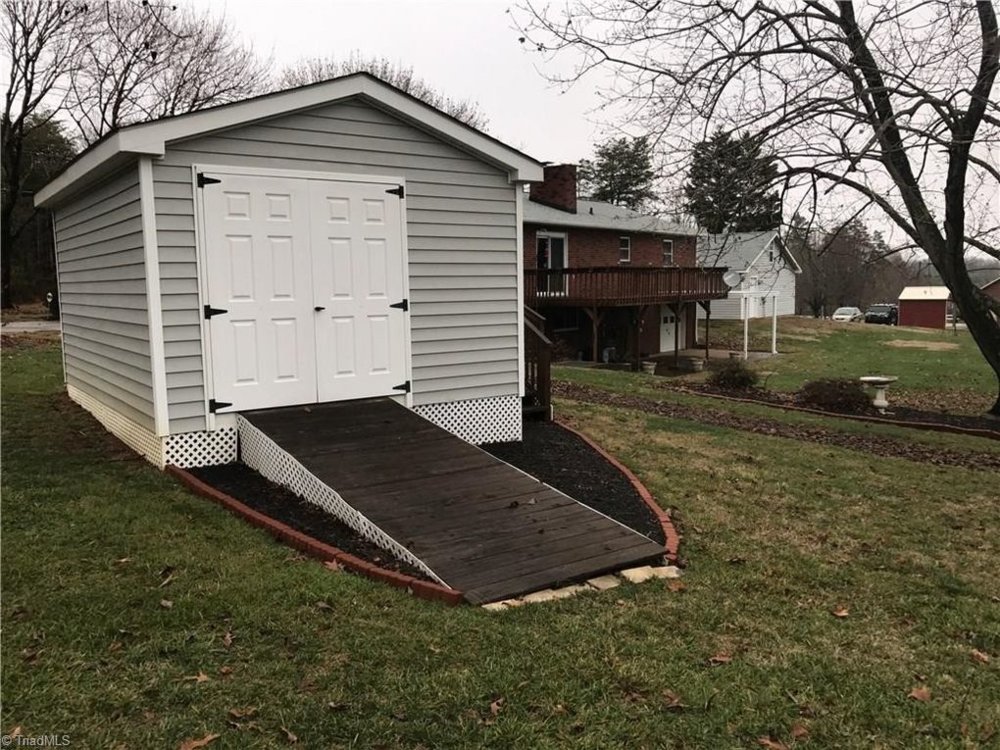

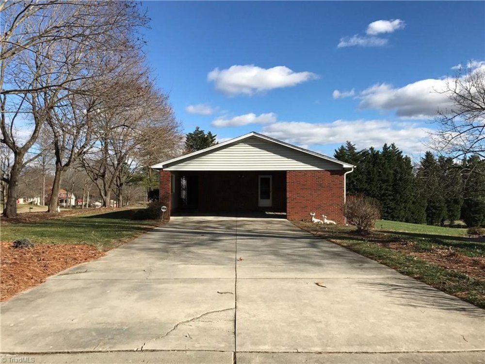

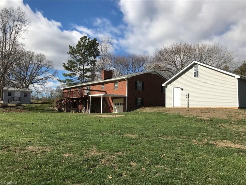

Bank finally came through last week, so I'm officially a homeowner.
It's got a detached, conditioned garage and a full basement with a roll up door and wood shop in it as well.
I'll finally have a place to work in any weather.

That's a nice house and shop! Plus a shed!
House is stuck in the 60's/70's but I've got til April to fix it up.
That's when the fiancé moves in after the wedding. :eek:

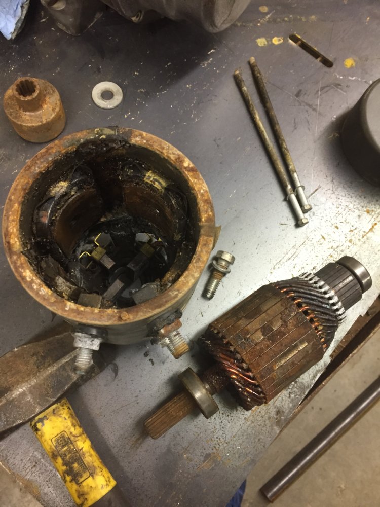

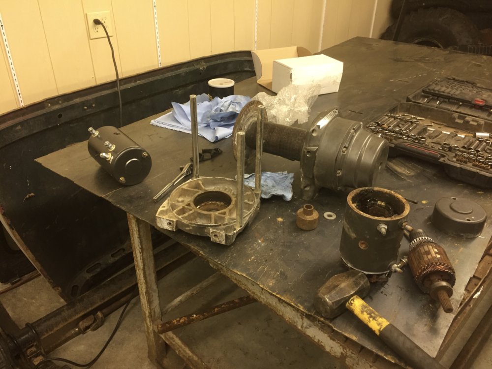

I figured out why my winch motor burned up on my last ride.
It was winching in reverse so the brake didn't engage when it stopped. Put a new motor on it and flipped it around. Works great now.

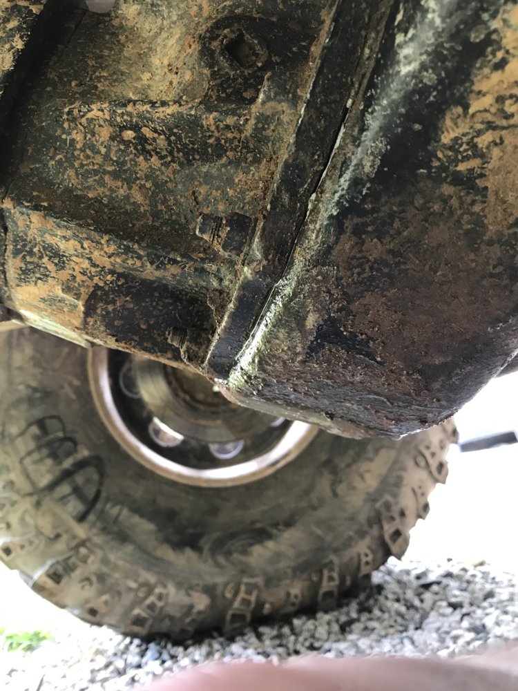

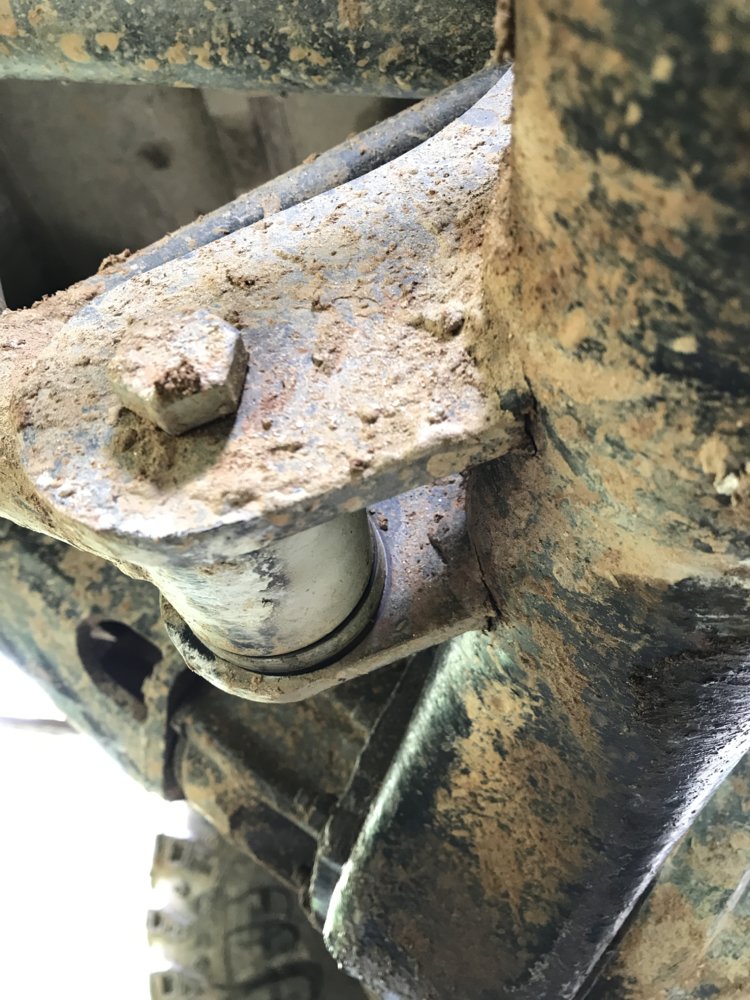

I thought I had made it through the whole weekend without breaking anything...

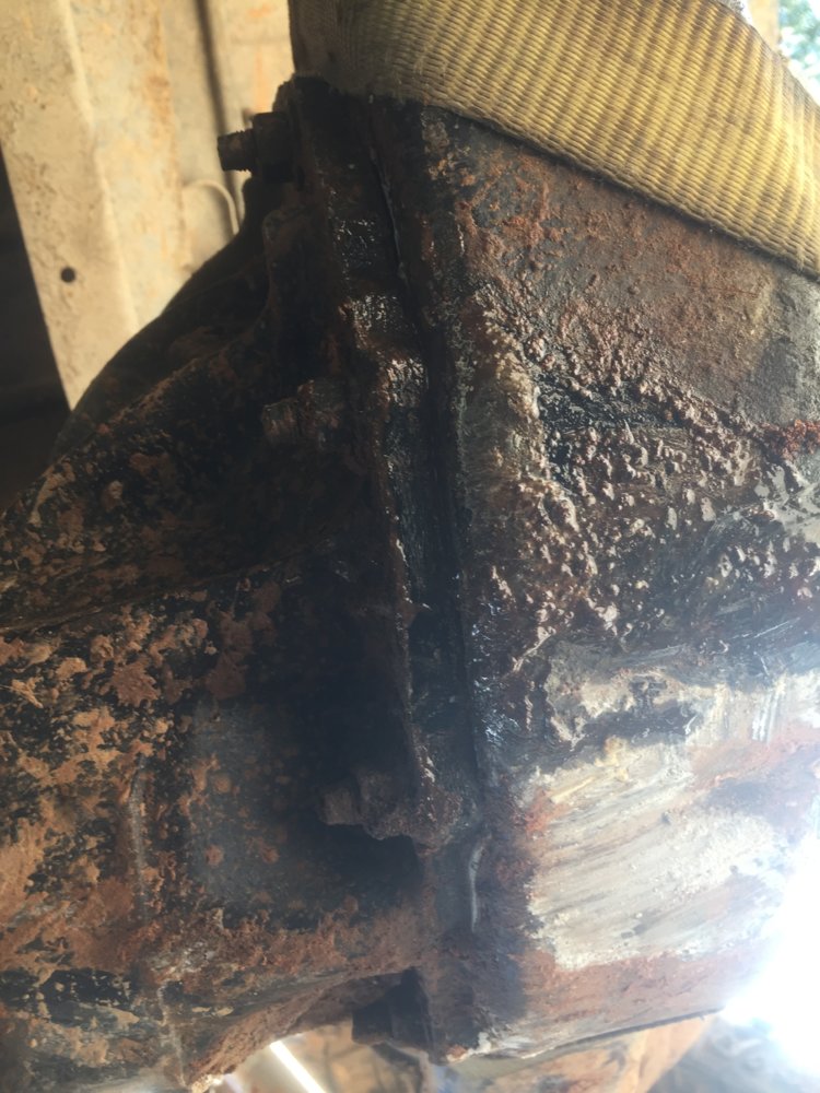

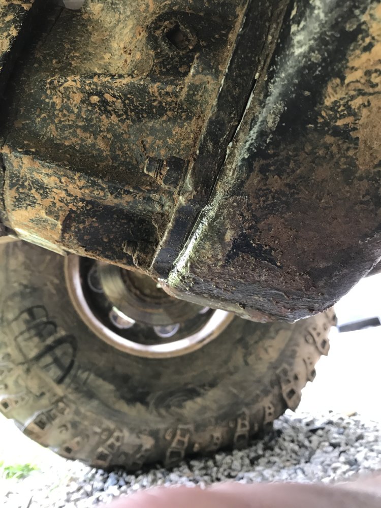

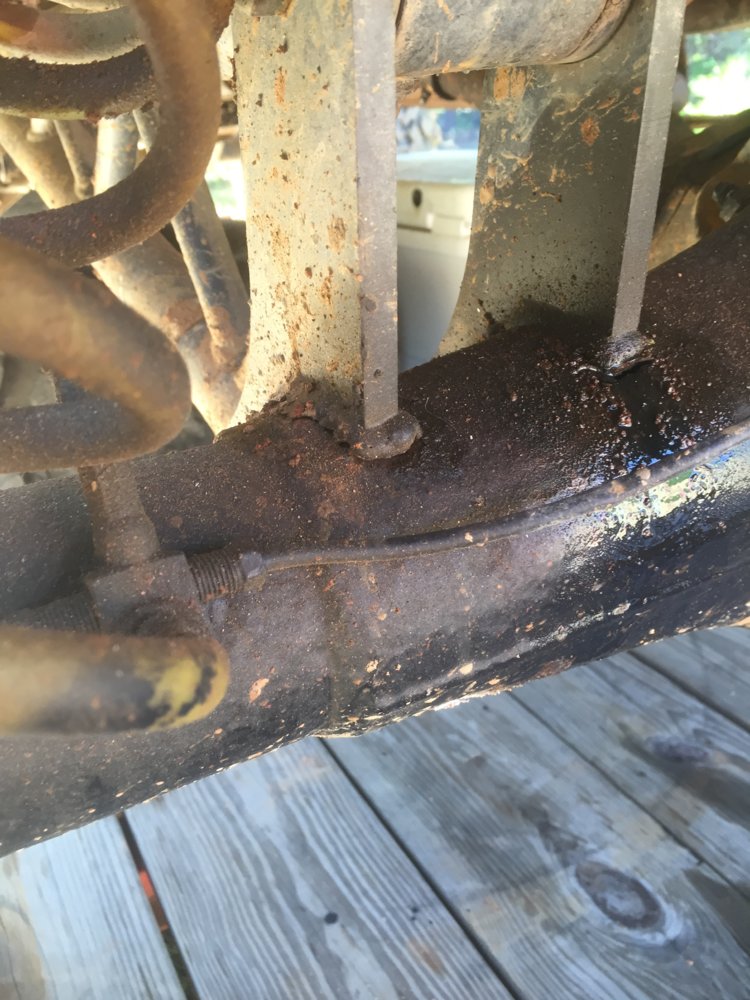

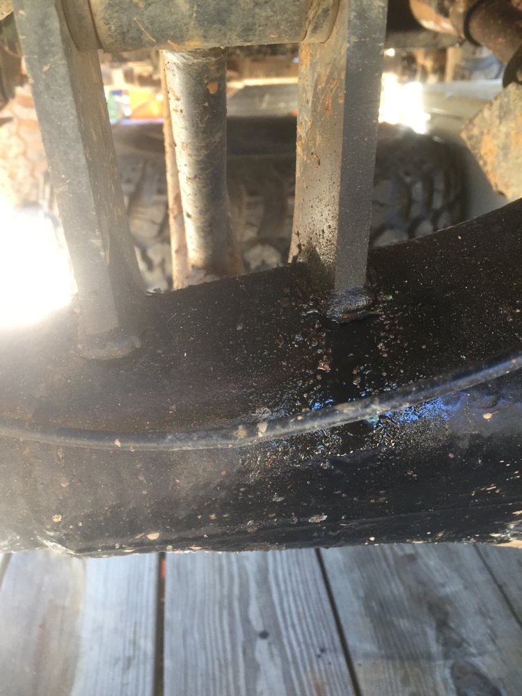

Once I loaded the Jeep up to head home, I noticed a nice oil stain on my 9 inch housing.

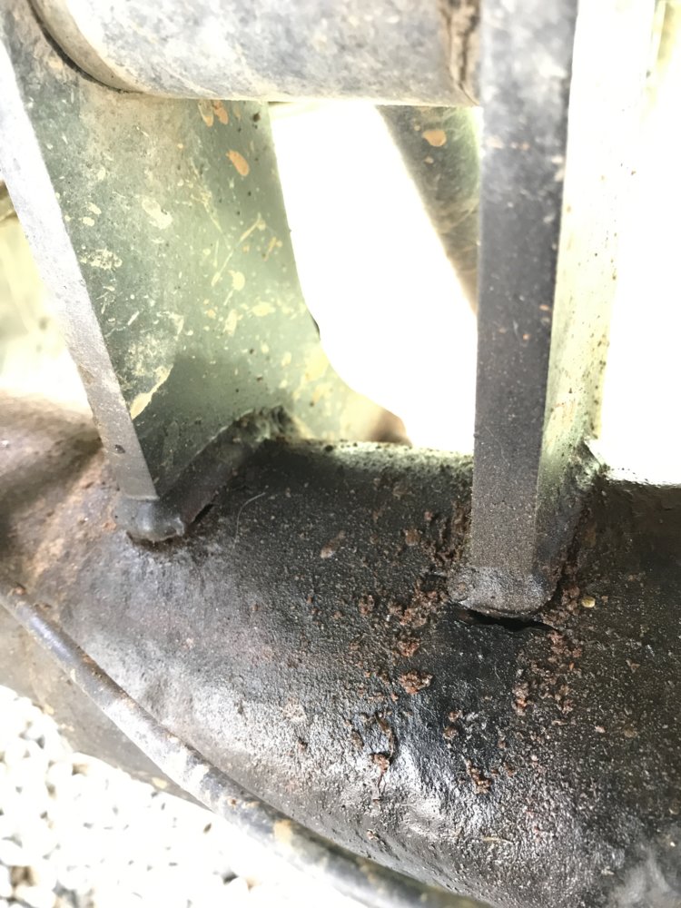

My antiwrap bar mount is tearing out of my axle housing. Welds held, but the housing is pretty screwed.
It also got hella dented up from dragging it over rocks. It is leaking pretty bad where the 3rd bolts in.
I think it is time for a new housing with some more beef added to it.

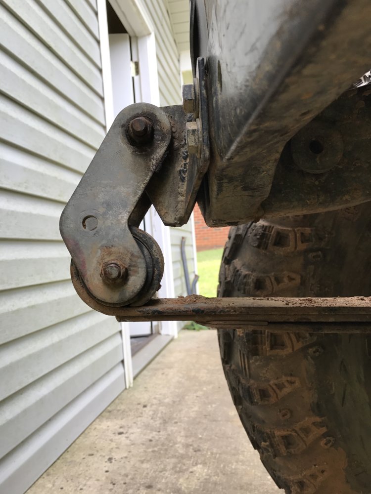

I also will be needing some more leaf springs soon. These are getting beat up pretty bad.

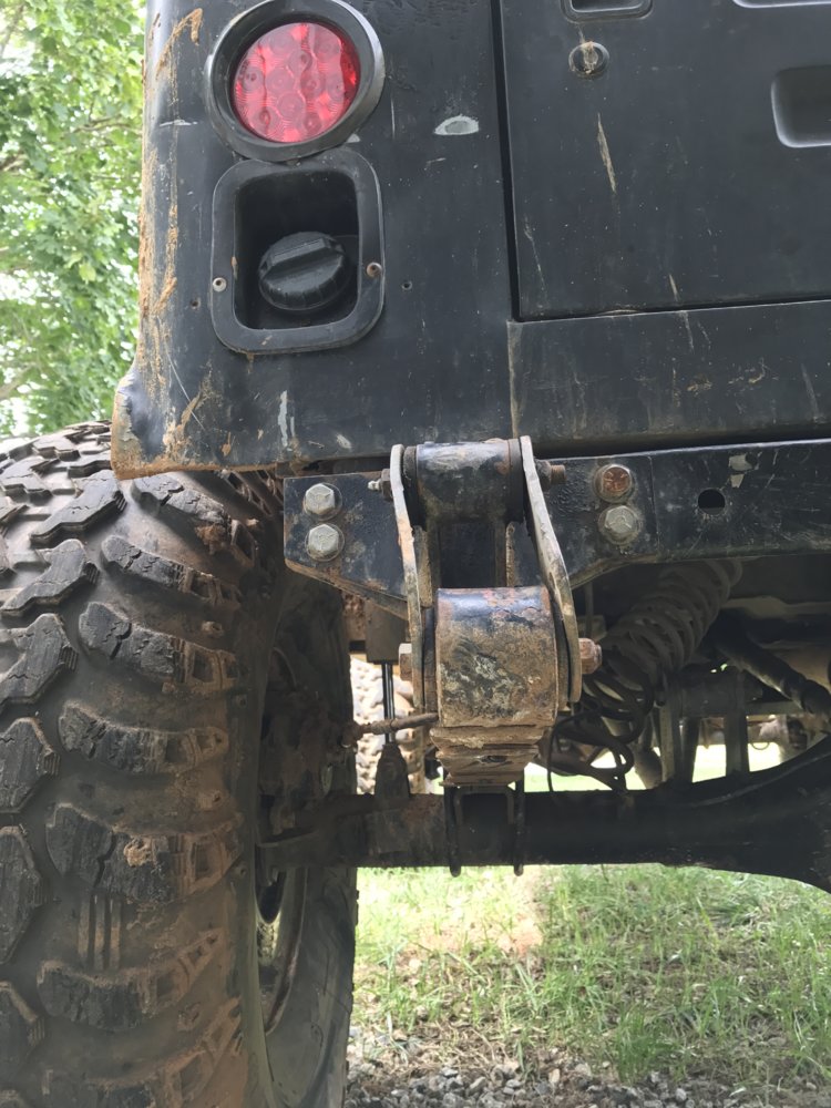

Also going to address my rear spring hangers. They have always been an issue.

The welds breaking and pulling out of the housing are really bothering me. Any plans for the new housing yet?
I think I have one lined up. Just trying to work a trade so I don't have to spend any money.
Your welds did not break. They just ripped the housing. It was pretty rusty
