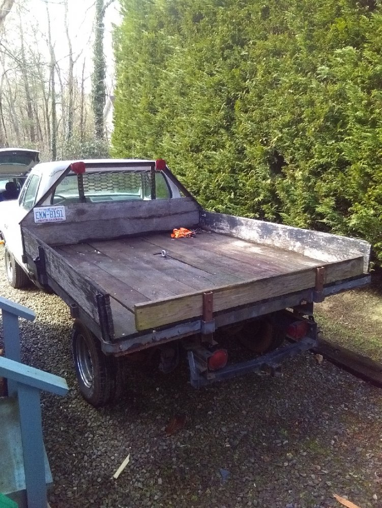

Just got this a week or two ago, haven't done a thing but look at it, run it, and make plans. I work in some pretty remote mountain areas, odd labor jobs, firewood, etc. Looking to build a utility vehicle that can get up some rutted old logging roads and still look halfway decent around town. Daily driver is an '05 Subaru with 300k which does far, far better than any car I've ever owned. But it doesn't haul much... Anyway, here's what I'm starting with.

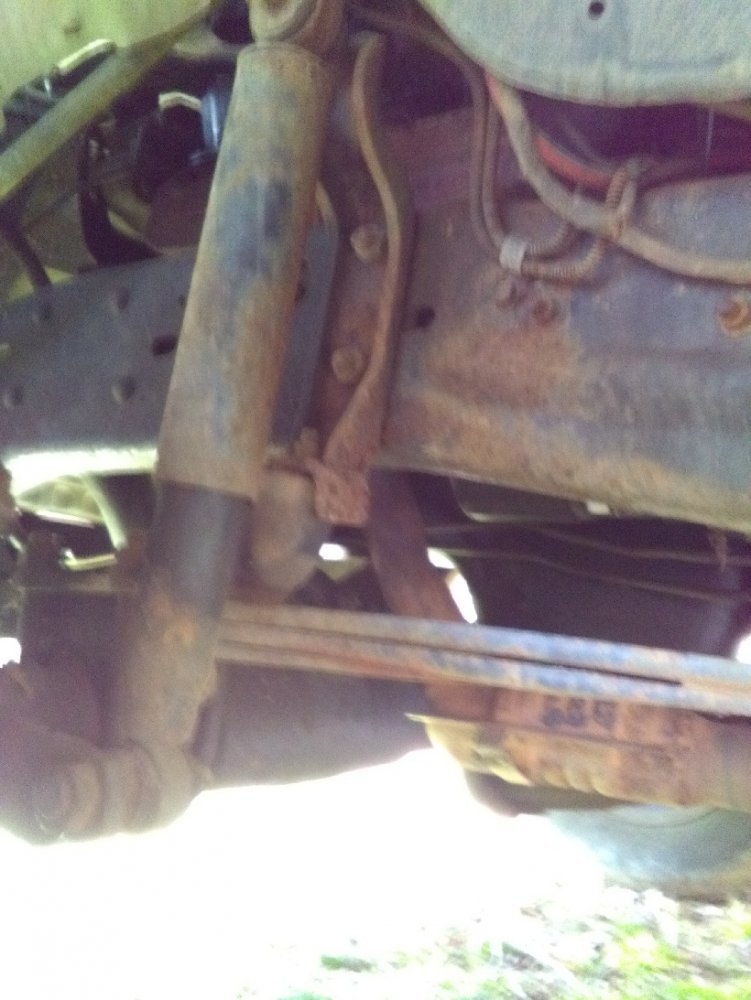

This is how close I am to the bumpstops when sitting almost flat (both pics truck is in the same spot, spring is driver's side front).
Anyone here ever use leaf springs from Rock Auto? Considering getting some replacements there.

In case you couldn't tell from the rock auto pics, there wasn't much arch in the springs when new. If you're planning on bigger than 33's without cutting the fenders I'd go ahead and plan for a lift. But for stock replacements I've used sdtrucksprings.com before.

Heard that, I was hoping that the heavier weight springs (there are two classes showing for w150) would give me some lift... looking for 2” or so over stock, enough that I can fit 33x12.5. Got plenty of things to work on without messing with driveshaft angles and steering clearance just yet:laughing:, from research so far it seems like 4” is where it starts to get complicated, but all the lift springs I can find are 4” or higher. I’d add leaves to the existing springs but not sure it’d help much without any arch..

Looks like the Dodges are 24x24 and the Chevy are 23.5x23.5 both are 2.5. Also there are two options for the dodhe fronts, 1400 and 1900 lbs. Judging by your pictures you have the 1400 (3 vs 6 leaves)
Righto, so if I get new stock 1900lb leaves, that should give a pretty good height boost yeah?
I've heard from several people that Chevy front springs will work, and like @Monkeynono said they are only a half in shorter on paper. I have seen some specs say they are 2.5 wide and some say they are 2.75 wide though. Personally I've never tried it. I have always cleared 33x12.50s on all of my stock trucks, occasionally one would rub the fenders if the wheel offset was farther out. Skyjacker does make a ~2in lift spring for the front, or you could also get a set of zero rates for 1in lift. For the factory 6 vs 3 leaf pack the 6 leaf is thicker, but has a little less arch, so you will end up with some lift but not a lot. Anything would be noticeable though since your springs have a negative arch in them now lol.
