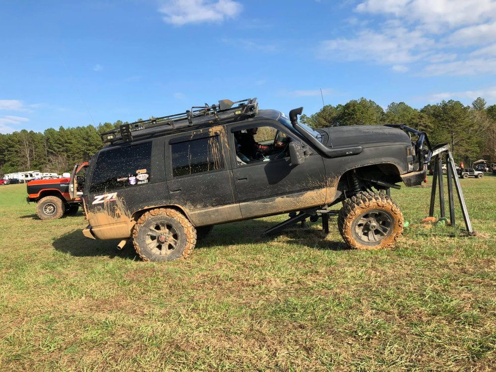

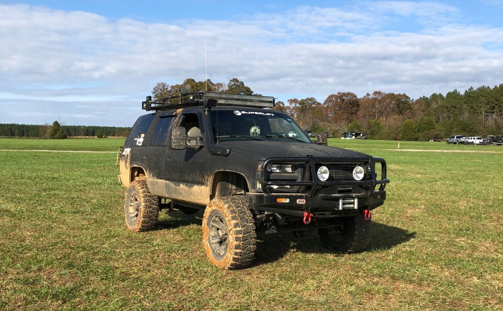

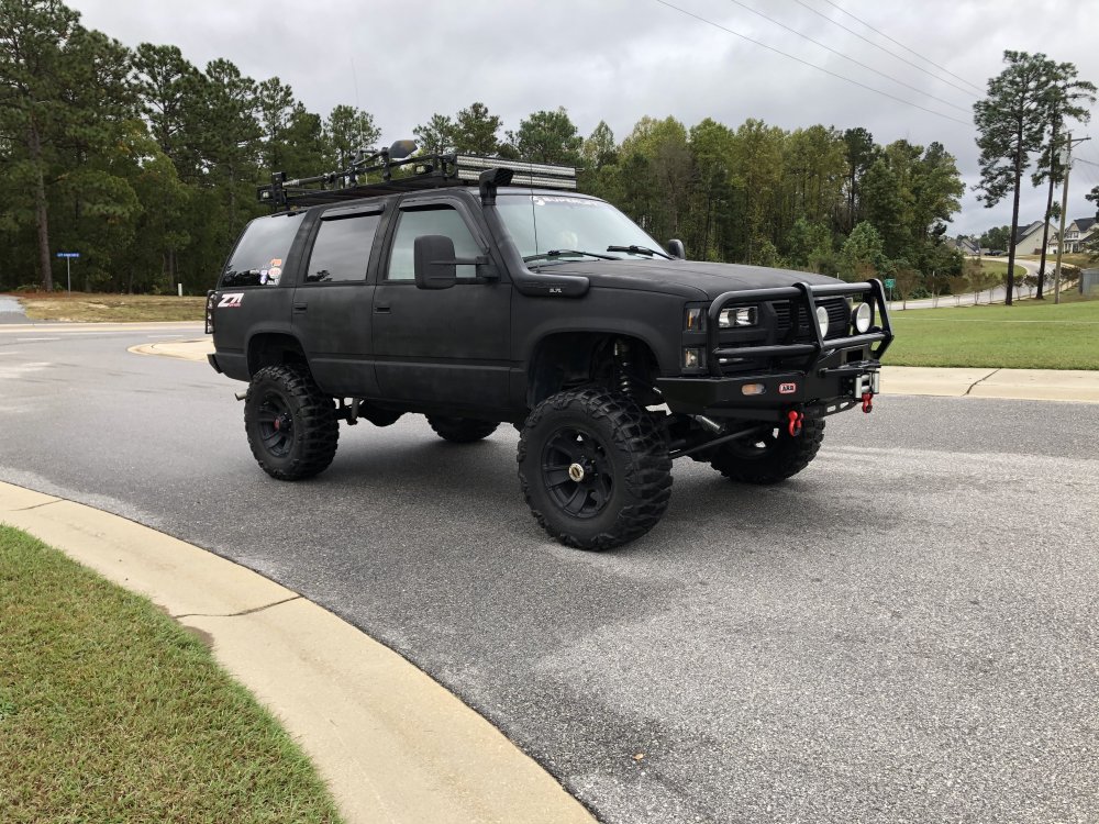

Figured Id add to the mix here and show what Ive been essentially piddling on for the last 10 years since owning this truck. Its a 1998 GMC Yukon with a 5.7 liter vortec V8. Current Mod list and most current photo below so far . I really need to get this thing out more this year only had it out twice last year.
I call it Project Re-Kon
- SAS Dana 60 KP Yukon 4;56 gears and a Yukon grizzly locker , Warn Lock outs ARB diff cover and .... 6 Lug hubs ( More on that later
- Rear is a 14 Bolt S/F rebuilt hub to hub with Yukon 4;56 gears and a Detroit No-spin locker and a Blue torch Fab Diff cover.
- 3 Link front suspension with Fox 2.5 Coil Overs
- Rear suspension is essentially Stock with 4 inch lift blocks and a AAL.
- Np241 swap with JB custom Fab shifter. TCCM delete.
- Re-located axle breathers above door handle level.
- Black Bear Performance Tune
- Pacesetter headers , High flow cats and a magna flow Exhaust
- aftermarket headlights and tailights
- westin tail light covers
- ( can't remember the name of the Company will add later) Rear bumper
- ARB front bumper
- Warn Evo 12k Winch
- ARB Snorkel from a Land cruiser Part number SSH60 ( yes its functional) get asked that and the part number all the time for some reason.
- Custom built Roof rack. with two 50 inch light bars . Over kill to say the least.
- Limb risers... not currently attached.
- Custom built Center console
- Wheels are 18 Inch KMC revolvers
- 35x12.50 Nitto mud grapplers . second set.
Ill update this as I remember stuff.
Got parts/ Plans for :
-Rear Tire carrier.
- Exo Cage
- 4l80E swap (no trans but harness)
- Rock Sliders
- Eventually either link the rear or buy some rear springs and ditch the blocks.
- Remove the 9 year old plasti-dip and Wrap it or paint it.
Thats it for now but I will update this in the months to come
