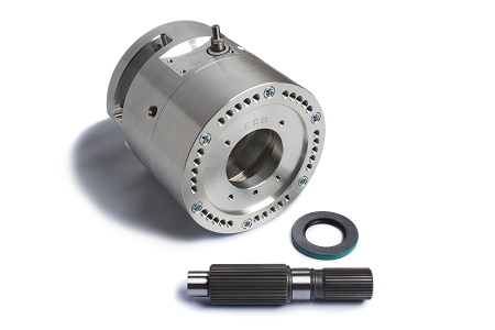

Personally I wouldn't do a d300. They aren't bad, but don't like to hold up to alot of beating, unless you dump a ton into it.
If you go 5.13/5.38 in your axles, you won't need a deep gears in the case.
The Ford 203 should bolt up to your trans. I believe the doubler you choose will dictate which 205 you need.
There are also 241/205 doublers, or used to be. You can also do a 1356/205 doubler cheap if you have the length.
I have the 203/205 dodge ford version. I'd go NWF Black box 205 personally. It's what I will eventually do. I know of a few guys that ran a D300. Every one of them broke stuff and ended up dumping more mony into them. One friend broke his D300 behind a 4.0 3 times.....
I will be 116/117" wheelbase max so I'll have the length but NWF isn't done with their kit for the 1356 doubler yet.. or are you talking about making one.
And scrap the D300, that's out the window since 2 of you already dogged it on top of other reviews.
That's a little too pricey since I'm going fox air shocks front and rear and everything else will be "fancier " stuff so I have a total budget in mind including bumping the 5.0 from 222hp to roughly 285-300hp
Someone has couple GM np203s in the for sale ad on here for $100...you guys know if those are 31 spline input for my ford transmission
Get an Atlas and be done, lighter and stronger and easier to service. But I know you will say it costs too much.
Second option would be black box to 205 like mentioned.
Stop being a cheap ass and put together a good combination.

When I ran the 37ā€ sticky Treps I did wish I had 4:1 cause I had so much traction the slower control would have been nice. But itā€™s a toss up, so both options are perfect. Iā€™d go with the Black Box
NWF Ecobox + 205
1:1
1.96:1
2.72:1
5.33:1
To actually beat on a 300, you are going to be in it for $1300-$1700 depending on what you pay for the case and how many bearings you replace. Thatā€™s for 4:1s, HD outputs f/r and rebuilding it plus whatever shifter setup and mounts.
Then you still run the risk of splitting the case and have it pop out of gear on deceleration in low range.
231 suck bc of the chain and splitting the case in half when you climb the chain under high load and high torque.
203/205 is practically bulletproof but also weighs a ton.
241/205 is probably best option bc of the ratio splits, saves weight, and relatively minimal upfront cost compared to other options.
All of the doubler options are pretty long and can make the rear d/s short and the front super long, when you push the engine back for front diff clearance and better weight distribution. Often requires a carrier bearing on the front shaft for skid and bell housing clearance.
Atlas is obviously THE solution as they donā€™t lose their value and it will generally outlast everything else around it. Only $500-$1000 more than a built d300
