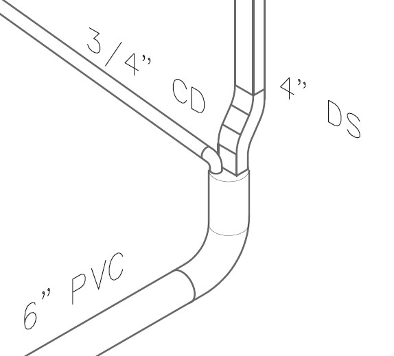

I'd have to SEE it...but from the sounds of it.....I'd run 6" PVC below grade at a 1/8" slope as far as I could go and dump out exposed away from the house.
I'd place some rip/rap around where the pipe dumps to control errosion, but where the 6" gets close to the house, get a long sweep 90, and rise up to about 4" above finish grade, and run the AC and downspout to it and drain indirectly (in case of a stoped up line) into the 6" line
The foundation drain shouldn't be producing the MUCK....but the AC drain will. It's best to get it as far away as possible.
