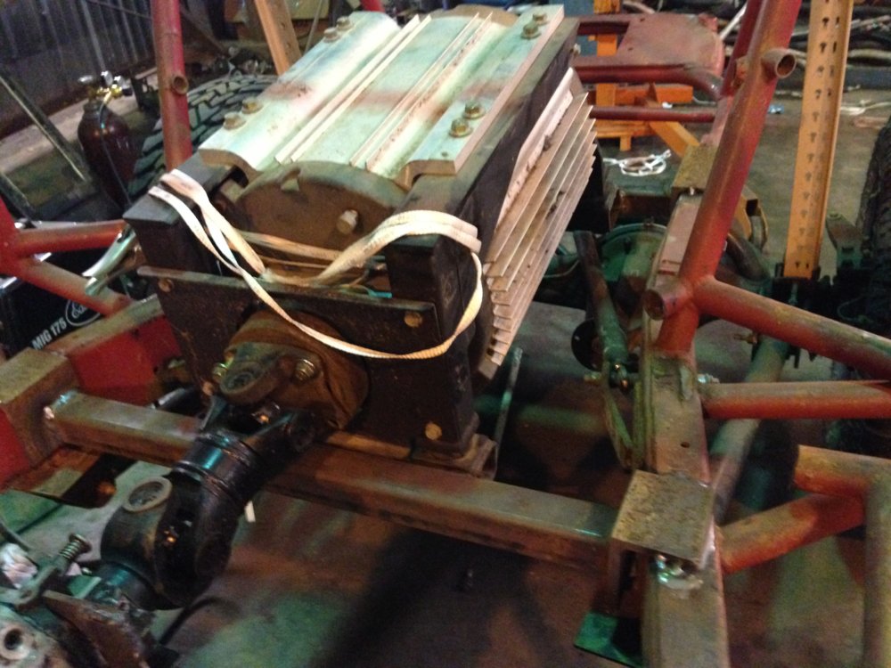

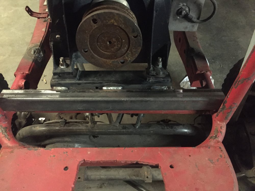

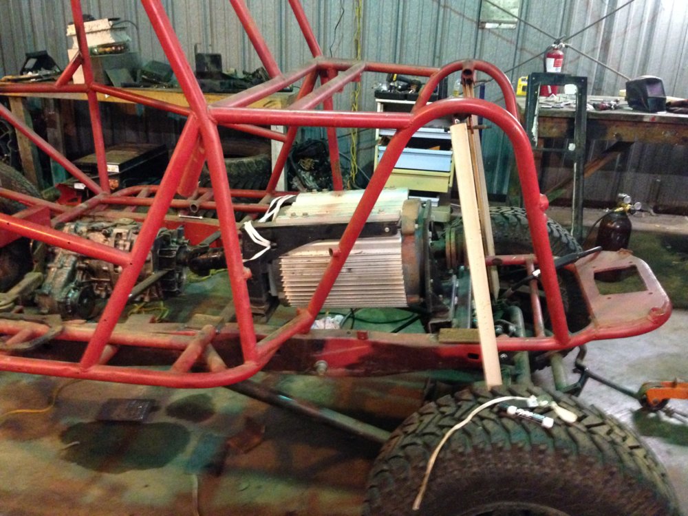

Well getting things done slowly but getting there. Got both front and rear motor mounts welded up need to center the motor and get the mounts In their final location

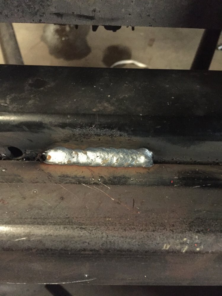

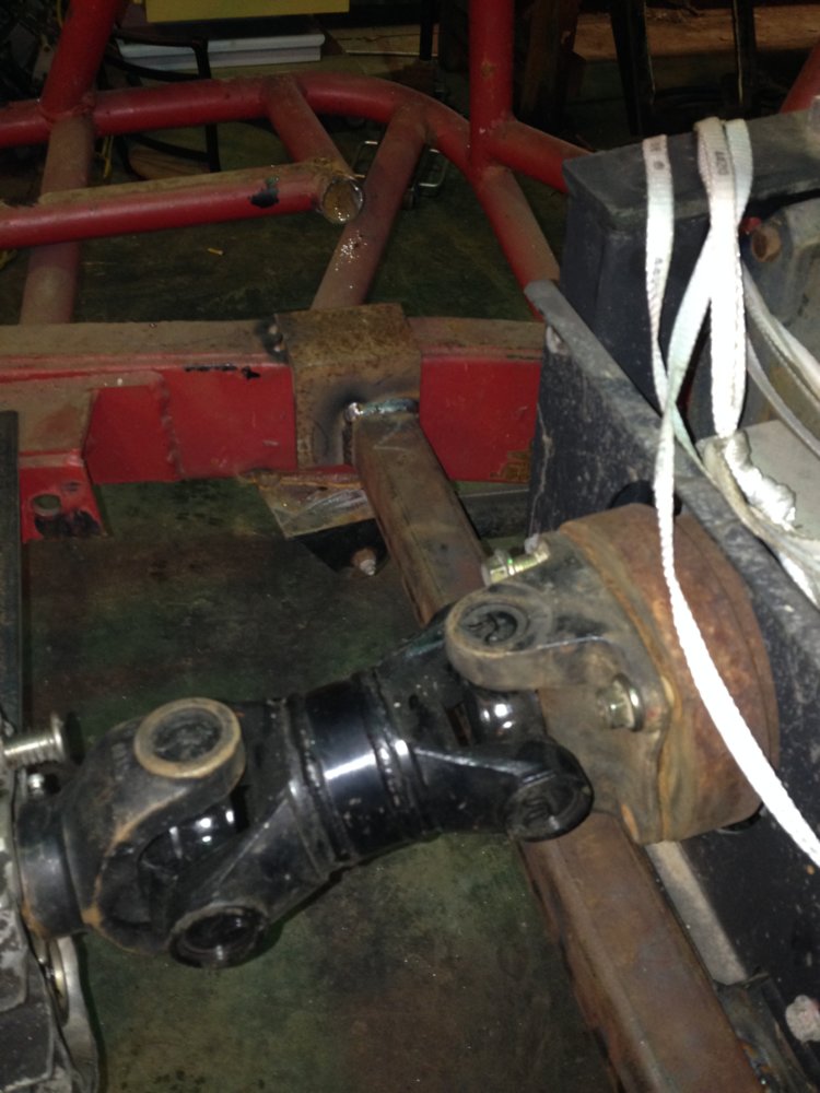

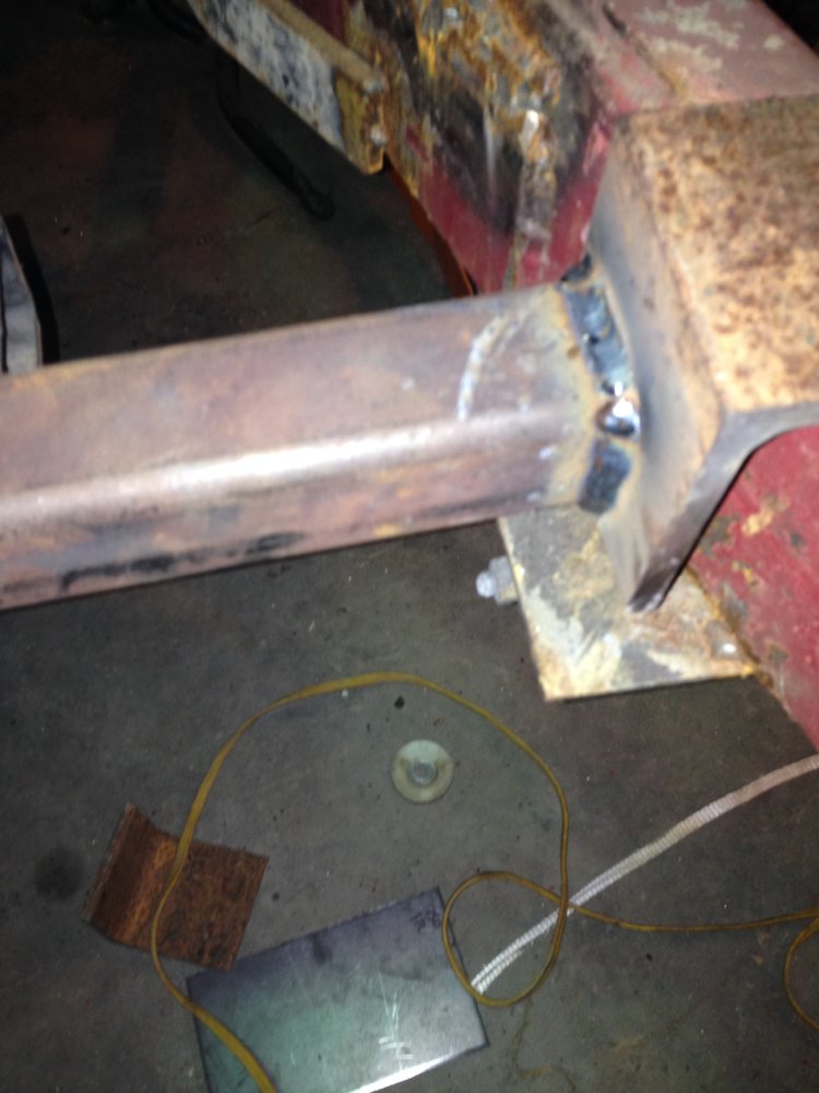

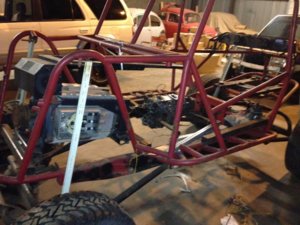

Here's a few pics of the front motor mount I was welding up. Ran out of gas on the bottom side

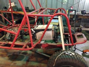

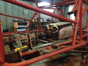

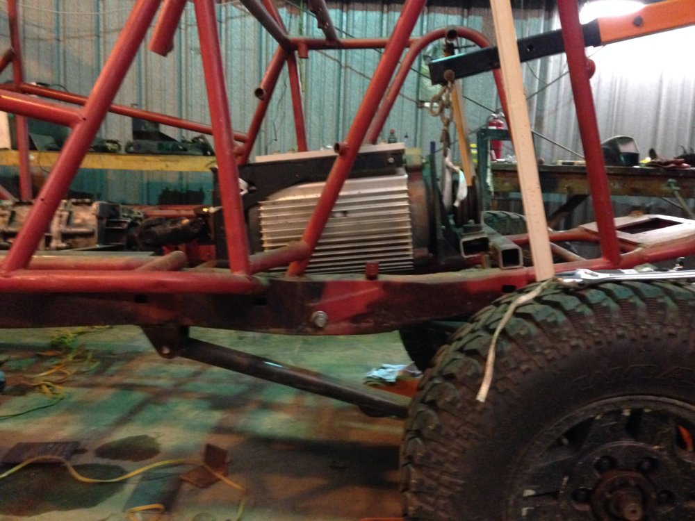

Alright have more gas now. Gonna set the motor down its sitting way high and I can drop it prob 4-5" which will help as its 310lbs bringing it behind the front axle by an inch or two hope to keep a good amount of weight up there for climbing. Going to use the crossmember I'm building for the motor mounts as an upper link mount as well be about equal length upper and lower links.

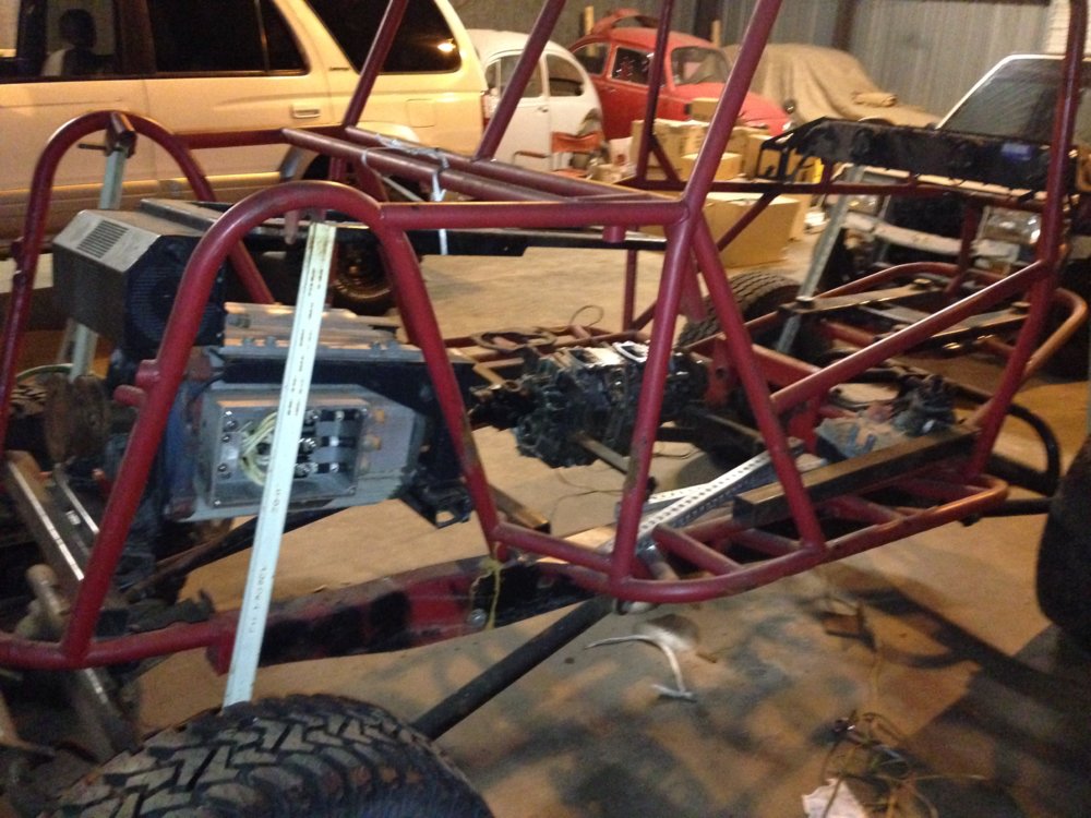

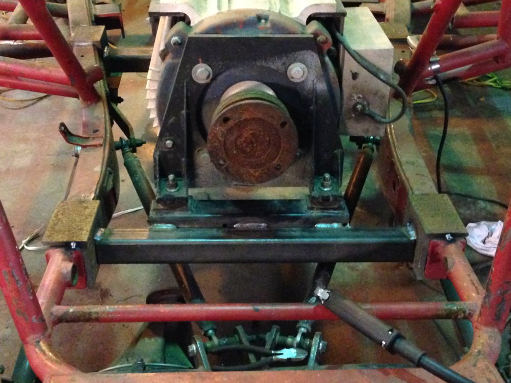

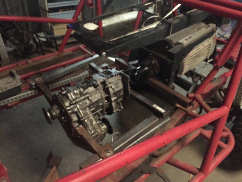

Motor is set lower rear mount done and tacked in place. Everything seems to line up and u joint should be happy

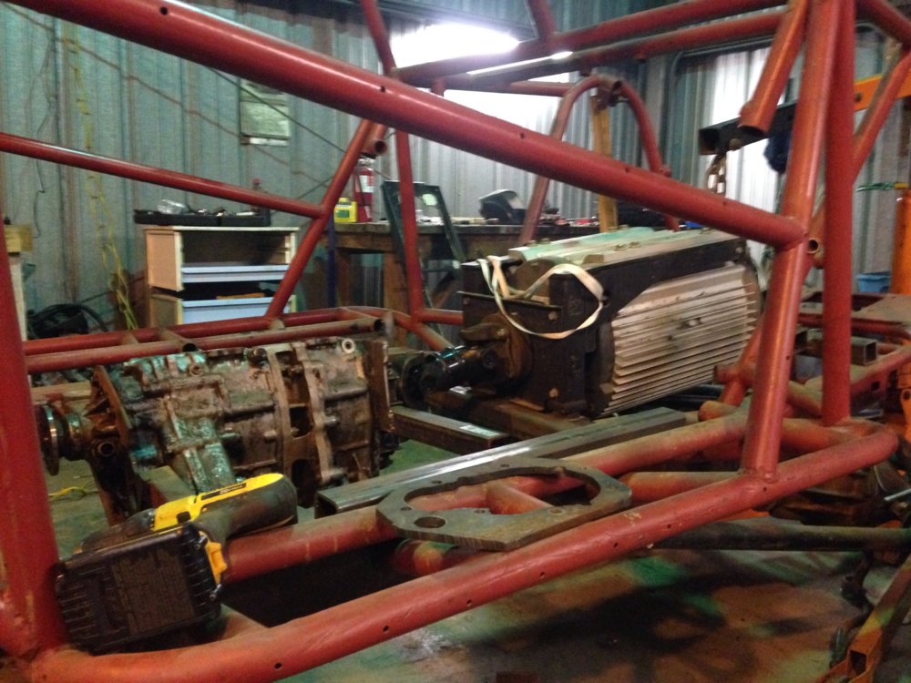

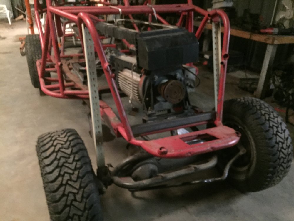

And the motor is sitting on its own weight. Got it a lot lower than even I thought I would
Now to pull it again and finish weld all mounts
