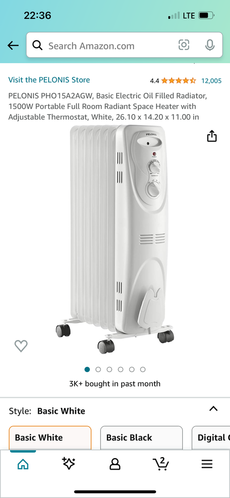

Oil filled radiant

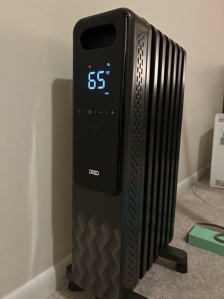

For now its sounding like the solution is an oil filled radiant heater and a fan a la @jeepinmatt redneck kiln, until I get the ineertia to run some 220v.
I just wish they made 'em for 20A so you could get >1500W
