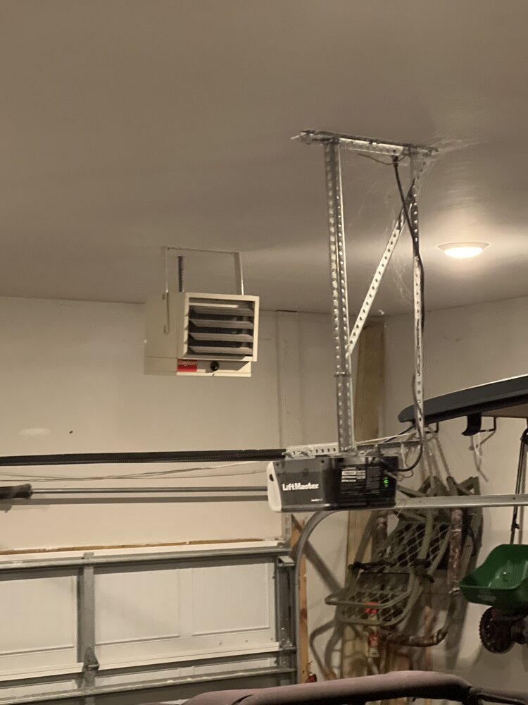

You mean like this one?
I quite love this solution. The only reason I won't do it is bc I'd have to turn it around again in the summer, which kills the lazy vibe.
Although, I DO have another window unit sitting in the shed... and 1 more window.... hm. Would have to deal with the drainage too.
Well that’s a little overboard but I’m not one to judge….
