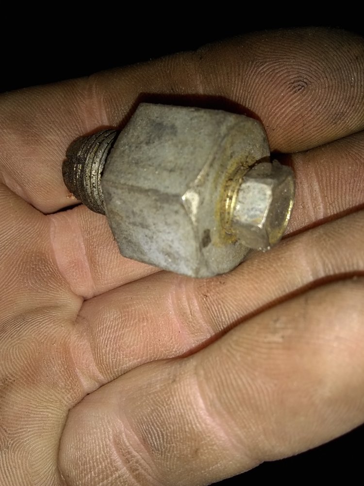

Could you make/buy a special drain plug that had a smaller drain within itself so you could open it to fill the tube without actually draining more oil than you need?
I’m picturing something like what’s in the bottom of an air compressor drain.
They have oil pain drain valves/spigots...like $25 or so.
They also sell exactly what you asked about.. sometimes people install them if they have to install an oversized plug because it stripped on an alloy pan. Common parts house stuff.

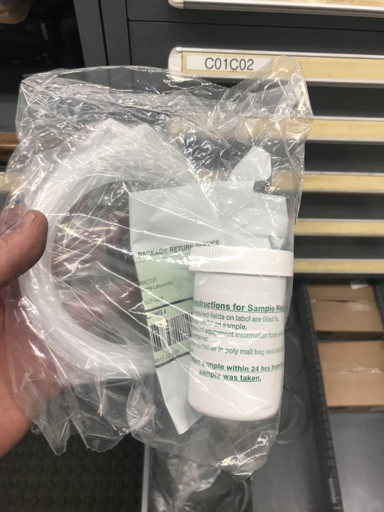

Kits should come with a tube to run down the dipstick. Less chance of contaminating the sample. The SOS kit is 22$. And comes with everything. Postage is included. It gets send to Carolina cat labs. You will receive an email with results in around a week. They also analyze auto trans fluid and diff fluid if needed.
Just figured that may be an easy way to grab just enough oil for the analysis, but what @Nakoma said makes a bit more sense.
