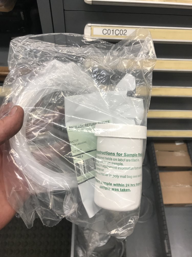

View attachment 284846 Kits should come with a tube to run down the dipstick. Less chance of contaminating the sample. The SOS kit is 22$. And comes with everything. Postage is included. It gets send to Carolina cat labs. You will receive an email with results in around a week. They also analyze auto trans fluid and diff fluid if needed.
So how do you get the oil into the container with the tube down the dipstick? Seems you would need to vacuum it out or start a siphon.

Put your thumb over the hole in the tube and pull it out.

Also most sampling companies do not recommend sampling from the dipstick tube. However many engine manufacturers do.
Why? During normal operation the dipstick tube is not bathed in oil. Particulate and even rust accumulation can happen in the dipstick tube and can invade and contaminate a sample. For an independent lab, this is bad. But for an engine manufacturer this is great because it gives them a reason to void your warranty.
You want to sample direct from the crankcase pan (not an extended drain tube) and you dont want to catch the initial out flow, you want it flow for a few seconds and then catch mid stream...

I agree the best way to grab a sample is midway during a drain. However the tube is there for another option.
All I wanted to do is give @rodney eppes an option for samples. Also Rodney, let me know if you want me to pick up a kit for you. I could get a little better pricing.

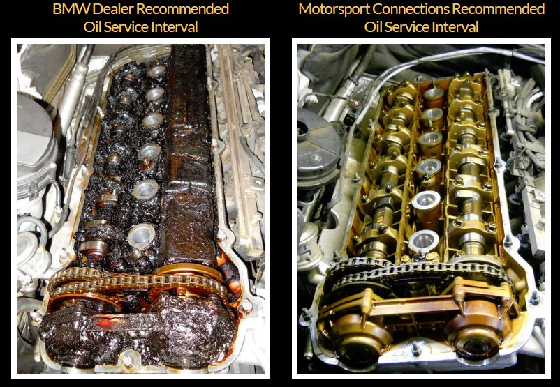

@BIGWOODY can tell you more precisely, but according to a mechanic I use for the wife's car, a BMW/Merc computer will base the OCI off the way you abuse the car. Wife had a Z4 she drove like a grandma and it would say over 25k between changes. This same mechanic will tell you that if you follow that route you will have this issue by 150k
No lie here.

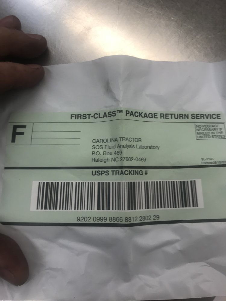

View attachment 284882 I figured it was common knowledge that Carolina Cat is NOT Caterpillar Inc. but maybe not.
The samples go to Raleigh.
Yes Cat Inc is in Peoria Illinois
Notice that's going to a po box?
Wonder why?
Also Carolina Cat doesn't have the Raleigh territory, that's Gregory poole. Why would they build their own lab outside their service AOR?
Wonder why?
