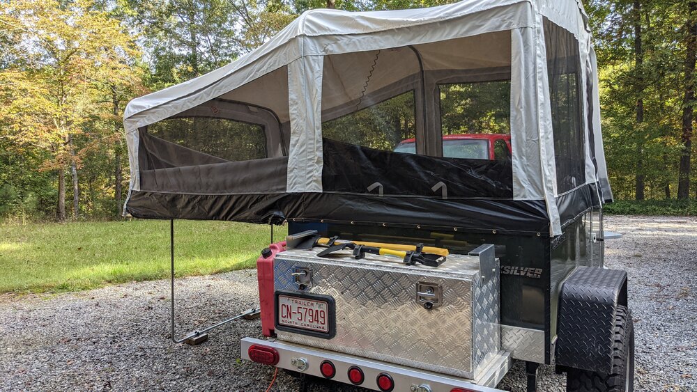

As many of you know I purchased this camper from a board member. With the height and the tongue and rear box, it is a bit hard to open by yourself. Well I had one hand near the hinge last week and it decided to close on its own. With one torn distal tendon and surgery I am one-armed for the next 12 weeks...
So I found these campers that open the same way and have talked to the company and they have agreed to sell me the struts to assist in opening. My questions are about mounting the struts at the proper angles. It appears to be close to 45 degrees but I can not get that much on the other side of the camper because of the rounded nose.
I also have the

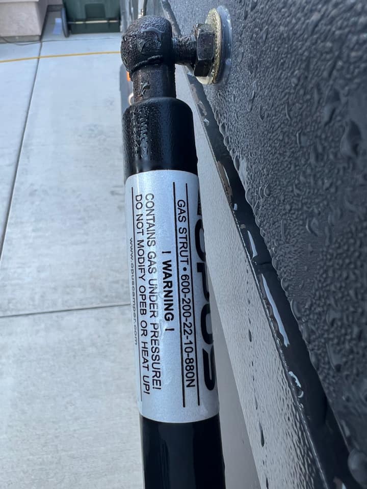

gas strut numbers that no one can match up other than the force which they say is 180 pounds, the top at 45 degrees is about 50 pounds measured the best I could with a scale.
So will the angle need to be close as I can get it to 45 degrees?
Will one provide enough lift or do I need to double the force if I can use two?
Can anyone decode these numbers? If I use MM it seems small for the compressed length.
Video of how they would work and pics of camper and strut below

IF you take the sticker off I bet the oem part number is underneath. There is only a handful companies making them. Like stabilus, suspa, ACE, and the china knock offs. And the resellers are notorious for covering up the part #'s.
But in general to match it up to another one all you need the following.
Force which is 180 foot-pound or 245 newton/meters
Overall length ball socket to ball socket generally in MM
Compressed length generally in MM
As for mounting you always want the body or tube side up when its in the compressed state. As for angle if I remember correctly you the top ball socket to be about 1/3 the way up from your pivot point. The more angle the better, But you can make up the angle by changing the force. But its been a while so here are some better info. I
