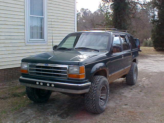

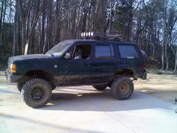

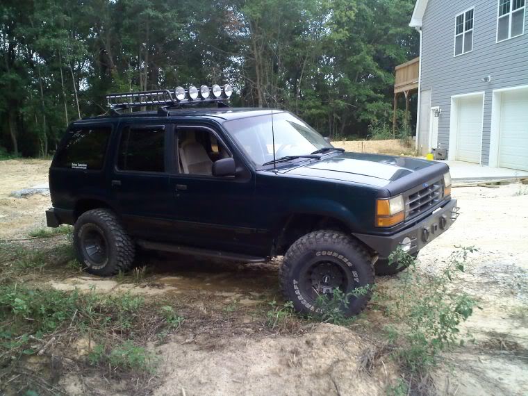

I was happiest with mine when it was 32s with 2" suspension lift. Front Springs, rear AAL and shackles. Throw an Aussie in the front and enjoy. I went to 33s, did a 3" BL to fit them :shaking:, 5.13s, disk brake rear, bumpers, sliders. The rear spring hangers kept hanging me up everywhere so I did a spring over and 6" skyjacker front lift for a bronco II. I think I would have been happy with it at that point if I took out the body lift, but my bumpers and sliders were built for the lift so I never did.
This was 2" suspension with 32s:
2" suspension 3" body with 33s:
And 6" suspension 3" body with 33s:
