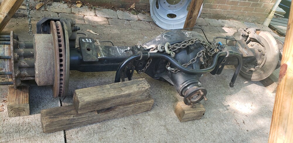

Well I was able to get one, and in fact it is 75.5” which will help me greatly.
I get f550 one
S110 = ~.35 wall and housing but the other one
S130 = ~.39 wall, this amount to ~20# total difference
And of course it's stronger
gears 4.88
flat round input on pinion
what's next .... nothing

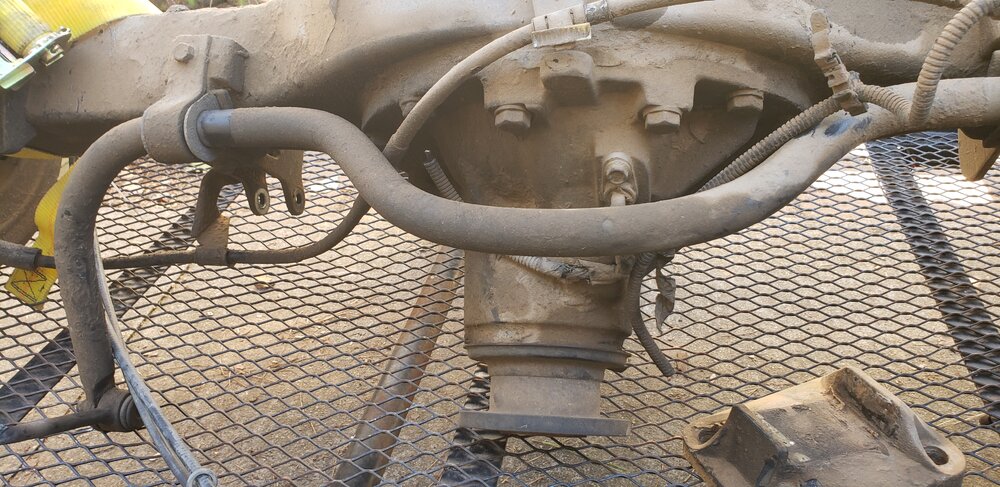

I've been into a couple of those. The carrier bearings can come apart under heavy abuse. I'd take a good look at the drain/fill plugs for any evidence of accelerated wear (beyond normal on the magnet).
Definite, I plan to pull it apart.
At a minimum, new seals what not.
with 250k miles i wouldn't be surprised if the
pinion bearing need a refresh
+20 year of gunk in there, needs a cleaning.

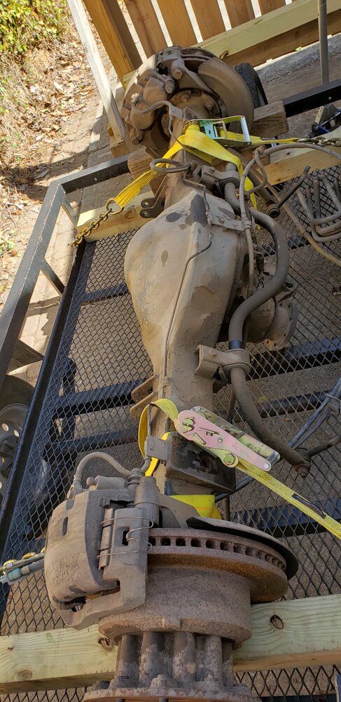

Work progress
Cleaned it up.
Got pinion and diff bearings
pinion seal
Sliced off spring mount on one side
Checked it is 4.88
Need to reverse one shock mount
Working on today
