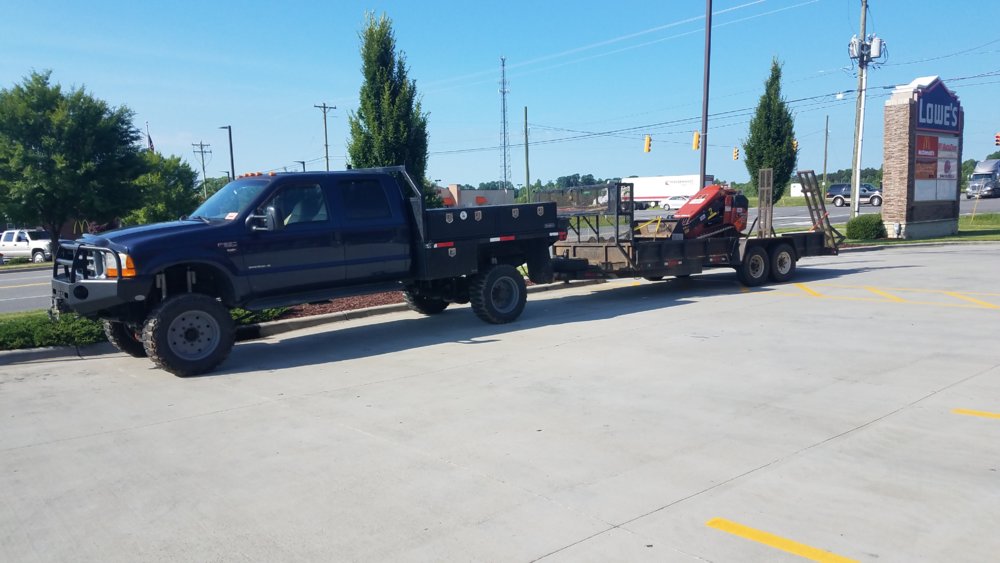

I just recently purchased a 2001 f550 cab and chassis 4x4 with 9'flatbed for work and play duty. Full kelderman airride and 37 super single setup, 135k miles, banks intercooler, big head waste gate, banks wheel, transcommand and banks chip in computer. It also has a buckstop bumper with 15k winch. Its a pretty sweet truck other than being a little large at full ride height.
The trucks gvwr is 17,500lbs and i tow several trailers, two that are in question. I have a 14' load trail dump trailer with gvwr at 14,800lbs and a 20' 7ton gvwr flatbed equipment trailer. That puts total gvwr at 32,300 and 31,500 respectively. I currently have the truck tagged at 26,000 and have a standard license.
My 1st question is this....do i need to get my cdls to legally run this truck even with just truck and trailer empty, or up to 26k lbs?
2nd......If that is the case, what exactly do i need to do to go about this. Obviously i dont have a semi truck nor a dump truck. I do have commercial insurance on the truck already.
3rd....... will i need to then have the tag upped to 33k to cover the gvwr of truck and trailer

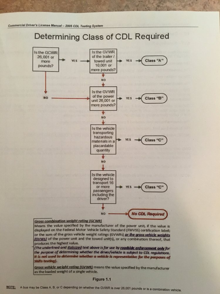

edit: OP you can go to the dmv and ask for a (free) cdl study guide. It has a flow chart that will answer your questions. I wish I could find mine to take a picture for you.
Google nc cdl manual. Third result down is a pdf of it. Page 1-4 has the flow chart.
I found the flow chart but keep having issues uploading the file. It still isnt completely clear. I assume that the majority of all the f450s and up running around are illegal in this aspect, as well as all of the f250s and 350s running large goosenecks.

Here’s the flow chart and I’m still confused. According to this I’m legal with a truck rated for 10K and a trailer rated for 16K. That clause for a trailer over 10K appears to only apply if your GCWR exceeds 26,001 pounds.
That's correct. It used to be that you needed a CDL for any trailer over 10k, but the legislature changed the law about 10 years ago after the DOT took to setting up shop outside of fishing tournaments and ticketing everybody as they left.
