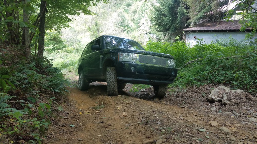

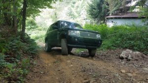

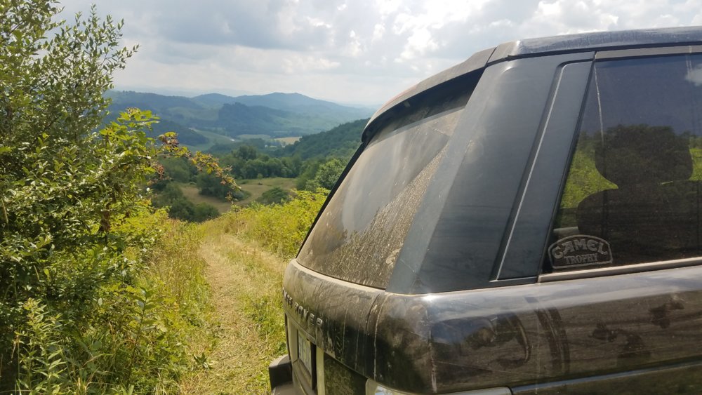

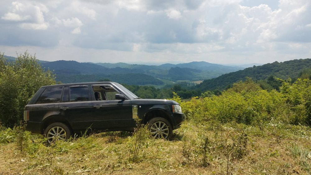

Wanted to take it up to the mountains for a camping trip with @awspence but it wasnt ready so i took the wifes ride instead, which we tow our yaks and camper with. 08 range rover 4.2sc westminster. Dont mind the chrome, still havnt gotten a chance to get it powdercoated yet. Have to find someone to do it.
