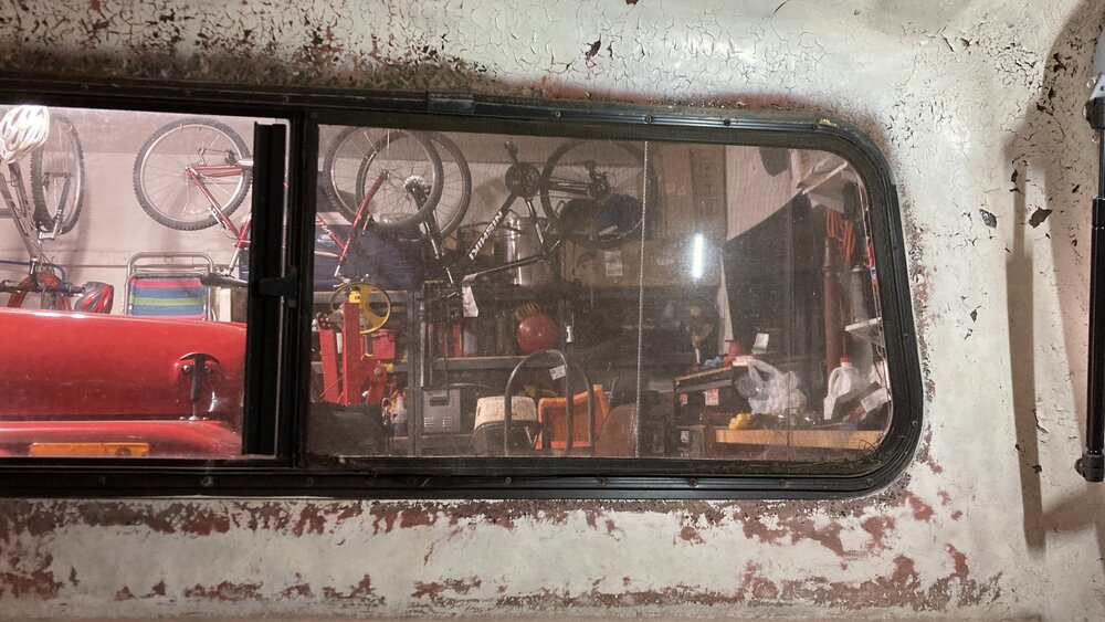

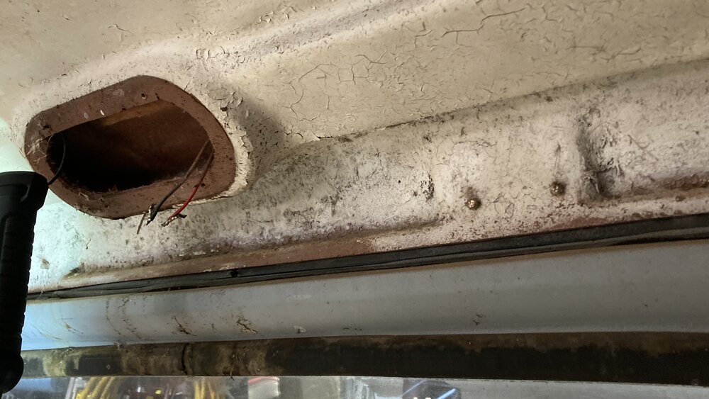

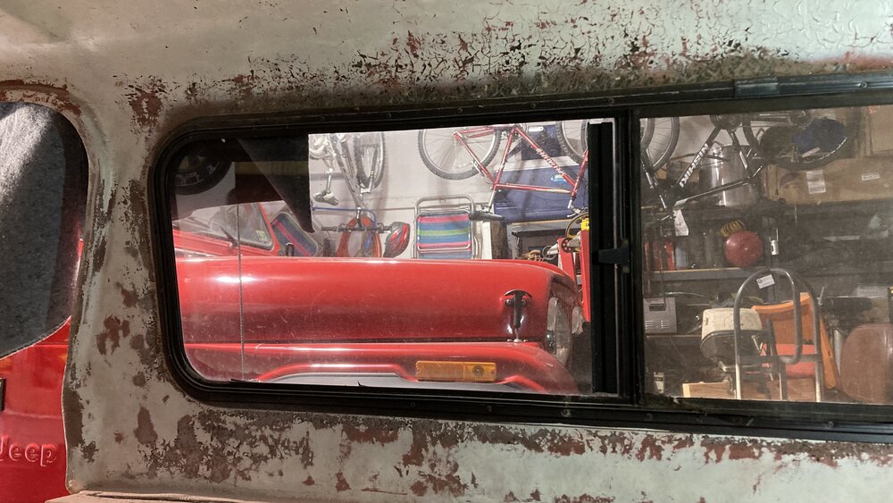

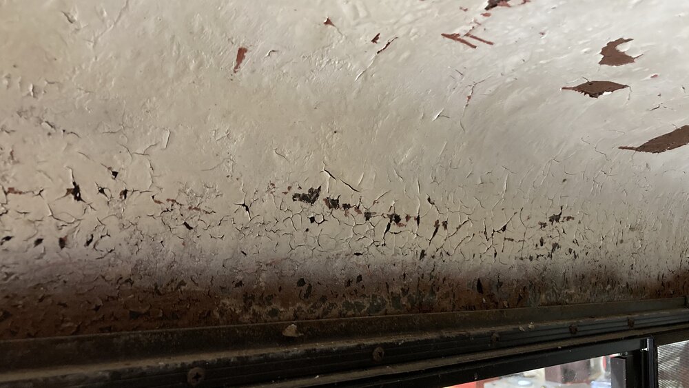

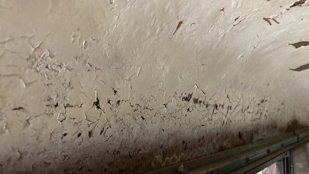

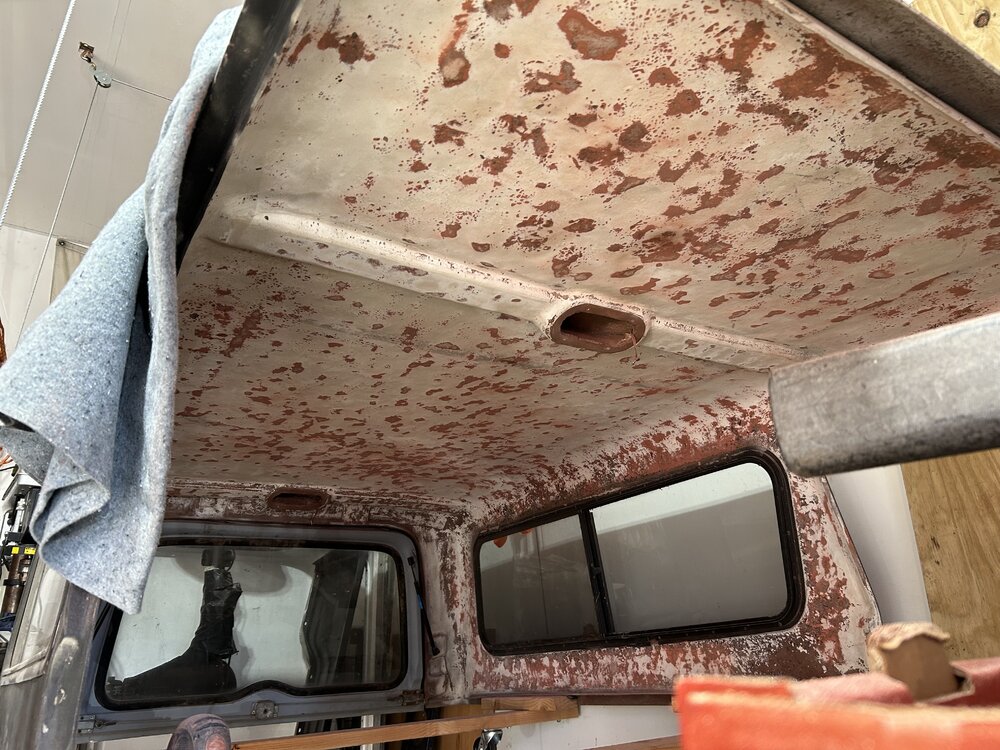

I’m finally getting around to this fiberglass top.
The paint on the inside is all cracked and chipping. I know I have to sand it all day and build back, but is there a sander that makes the job easier than another? Right now I only have my little black and decker ‘mouse’ sander that I’ve had for probably about 20 years at this point.
Any other words of wisdom for this first step? Aside from wear a respirator :)
You really don't want to spend all day using an oscillatory sander. You should use a dual-action (DA) sander for any type of body work like this. You can get them in electric and air power. Random orbit sanders would be the next best thing. Belt sanders are way faster than any of the above sanders but you have to be careful with them because material can disappear in a hurry and for body work you can quickly gouge a ton of straight lines into the base material due to the single direction of sanding.
Yup use a DA start with 60 grit, have to use a sanding pad on a die grinder for the radiuses and that'll look like a mouse chewed on it so go light and then hand sand the rusted out or run the DA on it tucking the edge into the shape. Finish it with some 300 grit and it'll be grand.
Open the rear hatch and put a box fan behind you to blow the dust away and you'll have a much better experience.

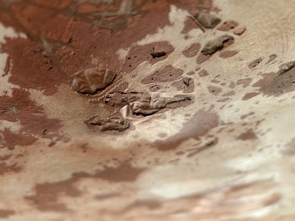

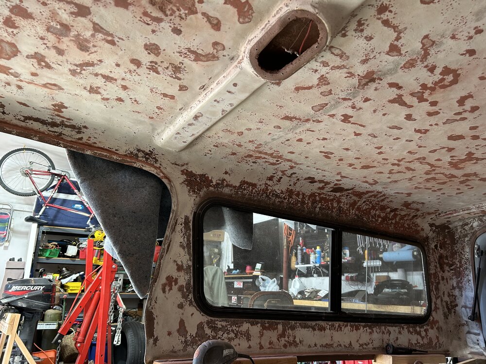

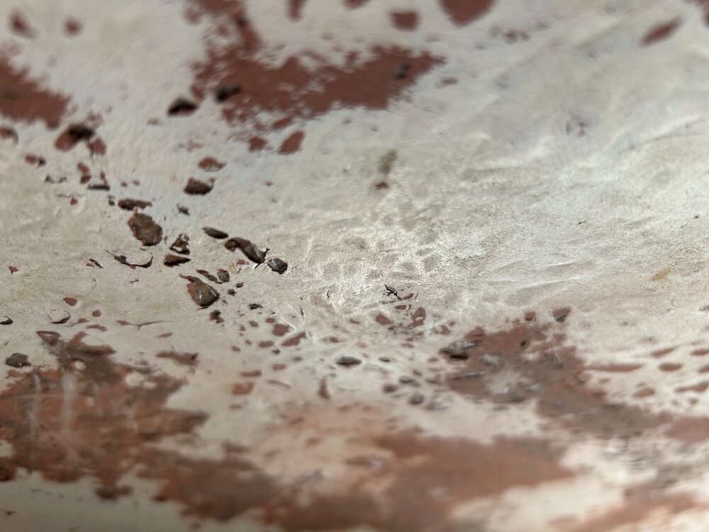

I think I’m done with initial sanding.
I used a mix of DA, the mouse for tighter spots, hand sanding for tightest spots, and a wire wheel cup in my drill.
What’s the best thing to do with these pock marks? Should I fill them with hardener? Go over the whole thing with fairing compound? Or just buy lizard skin / herculiner / whatever and move on?
I’m trying to decide if I can live with seeing all the little bumps and what not once it’s done.
I'd smear some fairing compound in the voids and call it good.
You could always roll the paint. Even if you spray it, you can come back over with a roller and put some texture in it. The finish on tops like that was never that good to begin with, so just knocking off all the high spots and filling the voids is going to look pretty good, not to mention that it's probably better lit in your garage right now than it'll ever be once it's back on the truck.
That’s right where my head is at, and I was planning to roll it from the get go.
I know you didn't ask about the exterior...however, mine was faded and looked like it didn't match very well....so I rolled the outside of my YJ. Looked phenomenal too
I also rolled the inside black as well. I preferred it to the factory white as it kept it much darker inside. Though it wasn't cracking, I did hit it with kilz first to make sure what I rolled stuck to the inside.
