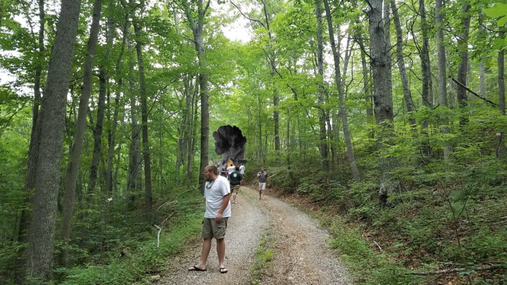

You've never wheeled with Randy Sloan have you :lol:
We had about 10 extinguishers there in less than a minute. There were so many people going to help, I couldn't get my doors open, so I was just handing out my fire extinguishers haha.
