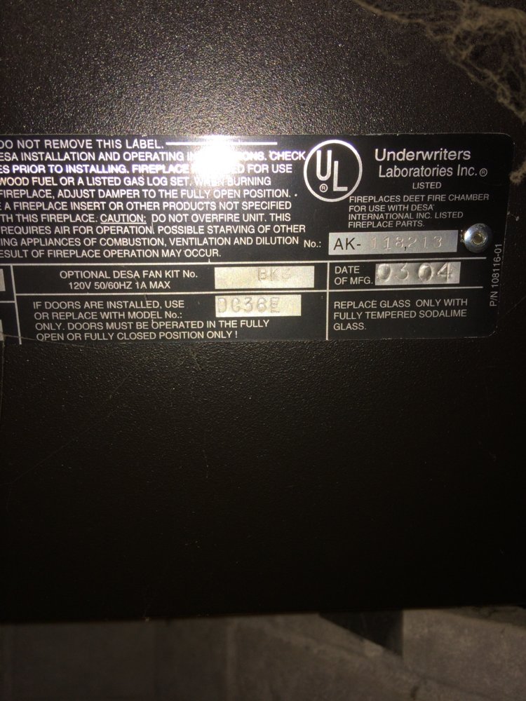

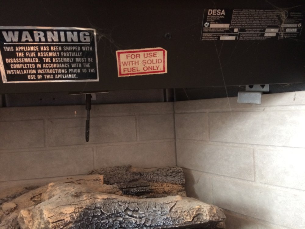

Sticker says solid fuel only... am I damn stupid or is wood not solid fuel?? Lol

This says for solid wood fuel or listed gas... would be nice to have wood burning fireplace it already has chain and glass on it!
Ok it's legit I looked up manufacture and states that model is for both gas and wood! I'm stoked... now I gotta chop some wood lol

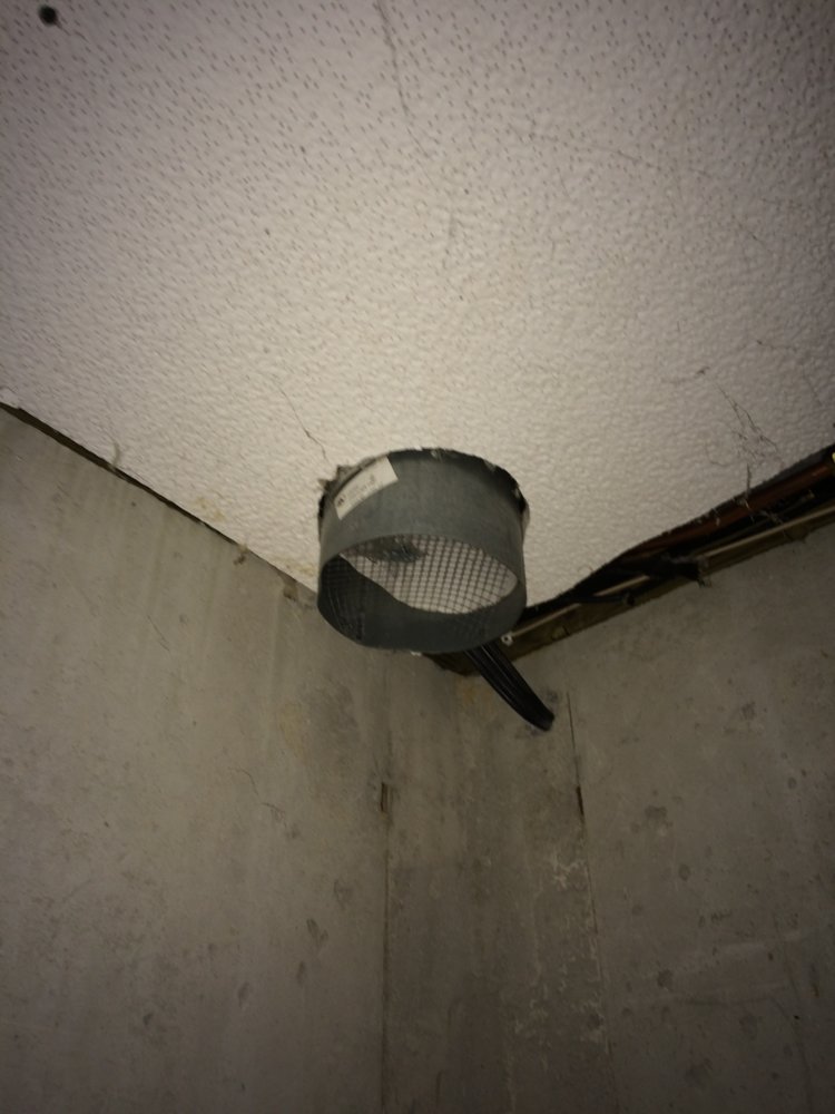

What's the pipe for that goes down into my basement tho?? lol wood stove attachment maybe??
I'm assuming ash Shute!? Only thing that makes sense really...
View attachment 260205 What's the pipe for that goes down into my basement tho?? lol wood stove attachment maybe??
Do you have a boxed chimney on the side of the house? have you seen the top of it? It probably has 2 pipes for 2 fireplaces or woodstoves. The worst thing about toting wood through the house/upstairs is the wife bitching about all the bark and stuff all over the floor.
and when she does start that jabbing I will say Runnin a broom is way cheaper than running the heat... as I'm far enough away to not get hit! Luckily the fireplace is about 20' from the door so it shouldn't be to bad, but I know what ya mean I use to have to clean all the bark up for wood stove!! I don't think it has two pipes def not a the top it's a single opening
