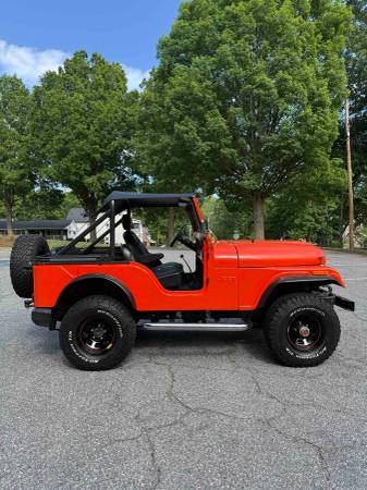

Hey everyone — long-time car enthusiast, first-time Jeep buyer here in Raleigh. I've been researching a 1972 CJ-5 in Winston-Salem and would love some advice from people who actually know these things before I pull the trigger.
A little about me: I own a 2012 Corvette that I've never touched mechanically. I can change a tire, a battery, and check my oil — that's the extent of my experience. I'm not a mechanic and I've never worked on a car. I want to change that, and part of the appeal of an old Jeep is having something simple and forgiving to learn on without the intimidation factor of a dense modern engine bay.
What I'm looking for: primarily open-air cruising — doors off, no top, summer driving. Not a trail rig. I want something with character that I can slowly learn to maintain and make my own over time.
The Jeep: 1972 CJ-5, 258ci inline-six, 3-speed manual. Owned by the same person since 2019. They've been extremely transparent: new carburetor (2019), new starter (2020), new KO2 tires and wheels (2019). They provided a bunch of undercarriage photos upon request. Frame appears solid in photos - some surface rust, but nothing unusual for its age (I would ask a mechanic to look closely at this for the PPI). Steel body. Clean title. The seller is offering to drop it at his trusted local shop for a PPI, which I plan to take him up on.

Welcome to the forum. Imo, an old jeep is a great platform to learn from. They are simple and easy to get parts for, oem and aftermarket.
I really like a CJ5, but I would keep my eyes out for a CJ7. They tend to drive better with a little longer wheelbase. I'm not sure how tall you are, but I wouldn't want a CJ5 if I was really over 5'10".
The drivetrain in the 72 you linked is a great platform just to putt around with. I actually like driving a 3 speed. Off road, they are terrible. You can run on the hwy with it, but it won't win any races, for sure. In 76 they got a better frame and the CJ7 was introduced.
The main concern with one is rust. They are bad in several areas. Paint chips really shouldn't be a concern. The frame and tub underneath should be inspected well.
I noticed that it has a body lift. I'm not much of a fan in that respect.
Wiring can be a mess on them, but there really won't be a lot in there. So fixing gauges and all is not terrible. Fuel gauge could mean dropping the gas tank for the sender, so don't discount that.
Tool time is probably a good place to take it. They should be capable of inspection.
Value is what someone is willing to pay for it. So, that is in the eye of the beholder and really all over the place.
My first Jeep was a 76 CJ7 with a 4.2, 3spd, with manual steering and manual drum brakes. It got the job done, but I wouldn't recommend it, haha. First thing I did was convert it to power steering and front disc brakes. Made it much better to drive. It still did not drive great, haha. Then put a 2-3" lift and some 32" tires on it so it definitely wouldn't drive good :D
The 3spd requires some clutching to get going, but its fine if you're not trying to run interstate speeds. The 4.2 is a solid motor. The short wheelbase of a CJ5 will make it feel more "fun", but a CJ7 is a better driver and more spacious.
As long as you are buying it for the character, and not for reliability or a daily driver, you can't go wrong with the experience of an old jeep. But it will force you to learn how to fix stuff. This is a solid forum for advice, so welcome aboard!

You are approaching this correctly in the terms of wanting to learn by immersion because you will have to learn to repair and maintainand these are pretty simple rigs. Personally if you buy this one, I think you'll have buyer's remorse pretty quickly. It's priced too high for the condition that it's in even though its pretty clean. Y'all tell me if I'm wrong but I am seeing a body lift. That means it really has no upgraded suspension so it will be sloppy riding and will sway in turns more than a regular Jeep. The paint is marginal at best and it def has body filler over who knows what. Not uncommon for an old rig but expect more of the separating and rusting through as it ages. I think this is more of a $4000-$5000 rig at best.

Cons: Narrow track axles and narrow wheelbase. Drum brakes. If the engine is original there is a good chance it is a 232 not a 258. I would want to see the letters and numbers on the engine block. As Matt mentioned for 10 grand you could get a TJ which will have more drivability.
