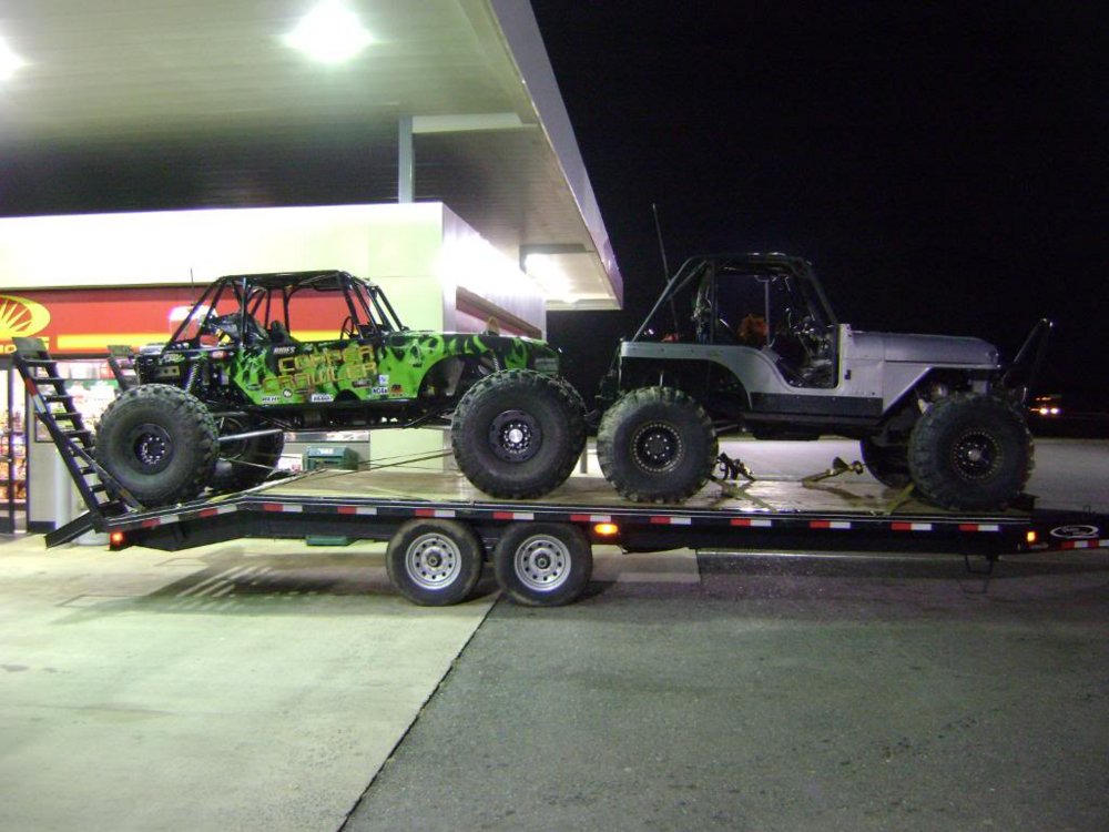

Many trips like this, 4k on dove and 4k on flat, never an issue.
.....but my tow rigs have always been 1 ton or larger duallys, currently f450 and 550's, previously chevy 3500 dually. Or with my 30' foot rv.
How long is that trailer?
