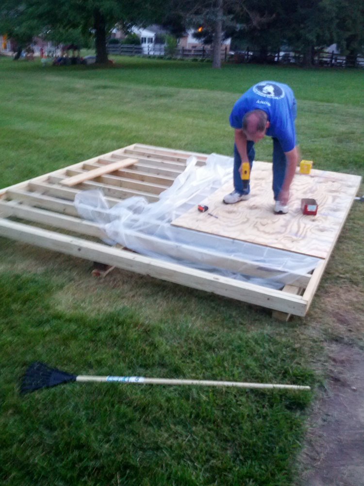

Mom & dad were in town, Dad was getting stir crazy so we worked on making a platform.
After a lot of debate, we decided to make it from 2x4s as studs, but run 12" on center, and rest is on 4x4 ground rated cross ties, one on either end, inset a little, and one in the middle, so the span was only a little over 4'. Got 1/2" plywood for the decking, and put 4 mil plastic between the the frame (joists etc) and decking.
Attached pic is how it looks today. unfortunately the ground isn't perfectly level so we had to do a lot of adjustment w/ some cinder blocks and random wood pieces to figure out the right amount to offset it from the ground (wedged under the 4x4a). plan to have a contact point at 3 points on each of the 3 beams, althoght the front beam is mostly just on the ground.
One question on that. Where can I get different size pieces of cement/stone blocks to use as "pillars" to level it out? E.g. I need one that is only ~3/4" high, another 1.5, one maybe 3.5, etc. Right now I only have the standard blocks from HG/Lowes etc, not enough options.

Nope, just laid the 4x4s on the blocks, the built the 2x6 deck on top of that. I spent a good amount of time setting the cement block height, making sure it was level.
We spen ta lot of time this morning leveling it out, and digging out a little to make some of the blocks fit. In the end it is supported on the end corners, and the middle of each side, and in the center (9 posts total). The on in the center is just a tad high, but I figure if it changes any over time it's easy to access and build up the others.
Its pretty amazing how much having that center support stiffens up the 2x4s.

Treated 2x6 on 16" center with ledger strip, double banded, 3/4 marine plywood glued, all fastened with ACQ screws sitting on 4x6 runners and 6 4"solid pavers. If you want it movable I can explain an axle and hitch set up that you can move with the lawn tractor.
can't hide money I guess:flipoff2:
Just dropping to 2x4s and 1/2" treated plywood knocked >$120 off the build cost. I did double band the sides, and used the 4x4s to function as the ledger.
I did also put an extra 2x4 running horizonal along the side edges to make that really strong and give something to grab and pull it.
