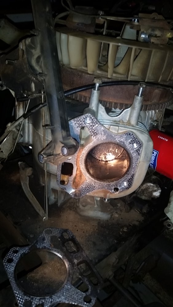

Well this sucks. Was hoping changing head gasket would stop my husqvarna kawasaki v-twin from going thru oil like crazy, guess not. Looks like the wrist pin dropped and scored they cylinder. WTF, how does that happen?

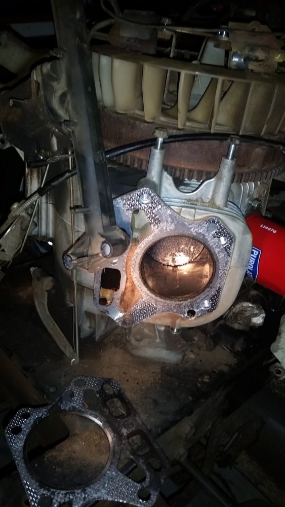

As a small engine tech, Id drop that briggs in there and run it another decade!
Isn't the frame of the mower cracked though? Plus you still need to replace the broken steering parts. Man, I don't know if it is worth bringing that thing back from the grave.

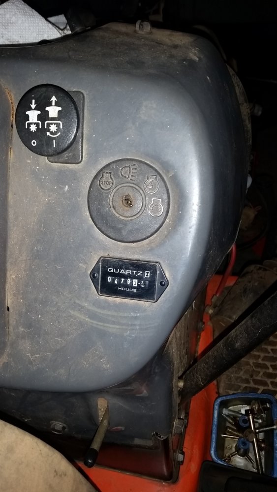

Um, yeah, now that I really think about. Figure 35 wks/yr at 1hr each is 350hrs/yr. 15 years puts me around 5250.
I dunno, maybe the 1/10th are really ones?
my guess was pretty close, but still loses by the price is right rules.
I have one that's just starting it's third fourth season and has 300 hours on it. Never mowed a yard other than this one.
My guess is the hour meter rolled over once already. ;)
Or, more likely, it quit 12 years ago.
Edit: also, you're terrible at maths.
Edit: I'm also terrible at maths
Yeah, that's only 525 hours, so you're in the ballpark. For that much time, though, I'd be wary of putting a new power plant on a chassis that was degrading with the old engine. New problems may appear. $150-300 PTO clutch and internal issues with the transaxle are my biggest concerns. My John Deere customers are usually replacing their units between 400-800 hours, depending on the model. We also have some that are in love with spending money and resurrecting machines that should be retired.
