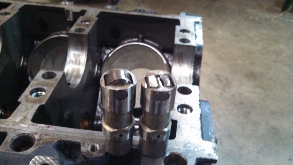

Not then. I bought mine new in 03, tuned it by 10k miles. Bought a different tuner (sct) with custom tunes around 50k miles. 50k is when the egr cooler busted, then somehow trash got in the low pressure oil pump and made the regulator stick. I assume trash got in while the oil filter housing was off and the egr cooler was being replaced. I took it back and fixed that myself, it was blowing oil out the exhaust through the turbo. Those and one oil cooler were the only issues I had that I blamed on Ford. Between 50k and 220k, I replaced 14 injectors total, 2 clutches, an oil cooler a turbo and a 10.5 rear axle, I take full credit for those. It would spun the 37 or 35 inch tire (I switched) on the rim doing clutch drops in granny low or 1st. It spun the bearing races in the axle housing. The turbo lost all it's exhaust wheel fins somewhere above 35 psi boost, itd hit 42 on two different mechanical boost gauges. All on stock motor. That's when I permanently left it on the tow tune.
Finally around 220k I came out of an oreilly one day getting parts to fix my trail rig the day after getting back from the flats and it wouldn't crank. Pulled in the lot just fine. No low lube oil pressure, no icp. Pulled the oil pump found debris, pulled the pan saw a cam lobe missing. Pump sucked up a lifter needle bearing after wearing through the lifter and broke the pump gears.
I started noticing metal fuzz on the drain plug magnet around 200k, it took 20k to wear it out. Never heard an unusual sound still had decent power.
I did a full rebuild myself. EDIT: during the build i installed head studs a bulletproof egr cooler, and an upgraded hpop. Between 220k and 300k i replaced 2 more injectors. Right around 300k miles I started seeing metal on the plug again so I traded the hell out of it. The front seats were showing wear, and the whole front end was worn out, Tre, bj, etc. It needed tires and pads and rotors all the way around, plus my Delta's were getting over 15again too. I'll be the first to admit mine was abused, I was young and dumb. The new 6.7 truck is bone stock other than the radio.
