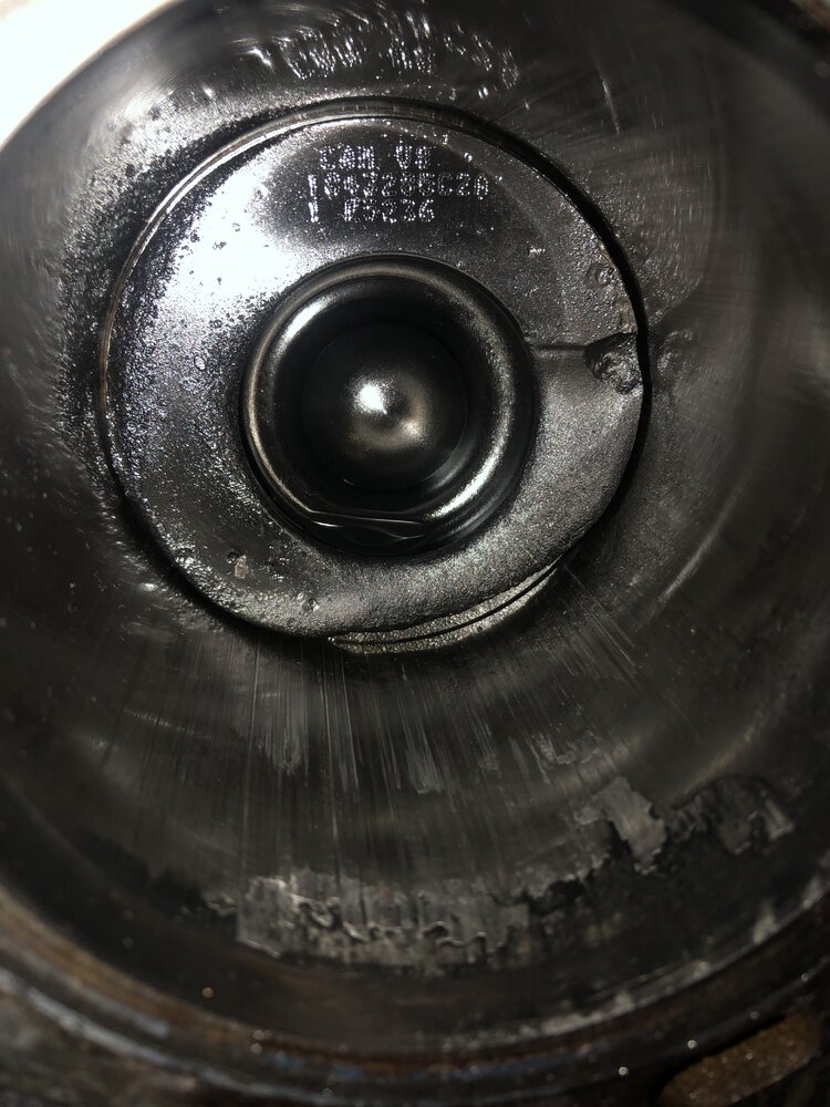

Im fixing what I have this time.I think Im gonna be in about 4500 when its all said/done.After doing some research and looking around it seems a stuck inj washing down a cyl is not uncommon for a 6.0 esp the 03/04"s.I tried to do my homework before buying one because I knew they had issues but I missed the stuck inj issue some where.Theres a 05 6 speed dually on MP right now that needs a engine due to a stuck inj and it only has 67K on it.
