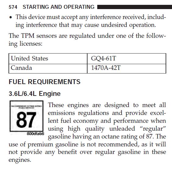

And, the dodge 6.4 requires you run 93 octane.
This is incorrect. Per the owner's manual, 3.6L & 6.4L engines are designed to meet all emissions regulations and provide excellent fuel economy & performance when using high quality unleaded "regular" gasoline having an octane rating of 87. The use of premium gasoline is not recommended, as it will not provide any benefit over regular gasoline in these engines.
I've got 41K miles on a 2014 Ram 2500 with the 6.4L and I've run nothing but 87 through it with no issues.
When I was looking into the trucks, everything I saw recommended 93.
