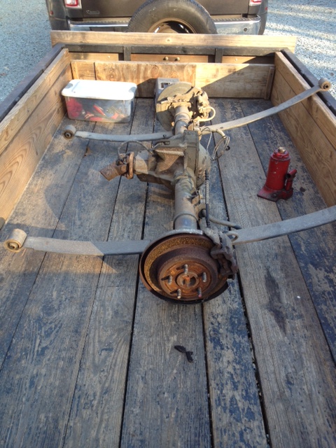

I got a ford 8.8 out of a 99 explorer. It had 4.10 gears and an open diff which I looked around for a bit in case I wimped out on the re-gear but it's a moot point, I went ahead and got a set of 4.88's right away. The explorer had 240K on the clock anyway and the diff had been opened at some point from the gasket RTV I suspect.

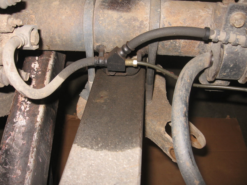

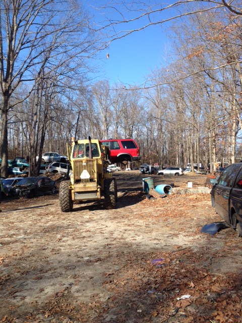

Here is where it began. $100 bucks and I was on my way.

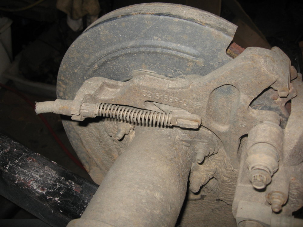

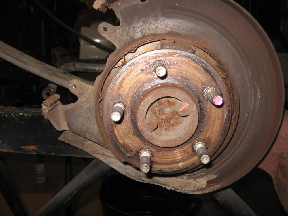

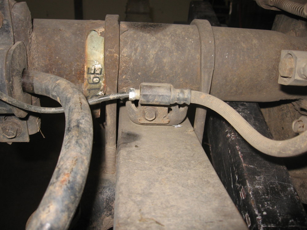

Got it home

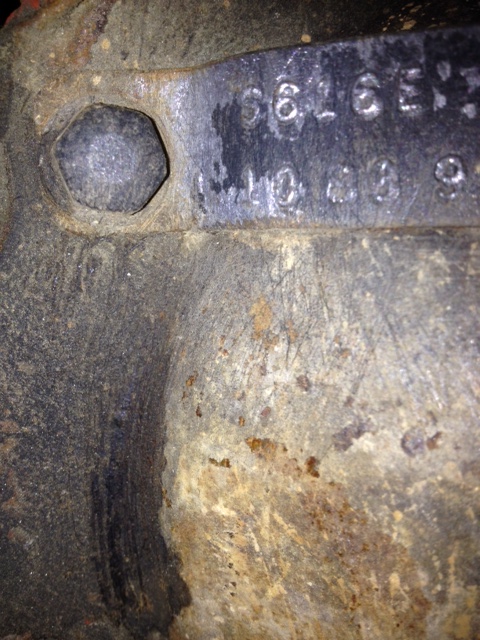

Axle tag. 4.10, 8.8 and built April 9, 1999.

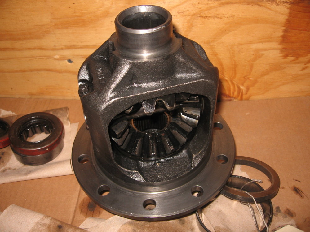

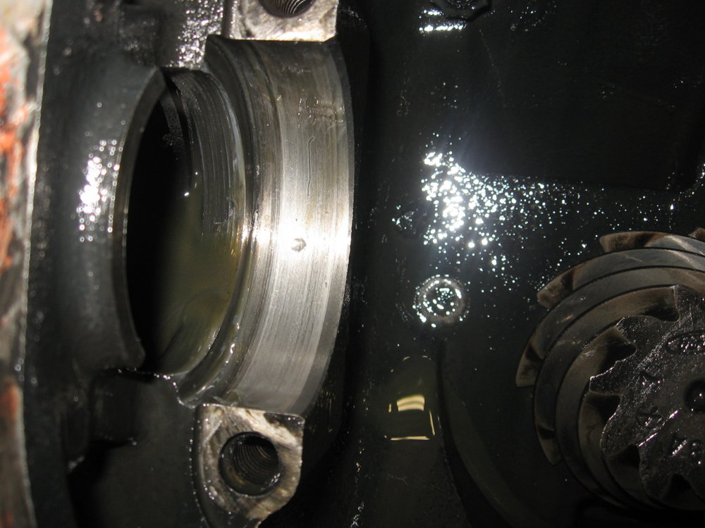

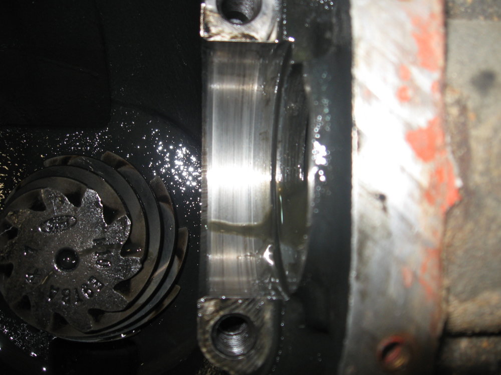

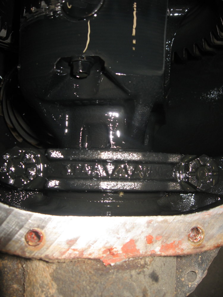

OK, first question. The left drivers side carrier bearing seat has this pit in it. Doesn't look marred up or anything but has defintely got a pit there. I assume this is not a big deal as this is where the race sits so nothing should be moving here. The race seems to sit in there fine by my untrained eyeball when I drop it in and put the cap back on. Is this any problem to be concerned with?

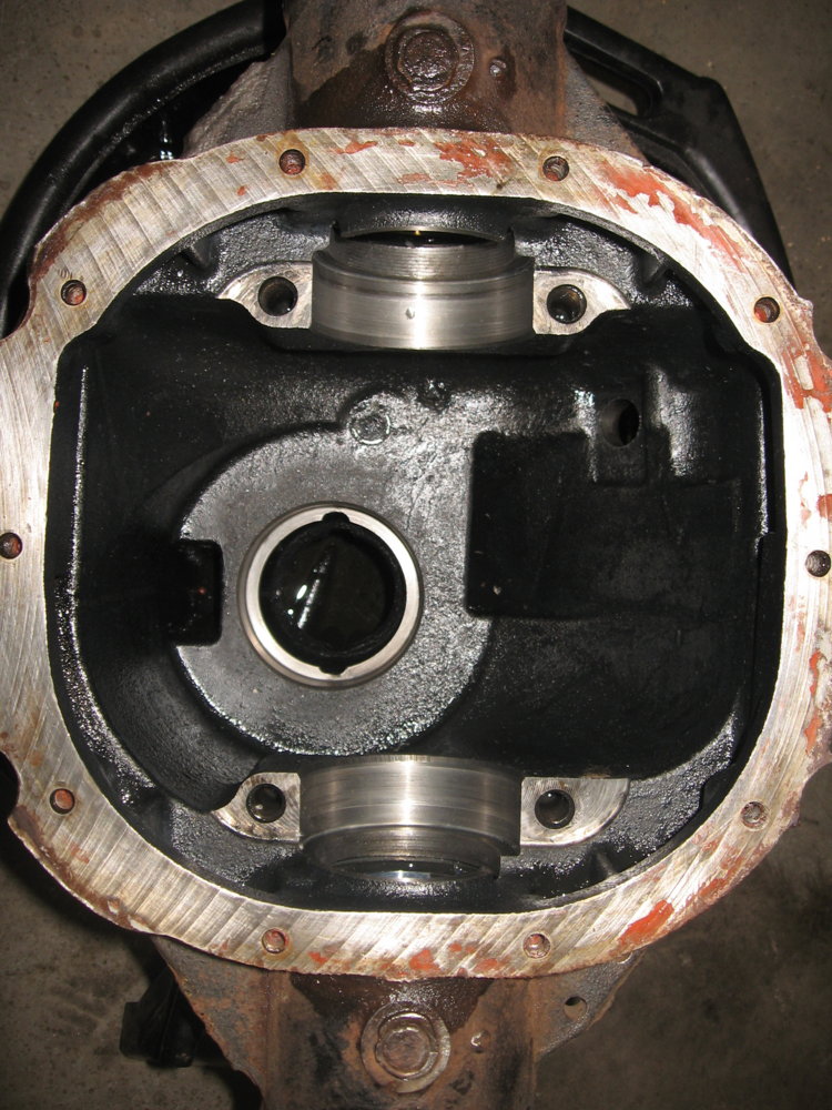

Here is the passenger side bearing seat.

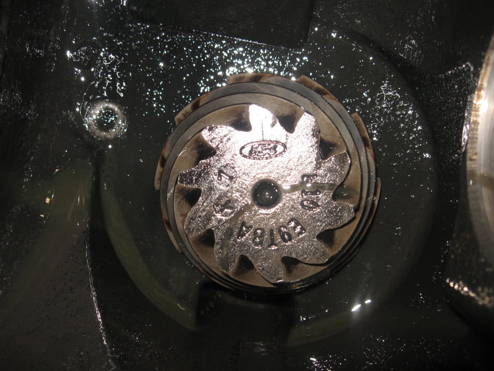

Here is the pinion head. I can see 'Ford' and some numbers and an X 7. I thought I should be seeing some kind of + or - .002 or some number on the amount of difference it has from zero shims hand scribed on the end of the pinion head. From my reading I was understanding that I would adjust the new pinion accordingly using those numbers and whatever may be on the new one. I don't see any markings. Does this X 7 mean anything?
Sounds like a cool build. I wouldn't sweat the pinion preload...that thing has got some miles on it. As long as the pit has nothing sticking out you are fine. Want to make sure the carrier bearing race sits in all the way. Not sure about the pinion marking. Only Dana writes a pinion offset measurement on the head. Couldn't tell you what x7 means. If nothing, I would use the existing pinion shim stack measurement as a starting point.

On your carrier bearing journal make sure there is not a lip in the machined area for the race to sit, this would indicate that the race has spun and the Cap will not compress the race as material has been removed.

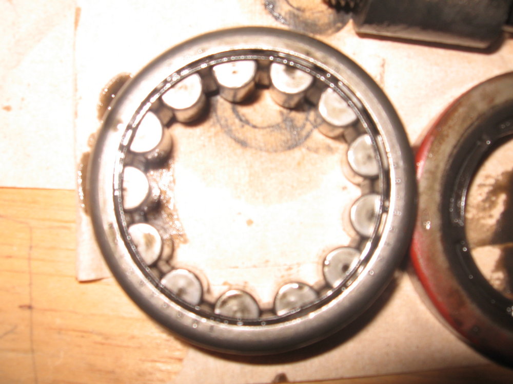

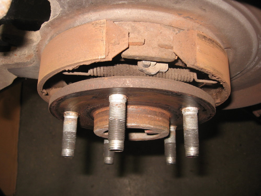

I made some more progress. The worst part of these projects is the clean up of the old crap. I got the brake backing plates and e-brake shoes disassembled, rented a slide hammer and bearing removal attachment and got the wheel bearings and seals out.

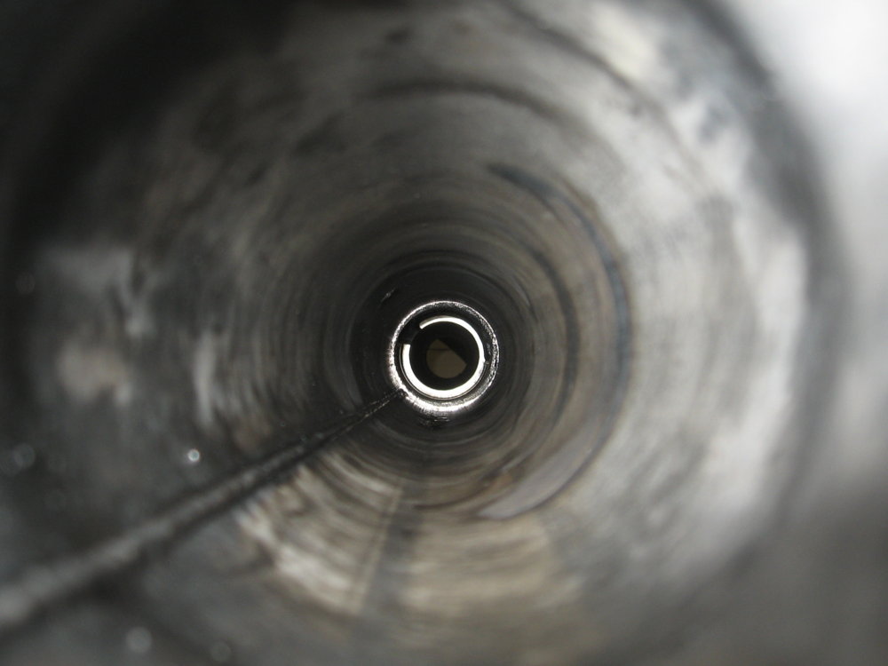

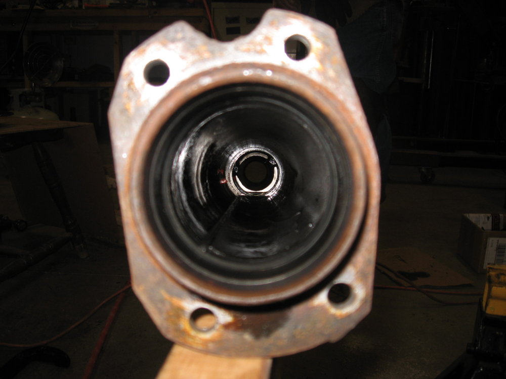

Tube view after removal of brakes and bearings

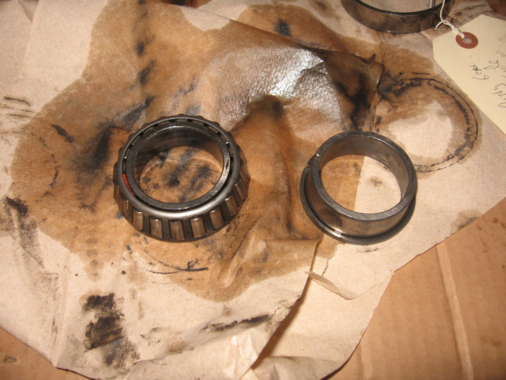

wheel bearing and seal
I then removed the carrier bearings. Boy was this a circus. I got one with a 2-jaw puller I rented (POS). The other one I gave up and cut the cage and then the seat almost through and was then able to get a better grasp with the puller and had weakened the bearing seat and it popped off. I was nervous about scoring the carrier but I didn't ever touch it.

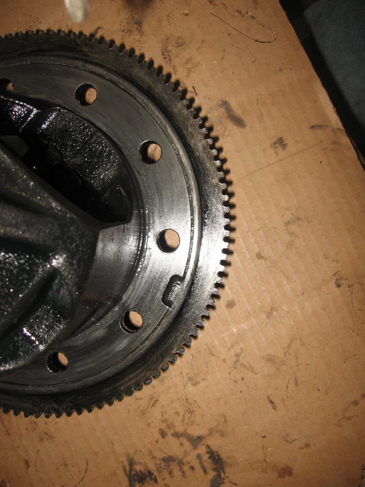

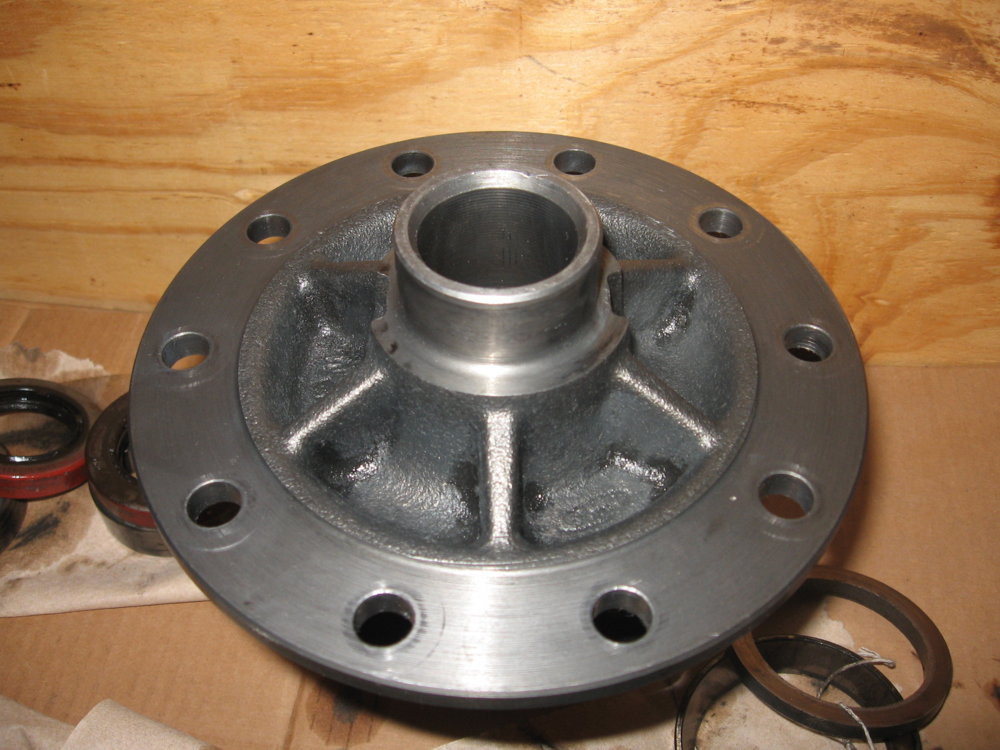

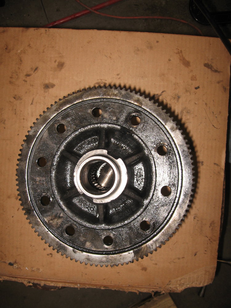

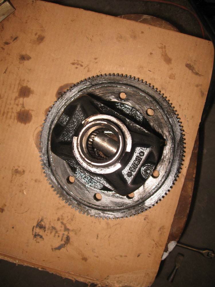

I removed the 4.10 ring gear from the carrier. I removed the bolts and used a punch in the holes and tapped it off without any trouble. Here is the carrier, still has the abs tone ring on it in these pics.

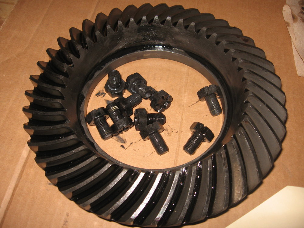

Here's the 4.10 ring gear. If anyone needs an 8.8 4.10 ring and pinion let me know. They seem fine to me. I see a chip off one tooth end on the pinion and the pinion threads on the end look a little goofy but I think it's just fine.
I popped off the ABS tone ring. No need for that in there anymore.

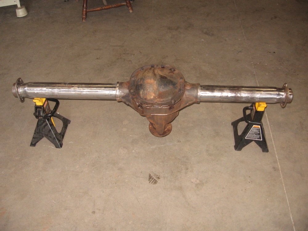

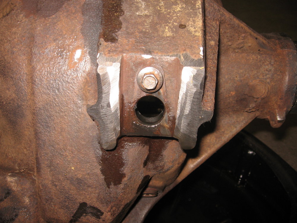

I put the cover back on the pumpkin and power washed it as best I could. Then I went at the bracket removal. I've seen alot of folks using cut off wheels. Screw that, I used a torch and cut conservatively (read way too damn far away). I am not good enough to blow the weld out so I did have some grinding to do. I hate grinding.
After grinding the remnants off and wire wheeling the rest of the rust and finally a flapper disk to make it shiny.
I then removed the ABS sensor and cut the ears off the casting that protects that sensor. From my reading, that has to go in order to clear the TJ sway bar. We'll see but it's cut off. Just did this with a sawzall and metal blade. That went better than I expected.

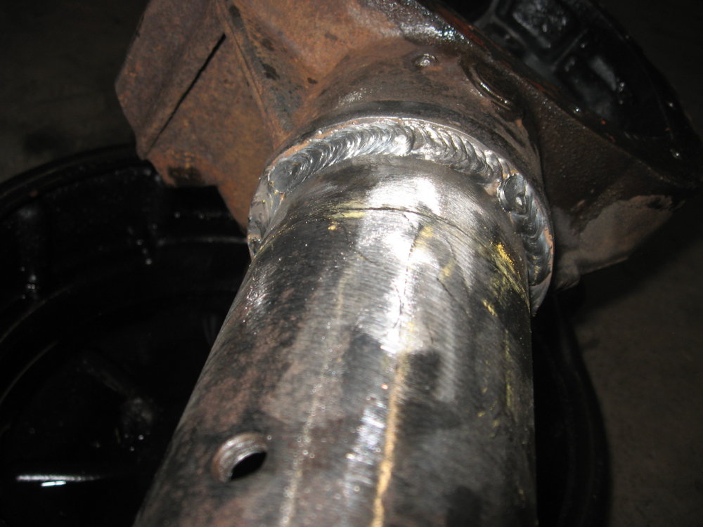

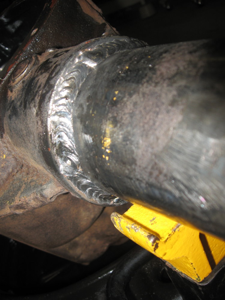

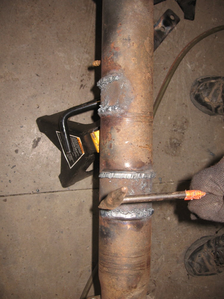

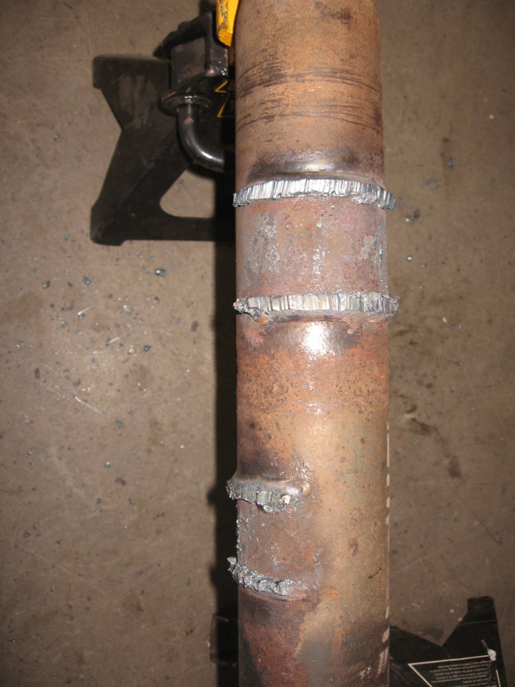

I then welded the axle tubes. There are a ton of opinions out there on this. I don't know what is right or wrong to do. This is welding steel to cast steel (not cast iron, which is a big difference as I understand it). Questions on pre-heating, not pre-heating, tig, mig, arc with a special rod. Well, I don't have a tig (not do I know how to tig), I have an arc welder but totally suck at that and don't have the fancy rod. I do have a mig welder and am reasonbly confident in my mig abilities (I took a class a couple years ago and stayed at the holiday inn express so I am good to go). So I just stitch welded the tubes, didn't really do anything special other than went slow, welded 1-2 inches at a time, alternated top to bottom, side to side and back-stepped the welds (at least I think I did as i understand it, meaning I welded toward the prior weld rather than starting at the end of the last bead and continuing). Anyway, it seems fine. I have no way to tell if I warped anything other than by eyeball. Honestly I probably didn't need to do this as I don't wheel that hard and I will have a truss system on this thing. But this is meant to be a learning experience and you can't learn without trying things I guess.

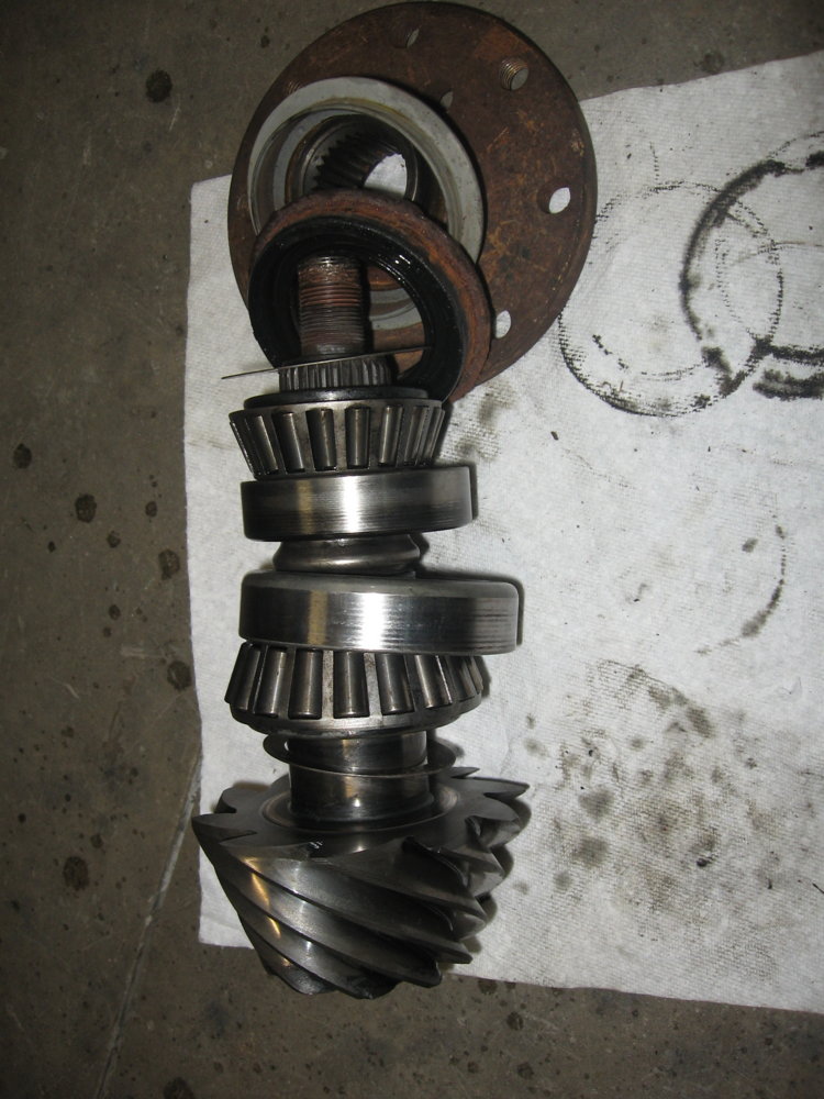

Here is the pinion and all it's 'stuff'
From bottom (pinion head) to top (nut) in this picture is as follows. Pinion depth shim (by my measure with a micrometer, I get 0.027", inside bearing (Koyo, P/N M802048-N), inside race (koyo P/N M802011N), crush sleeve, outside race (Timken P/N M88010, outer bearing (timken P/N M88048), slinger (not sure if that is the right term, 0.018" but I don't think that thickness matters here using a crush sleeve), oil seal, dust shield and finally the flange. Also the teeth on this fawker are sharp as knives.
Now I had an empty case, cleaned it up with brake cleaner and also the tubes. Was like cleaning a bazooka with a broom handle and rags.
Now back to the carrier bearing journals. @Cperry, you've got me nervous now. I went out and looked again. I don't feel any lip on the carrier housing on either side. I feel a very slight 'edge' on the drivers side bearing cap. The edge is on the outside and if I had to guess it is way less than a thousandth (hell I don't really know, I can feel it with my thumbnail). I don't see wear or scoring but now I am a bit worried about this. I don't want to weld a $350 bracket on this thing to find it's fuct. :eek: I tied to get a meaningful picture if it but it was futile, my camera isn't good enough to focus at that level of detail. This 'edge' is right where the smooth part meets the unmachined part of the cap edge. It's probably at the point where the shim is sitting that far out. I did notice when I disassembled that the shim on that side seemed to have some wear pattern (this was the OEM cast big ass thick shim). I don't know if any of this means anything to anyone reading this. happy to hear opinions. Maybe it need to go get another donor before I proceed??
