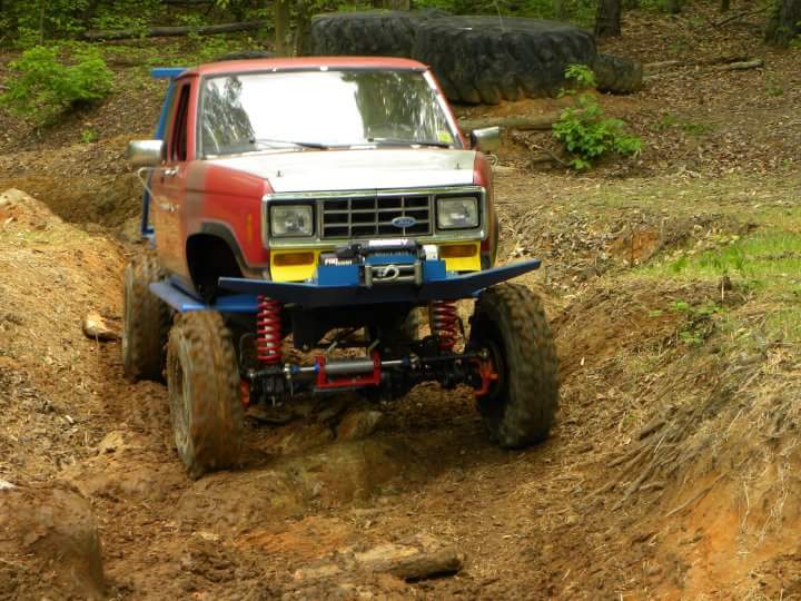

My old girl now derelict. Robbing axles and sold the 4bt i bought for her.

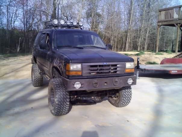

This was my gateway drug. Bought it as a parts truck for my DD and things kinda got out of hand. It went through a couple stages, but this was the day I sold it to a friend.
It was 250k mile original 4.0, on its 2nd A4 rebuild, 5.13s, welded disk 8.8 in the back, aussie in the front, warn locking hubs, 6" bronco II front lift (soft) and SOA in back, and 3" body lift.
This was when I enjoyed it the most. This was the 3" body lift and 2" front springs with AAl and shackles in rear.

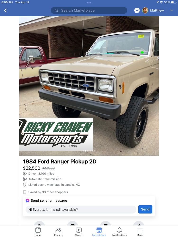

Apparently Ricky Craven smokes crack!
yikes i think that was the first year for the a4ld. Would pay $10,000 and not a penny more! 1994 was the last year for a4ld which is maybe why the one i have lasted 120,000+ miles! Apparently, if the one I have in it it ever goes out, you can just switch out the steering column, bolt in the manual, and switch out the cup holder area like legos and it will be no different from a factory manual.
