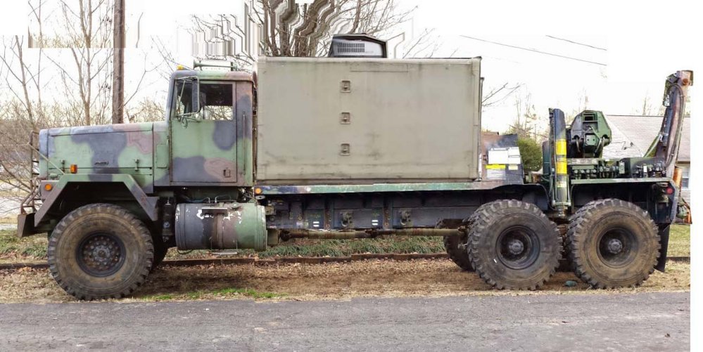

I will be keeping this truck, my plans are to convert it into a wrecker truck of sorts down the road sometime (boom, rear winch, and hydraulic outriggers). I already have all the stuff to do it, but waiting till after I get the cab on. Below is a picture of what was planned before I decided to do the crew cab. It will still be similar, but I will be using a smaller box than what is pictured.

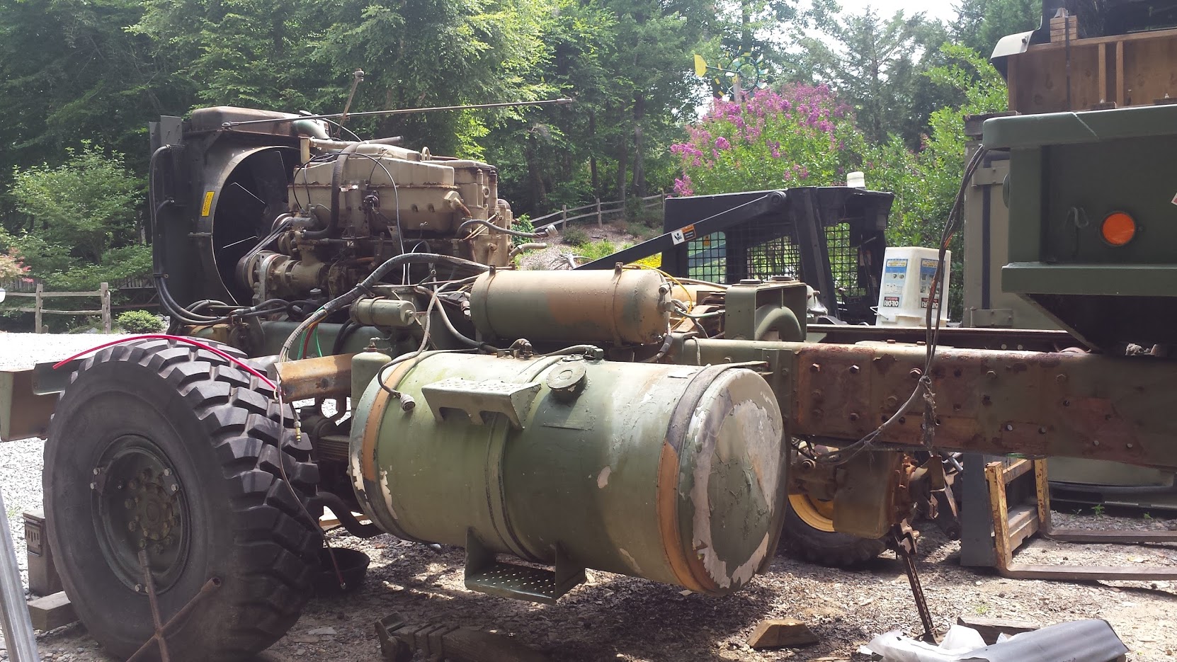

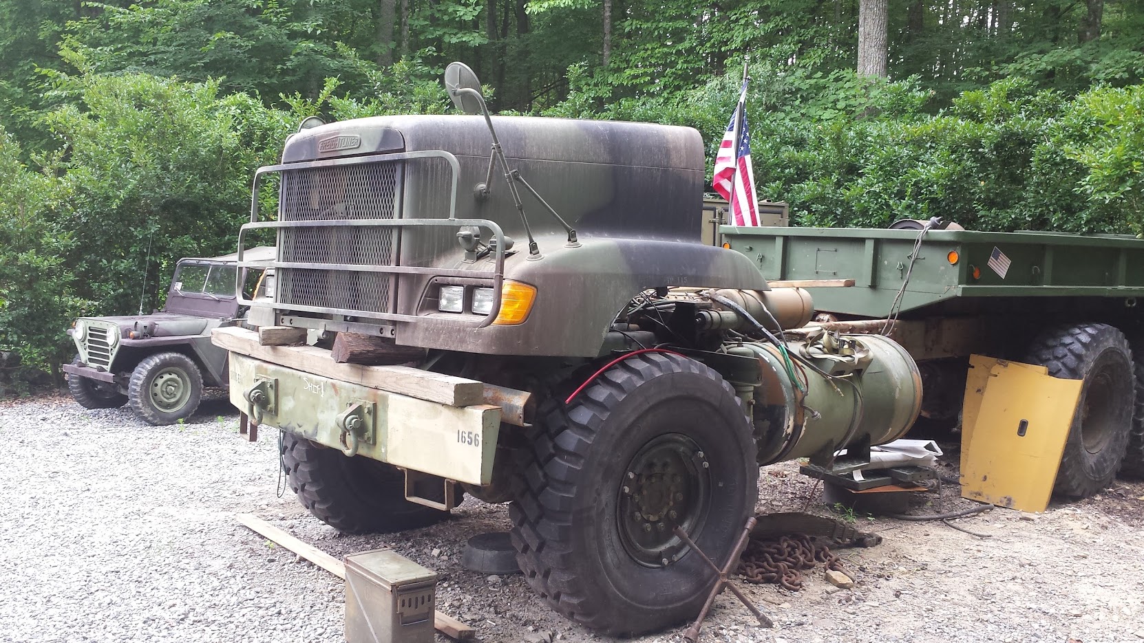

Plans changed slightly. Instead of tearing apart my M920, I decided to just install this cab on the M919 I plan to sell, that way I can get it back to running/driving condition and get it out of my parents driveway (and hopefully sell it). I just picked up another Freightliner cab last week, and bought another I have not picked up yet, so I will use those to crew cab and install on my M920 at a later date.

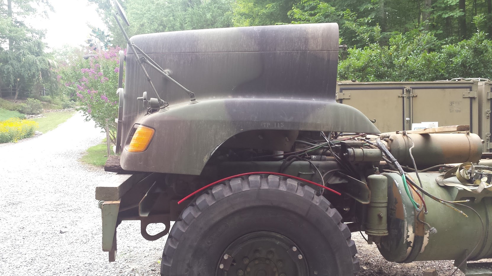

As you can see in the pictures above, I will need to trim the front fenders to better match up to the radius of the tires. The hood has to sit pretty high just to clear the radiator, I figured it would be best to mount the hood first and then match the cab height up to it, since the height of the radiator means I may have to raise the whole body up higher for clearance. It's already 12' tall, what's another few inches?

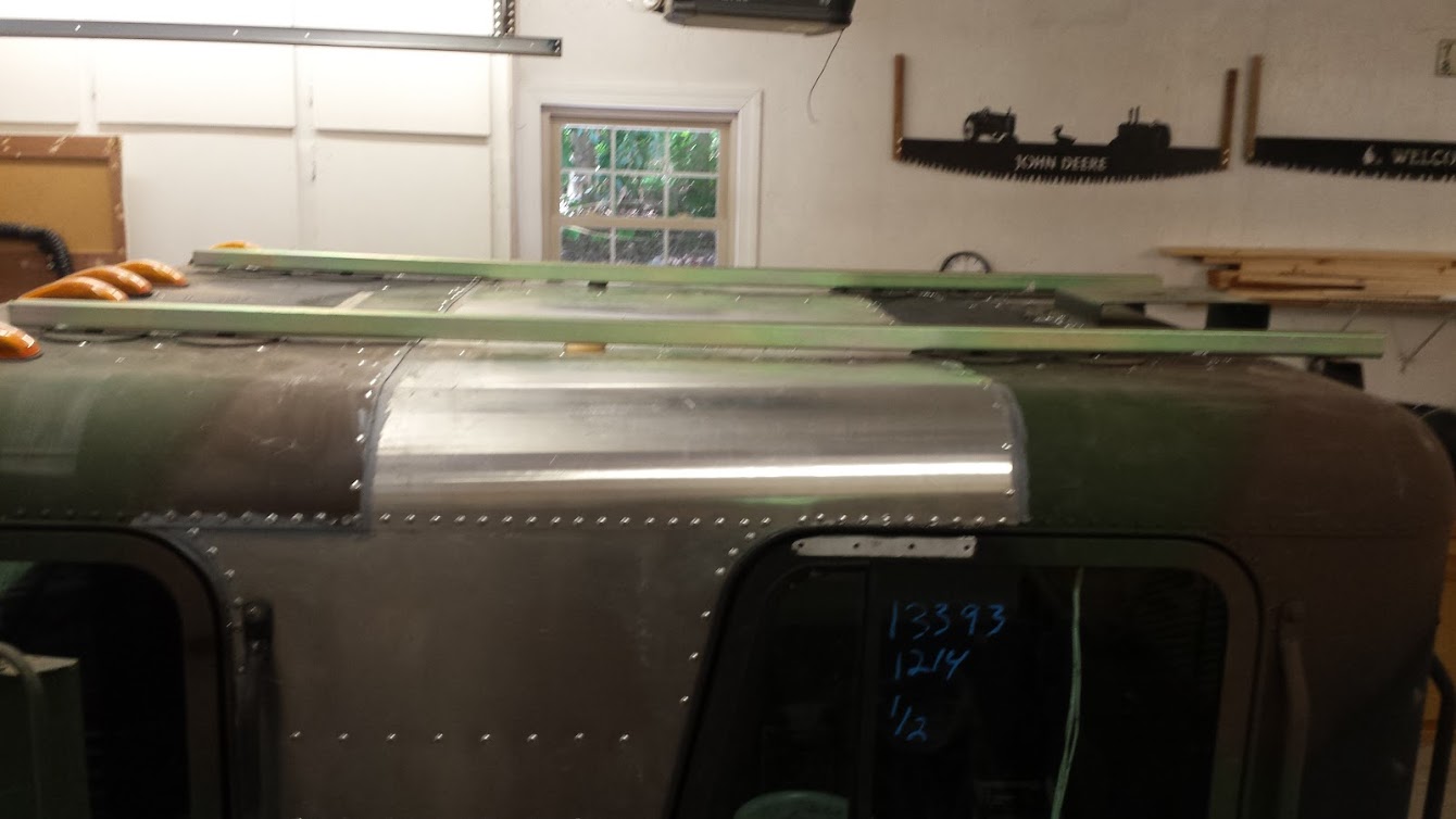

Rivets are all done except for a few pop rivets where I can get to the backside to install the 'noisy' rivets... GLAD that is over, I dread having to do all this over but it has been a fun project so far. These model trucks were spec'd with mounts for a roof rack, I used those factory mounts and put some uni-strut up there, it REALLY stiffened up the roof. I also ran an interior brace from left to right that is slightly in front of the rear doors. It will double as an overhead console area for rear passengers. There are bolts run down through the uni-strut that attach to that cross bar assembly. I was able to climb up on the roof and sit in the center, before all the bracing the roof was pretty flimsy feeling, you could see it flex when slamming a door shut, now it is very rigid.
Overall, it's not perfect, but when it is 11'+ in the air I don't think anyone will notice.

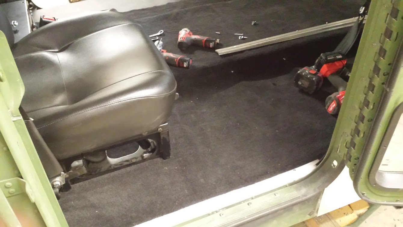

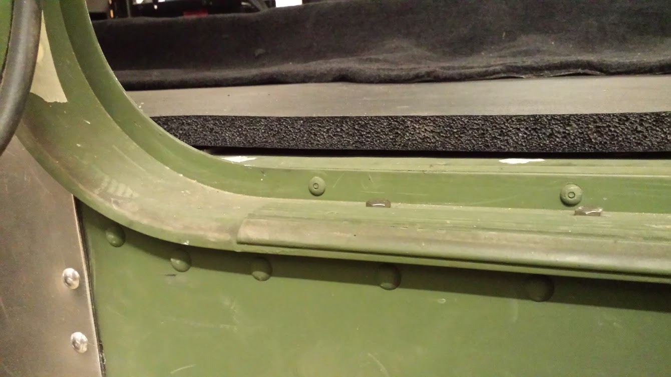

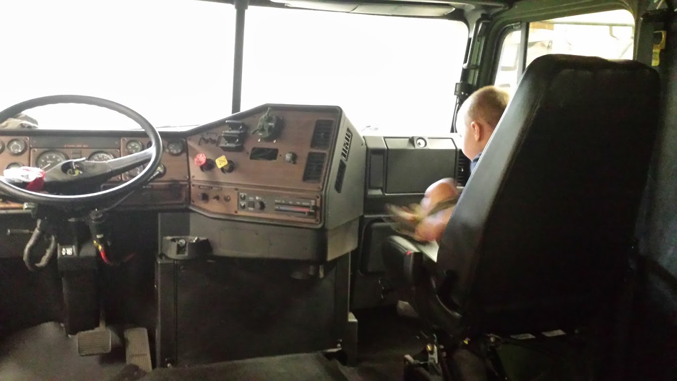

3/4" thick (maybe 1"?) neoprene-ish insulation on the floor, with black carpet on top. Still have a little to finish up tomorrow, but as of now three seats are mounted in it. This insulation should make things nice and quiet in the cab. I'll be putting some in the walls and ceiling as well.

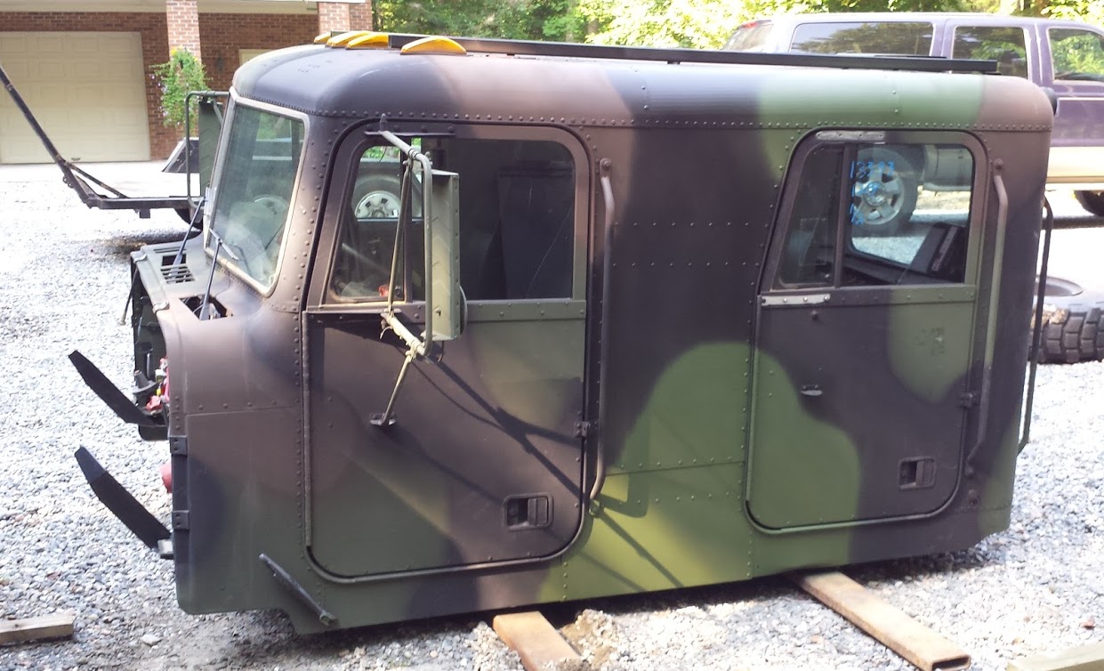

Thing of beauty! I will have some paint touch-up to do, but for the most part this is what it will look like. That is the wonderful thing about military trucks, even when building a nice one spray paint does just fine. I painted the bare aluminum with epoxy primer first though.
