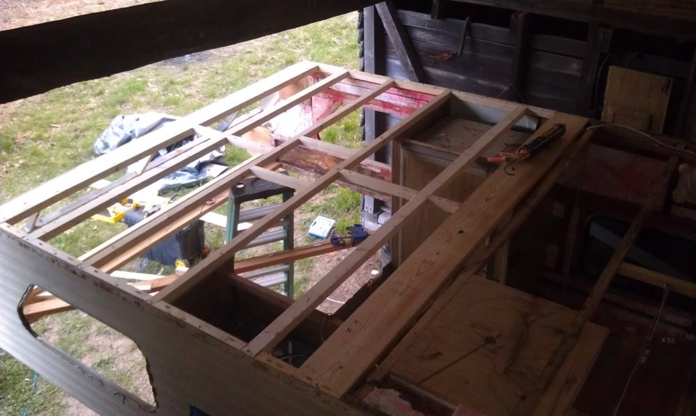

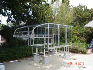

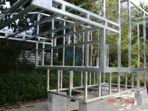

Here are 2 pics of my aluminum frame. Sorry I did not get them up sooner as I have been under the weather. Looks like your making great progress.
Tom
alot of campers nowadays are constructed with alum. frames.
good looking work. the best part is, now alot of it will be done better than it was when it came dn the assembly line. and now you understand why most people run from campers with water damage. you have to stay on all the silicone seams. or these things will rot dn right before your eyes.

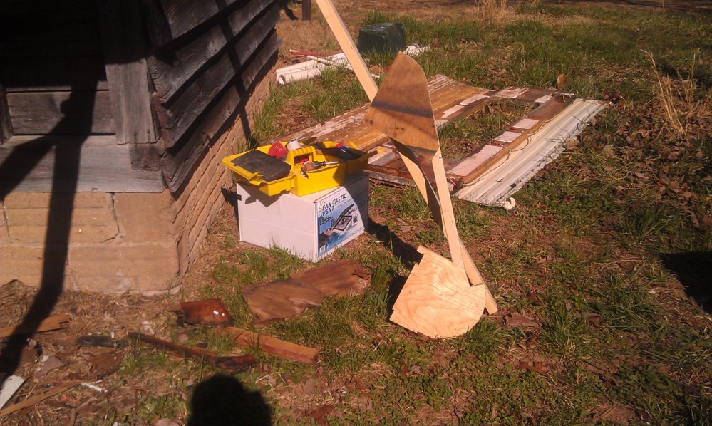

Been pretty busy lately plus the fact that the next step is to remove the roof so I haven't done much. I did make a deal with a friend to use his barn so I'm bracing things up for a short 3 mile ride.
One of my other problems is taking the fiberglass topper off of my truck by mysel so I can load the camper. Had to make a stand to keep it off the ground and allow me to do it with no help.

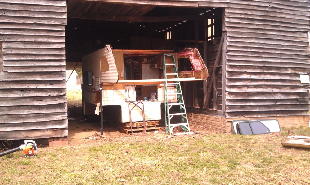

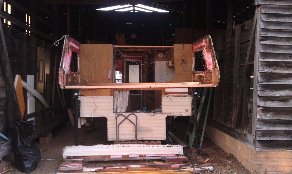

Haven't updated in a while but I have made some progress. I got the camper moved to the barn before Halloween. I can only go back so far, so I'll hang a tarp off the barn to cover the 1 foot of the nose that hangs out.
Now I am able to easily access the roof. There are a million screws that hold the edges of the rubber roof on, not to mention the screws that hold the vents and such that are covered in years of hardened caulking.

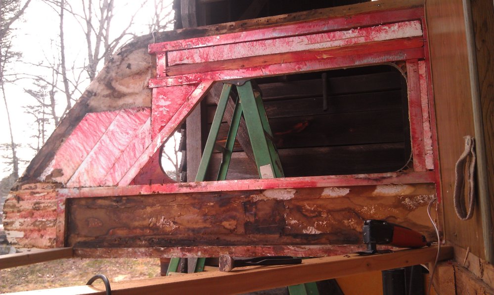

All of the vents and a/c have been removed and now begins the removal of the rubber roof and frame work. No surprise, its rotten!
wow.... that thing was rotten LOL Looking better though.... I woulda cut my losses after seeing the overhang

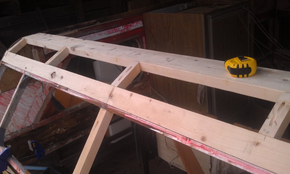

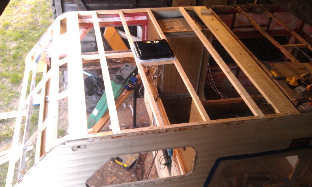

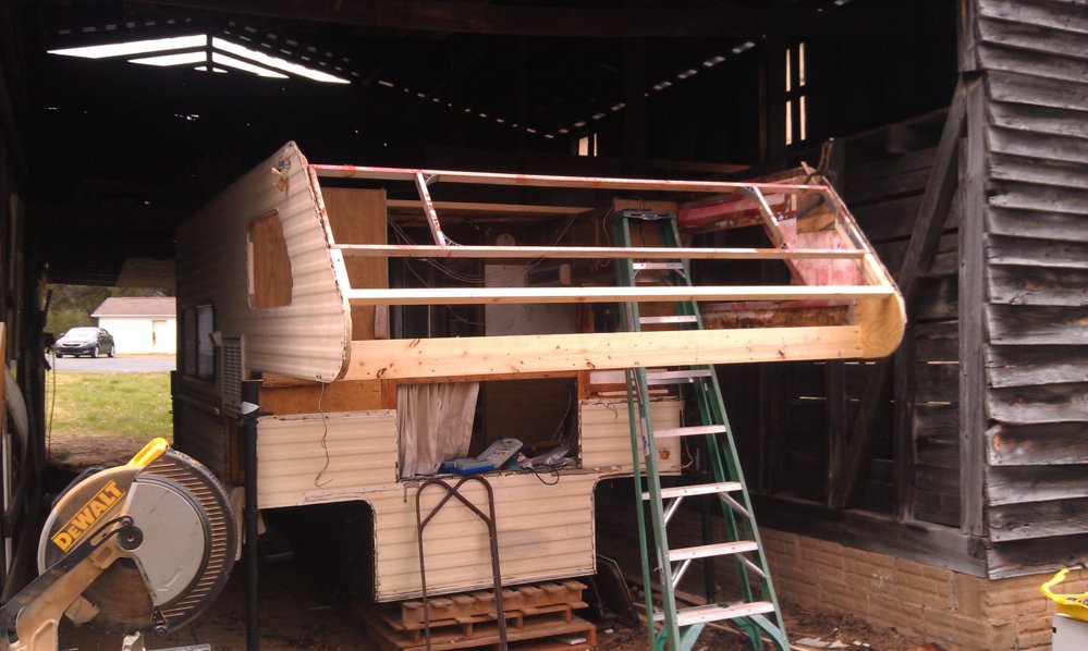

Worked on cleaning up the front sides today and reconstructing the structure. It was missing a lot of the original structure when I got it, and of course the other half was rotted off. Once I made one side, I just reversed a copy for the other side. Again, glued and pocket screwed together along with a couple extra tie in boards for additional strength.
How do you eat a whale?? One bite at a time!

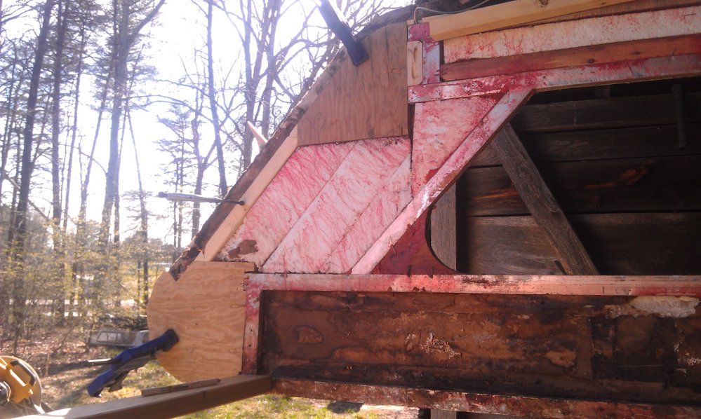

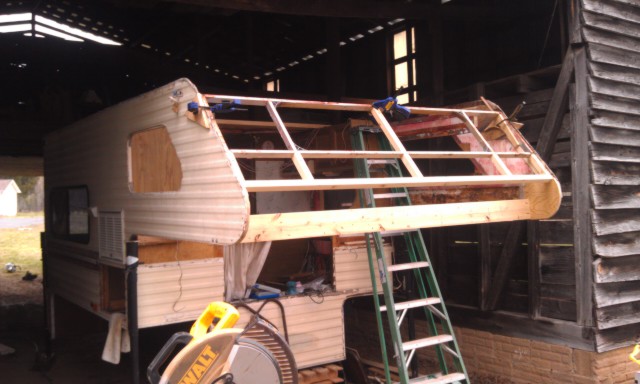

Took another bite out of the camper today but this time I put something together instead of tearing it up. Yesterday I prepared the sides and today I rebuilt the front nose.
Its nice to finally have something worth covering and protecting again.

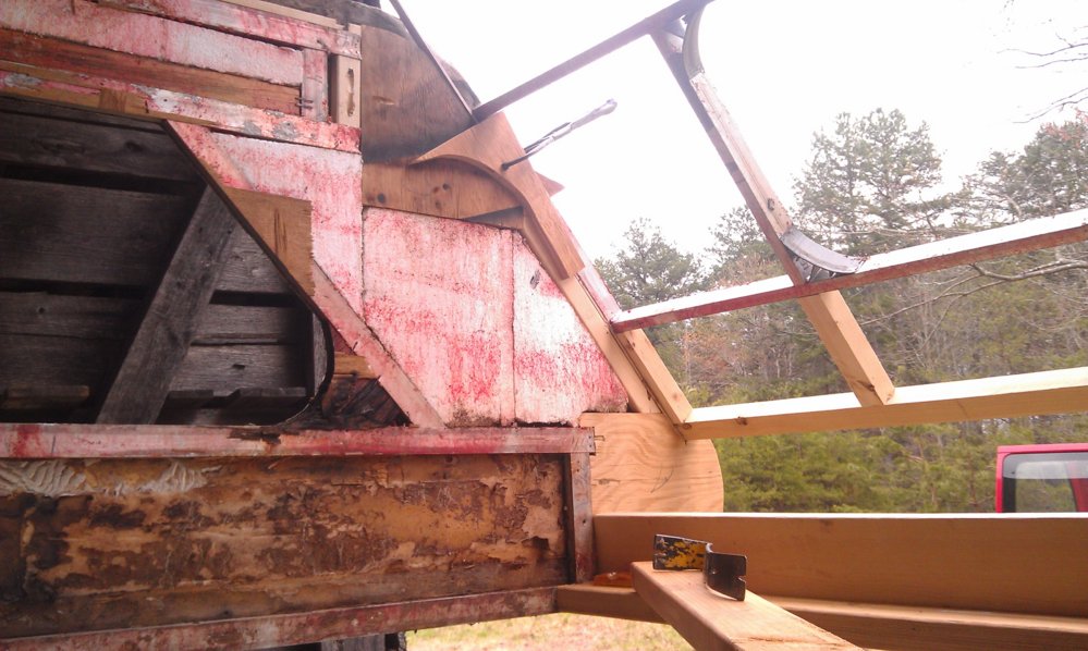

More rebuilding this weekend. Starting to look like a camper again.
