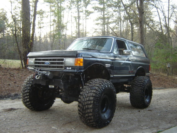

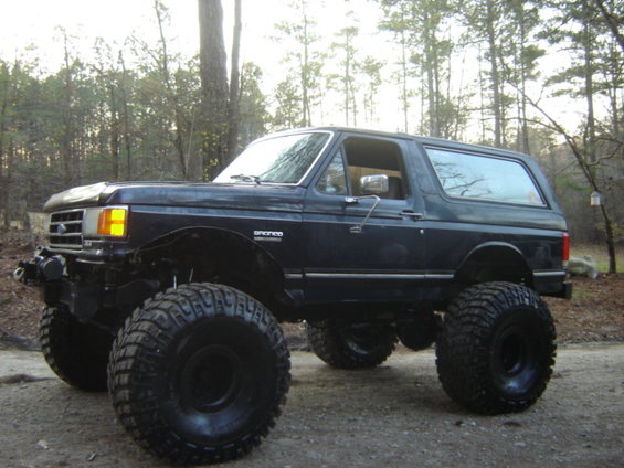

yeah, that front crossmember/spring hanger looks ALOT better.

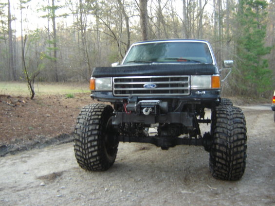

What happens when you happen to catch a rock on one of those forward facing fittings on the steer cyl ? Or the hydrulic line gets pushed back into the pinion brake rotor ?
sure hope you are not in an awkward situation to where you actually need steering.
Not pickin, just pointing out some things, NOTHING ever goes as planned when shit goes bad, plan for it.
iam wating on a high steer arm to move the steering ram...yeah...its only temp right now...im not going to wheel it like this..i jsut needed some to move it

i like the rockwells under your rig. to me rockwells are the best bang for the buck. yes they are heavy, but they hold up to a heavy tire and a heavy foot! you mentioned about using a shackle from an f250 i have some and they dont look any stouter than what you have. have you seen sky manufacturing? they make a nice rear shackle flip bracket that you could make and it would be a lot stouter than your factory part thats been modified. i like the bronco i thought about building one sometime. good luck with your project!
Frame horns look a hell of a lot better. Still need to address those ghetto-ass hacked up shackle hangers, though. :flipoff2:

ive built some traction bars fornt and rear..the front had more wrap than the rear did..they are made of 1.5x1/4" dom tubing and 3/4 heims and rubicon express brushings on the axle end. ill try and get some pics up soon. also the steering ram was moved to the rear of the axle so i wont be smacking it on rocks.. ill soon work on a rear bumper and exo cage..right now im waiting on my double beadlocks should be here next week..those im excited about...oh yeha i got the sexy rock ring on them too....since the wheels are going to be so pimp im painting the rock rings hot motherfreaking PINK Yes sir!
