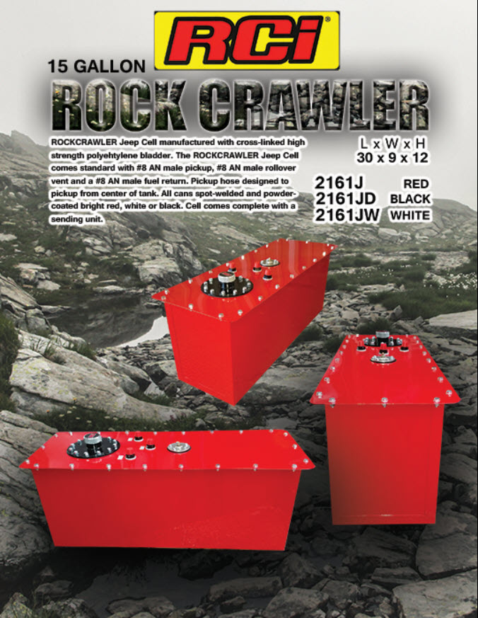

I don't know anything about these, but they sound good.
I guess they are not available yet:
2161J | JEGS
2161J | JEGS
I looked at those but think it might be hard to package. I also want a 15+ gallon tank. The square tanks I think are going to fit better but we will see. I could be really lazy and put the fuel cell back where it was originally..... but it’s right behind the seats and I want some kind of separation from the fuel cell.
I’m following for the recommendations as to good, bad,and in between. I’m in need of a cell for my ‘80 Toyota but I would really like to figure out how to keep my stock gauge. I looked at the write up on those RCI cells and all their other products have good reviews so hopefully these will be good too.
2161AB is not the same cell. It’s just an aluminum cell. The ones above are aluminum cells with bladders
That is the one with the bad history of broken weld seams, correct?
Ya I believe so. That was originally there offroad cell and after they had some serious problems with them cracking after a year or two of use they thickened the aluminum and then added a bladder they are suppose to fit into the rci fuel cell strap kits everyone makes now
