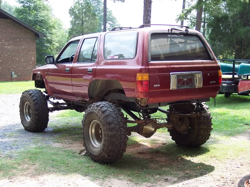

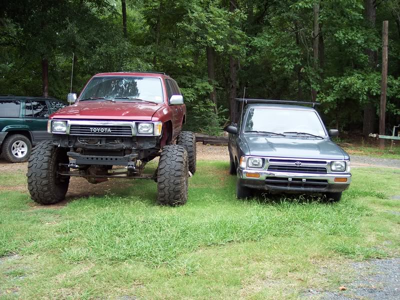

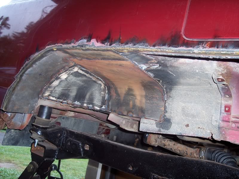

thanks, yeah that pic makes the approach angle look better than it is, the frame sticks out about 4" more than the tires. i got rid of alotta rust with the fender trimmin, theres still some more in the doors and rockers. i dont care though, the AC still works.:huggy:

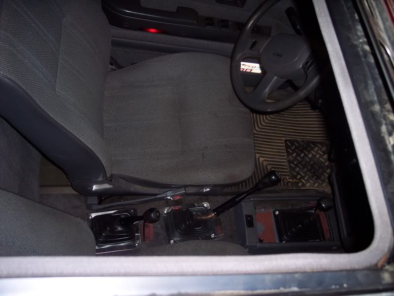

got all the shifters in and drove it around the yard with no brakes. this thing CRAWLS
glad to hear you are happy with the tranny set up so far man. The runner looks mean and that shifter setup looks slick. Its good to see someone making some progress.. Hope to wheel with you soon....
