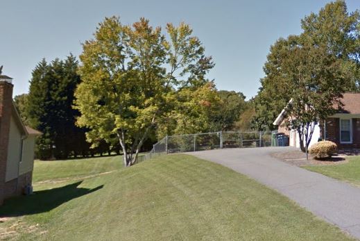

We are looking pretty seriously at a "new to us" home and I am trying to figure out my workshop options?

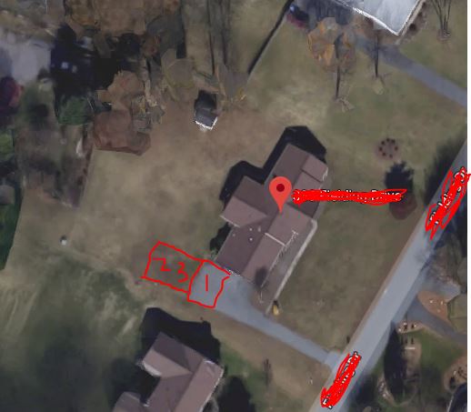

At the end of the drive, past the garage door, there is currently 22'x30' of asphalt (30 is wide, 22' to end)
Then the land drops off pretty quick, sloped down into the back yard. I am hoping some of you engineer / construction types might have some thoughts / knowledge on what my options might be?
Option #1, thinking about just doing a carport over that 30x22 section of asphalt, and tuck as close to house as I can get away with. Probably fairly 'inexpensive', beams, trusses, roofing and probably brick the front corner columns at least to match house. (Option #1b, go ahead and enclose / garage doors instead of carport)
Option #2, fill in dirt? You can see the slope, could I extend the drive even further, more asphalt (or replace with concrete) and maybe go out beyond the 22' to 30-36 or more? Can you fill in dirt / then build concrete pad / garage on top or just asking for problems or simply $$$$?
Option #3, 2 story garage thingamabob where instead maybe remove dirt / create a wall so my cars stay on original asphalt area, but then have barn flooring going out and a second entrance coming in from the yard side where I could park tractor, and other stuff? In theory this could have taller door too, and basically 2 story on the yard side?
Would love to get feedback, especially $$$ feedback as I am all over the place. I would guess #1 would be "cheap" maybe under $5-10k? Option 2 or 3 climbing up to 40-50k or something?
No HOA, but in Kernersville city limits so will have to comply with codes, but trying to figure out if I can build a nice workshop or if I will have to stick with smaller carport / workshop option.

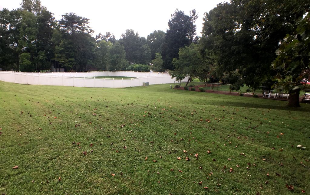

Yeah option #4 would be to make the slope more gentle where I could drive out deep into back yard and build there... I am sure the off-road toy would have zero issues but the Mustang?
I might could drive around the other end of the house, but that brings up a different discussion about old septic "lines" and driving across them. The tank is either gone or covered under patio now but the field is out back on that side is my guess.

I would pave a driveway all the way back there, and build it up as necessary so the driveway slope isn't too steep. I would do asphalt to save money, then concrete for the last 20' right in front of the garage.

By installing anything there, are you eliminating vehicle entrance, to the house garage? You would still have the garage for storage, lawn tractor, & small shop, ect. The area in question, would take a lot of Fill, & if you are building on it, would require Proper fill, & compaction. I'd be more tempted to excavate it, for a lower building/carport/whatever. But, then a Wall is required. That Could get expensive. Appears you Don't have a basement. What a Waste, with all that hill! I Love my Drive-in - Full Basement. But again, That would cost You! I would think your Main concern right now, is making the Purchase, & Payments. You got Plenty of time to decide Add-Ons. Good Luck!
Whatever you do, get a GOOD grader. One that knows the limitations of proper lifts and compaction. City of kvegas ia one of that most difficult inspections depts to please in NC. And given you pay more in taxes in the kvegas ciry limits than 90% of the state youd think they'd be less of a total twatwaffle than they are.
