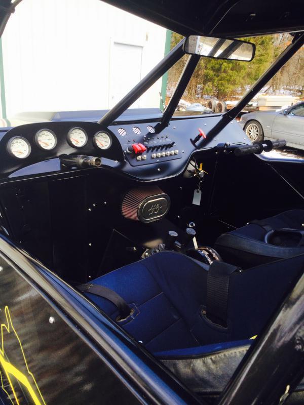

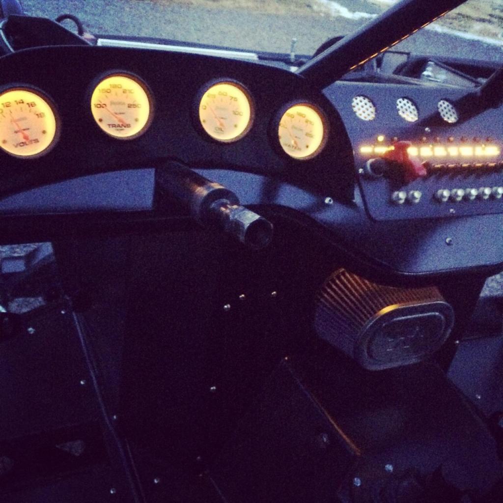

autometer (pretty sure Phantom)
sorry it's a terrible pic
ai7.photobucket.com_albums_y280_1TFROT_MandM_20buggy_1668538d1eb84a03267fb37fdb30fae5e9368ad29.jpg
tried to go with a yellow backlight to go with the theme
think they are 2 5/8

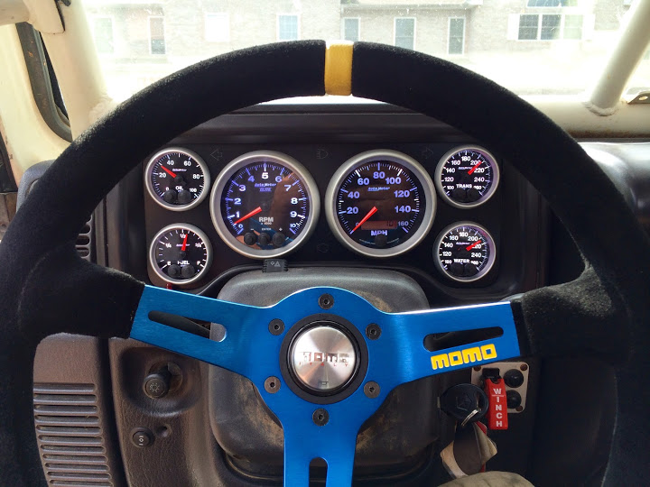

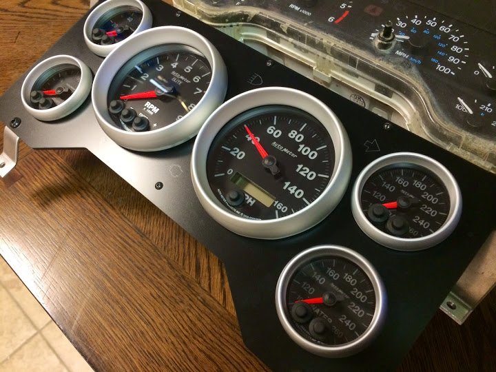

I'm running the Auto Meter Elite series and through 200 miles or so, I have been a big fan of them.
They are programmable with 7 different colors and alarms that work individually or together. They can also trigger other functions-
