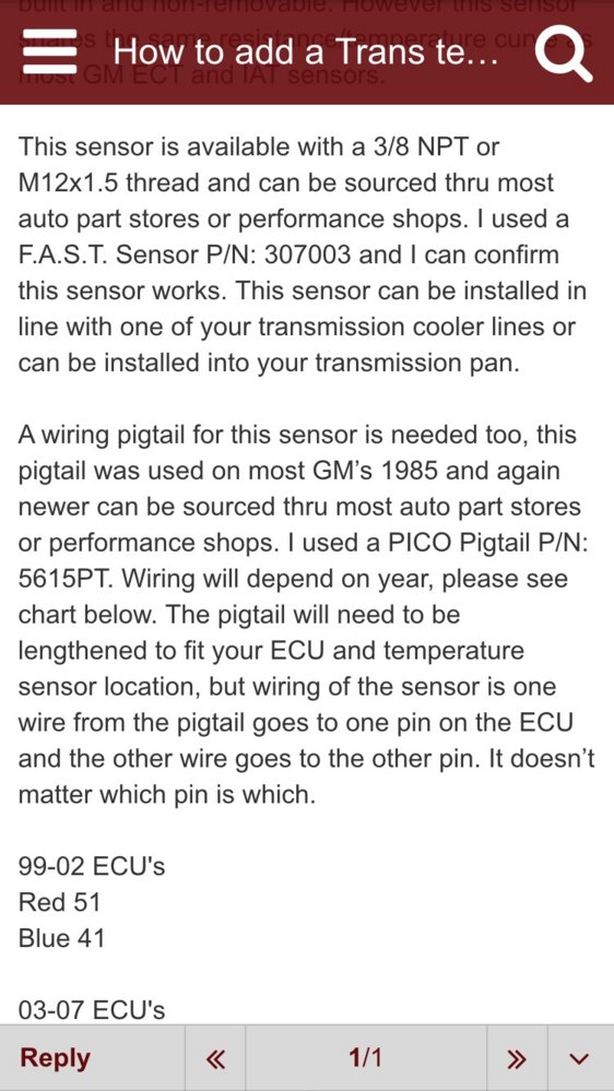

For the trans temp, I could also is a CTS in lieu of a IAT as it already has 3/8" NPT threads and is made for liquid contact where the IAT isn't. I'd need one for a 90 Camaro with tuned port and it will work great. Just feed it into pin 51 and ground it and I'm all set. I'd just have to install a bung on the oil pan. :D

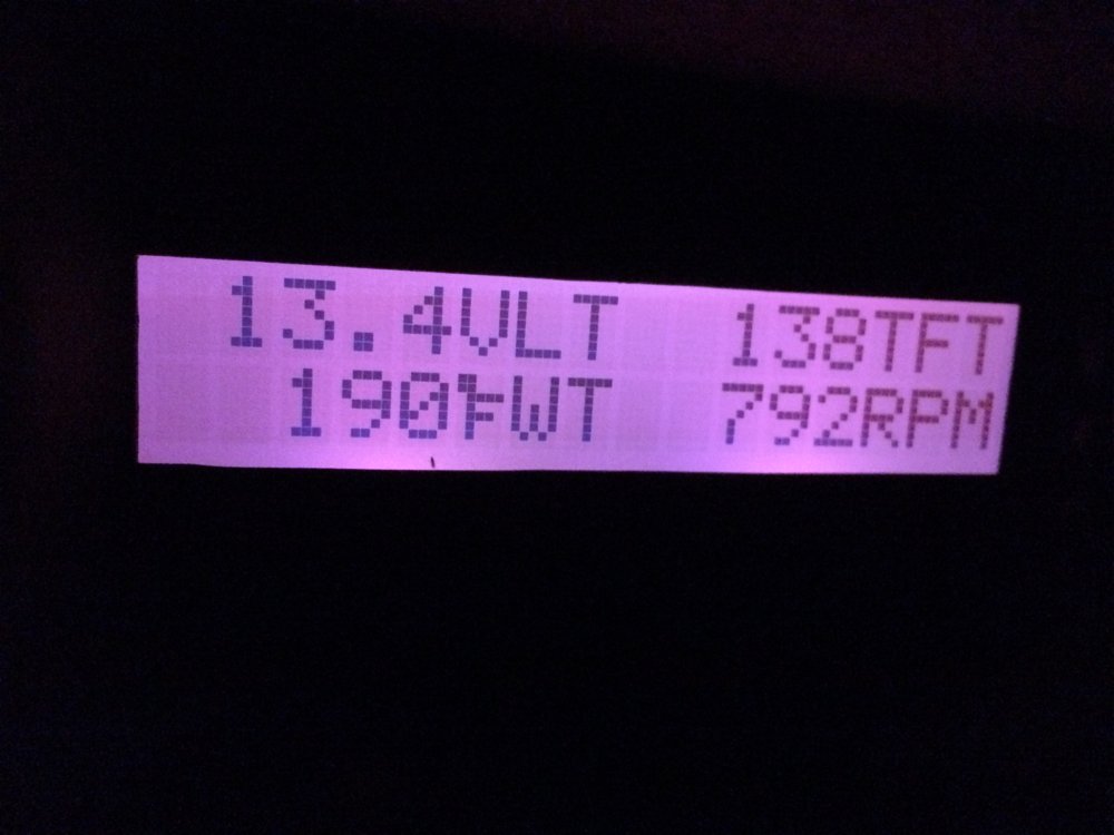

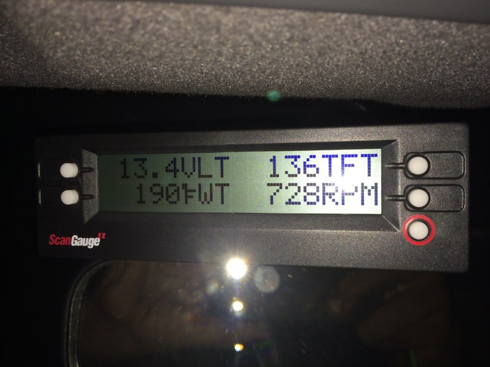

or go minimalist, programable to read anything your ECM supports thru OBD2/CAN
ScanGauge2 with XGauge 5x2", mount in a water proof enclosure, buttons can scroll thru multiple gauges supported by ECM ( will do fuel pressure if your ECM supports it)
TFT is trans temp on my Tacoma that had to be programed in.
Could also get an Ultra Gauge, cheaper and has a larger display with all the same features.
