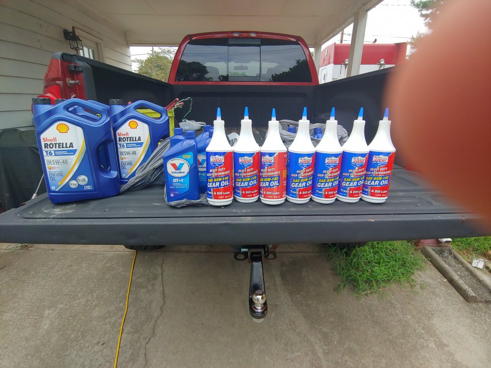

I have run lucas in everything since ecgs recommended it to me years ago. My dodge has seen some rough miles with too much weight behind it and is holding up well.0827191701_HDR.jpg
I have run lucas in everything since ecgs recommended it to me years ago. My dodge has seen some rough miles with too much weight behind it and is holding up well.View attachment 337541
Do they carry it in 5 gallon bucket size? I guess that's more of a question for my parts store guy. Since both axles, trans and T-case call for roughly the same weight, that should take care of everything.
Not sure but I know I had to order it for my dump truck because all the local stores combined didn't have the 70 quarts I needed to service it. Lol
Yes, cheaper by the gallon off amazon though.
