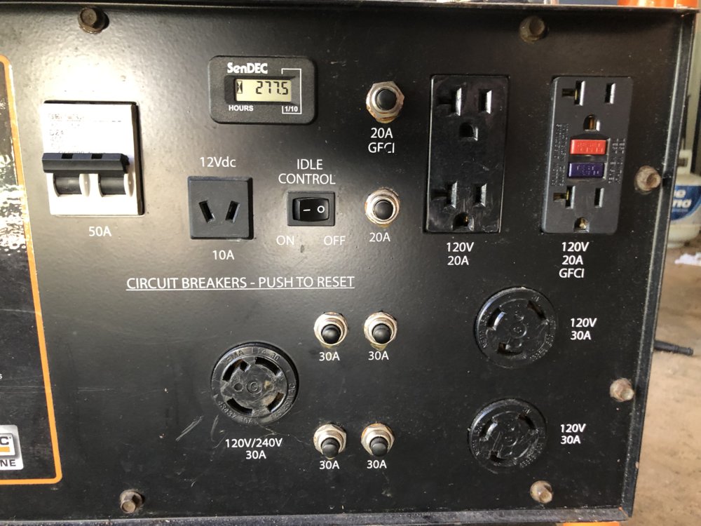

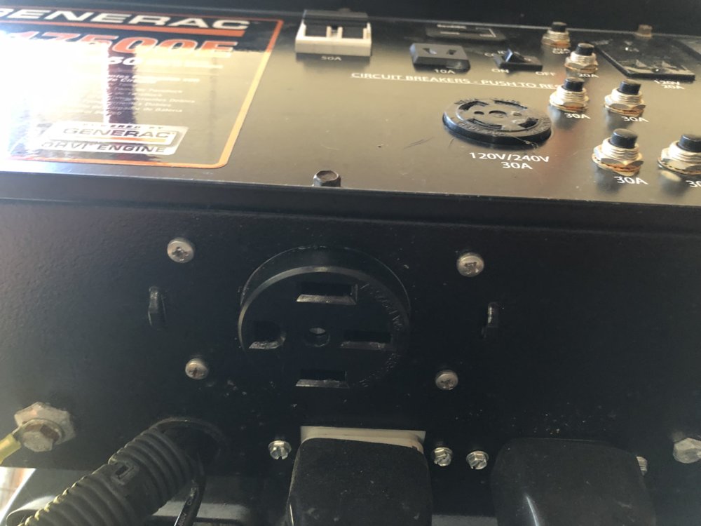

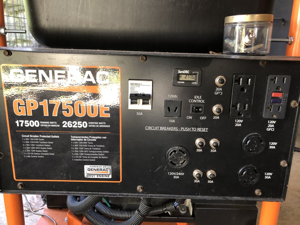

My power went out again this morning (old neighborhood lots of old trees all line above ground yadayada). I have talked about this generator before; it should power my entire house. Unfortunately a breaker on the generator keeps popping when a 220 load kicks on. That shouldn’t happen.

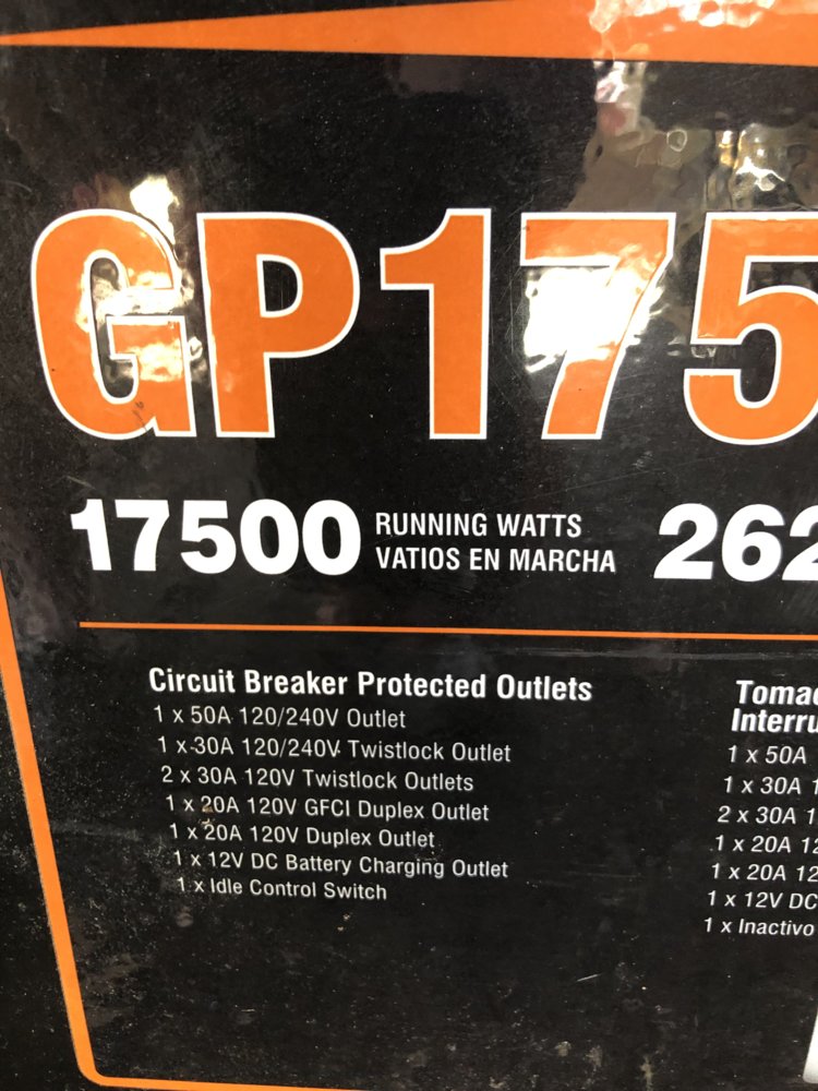

So let’s make sure I am not 100% stupid. First question, is there a 50amp outlet on this one? To connect to the house which outlet should I be using?

As far as to the house, I think so... it is the same wires I used for my old 8kw, but I never used and 220s because I knew it couldn't handle it. Whould too small of a gauge of wire be causing this?
Was the 8kw 220? I run my house off a 5500w, well pump, electric water heater, 48000btu air conditioning, etc...
Well thanks to @a_kelley and google, for helping me out. As this is an older model, the dang 50amp is on the bottom side of the panel. Got some re-wiring to do now.

I think trying to run the whole house on the 30a was/is my problem. Hopefully this new found info will be the trick.
The breakers worked!

It shouldn't make a bit of difference. Where are you even finding a 50a plug to feed the house? I've not seen a house-side portable generator plug that's rated for more than 30a @ 240v.
You said it pops the breaker if you try to run "anything" that's 240v. A water heater is 3500-4000w, a well pump is 1500w, a heat pump is 2500-3500w. Any one of those should run just fine on a 30a circuit, even with some 120v lighting and plug loads on top.

My other statements may not have made sense, I was “interneting while pissed off at something” haha. The hot water heater tripped the breaker on the genset, once I turned that breaker off in the panel all was well.
As far as load/wiring/etc this was installed by an electrician as it is out of my realm of knowledge. @Ron this is the same setup we discussed a few months back.
I am going to get the electrician back out here and discuss the use of this new fancy 50a outlet I discovered to see if it will make a difference and also hopefully run the 5 ton AC
