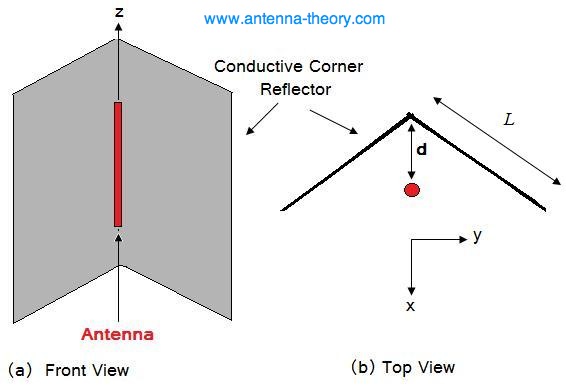

1- Spectrum sux.
2- Spectrum equipment sux.
3-Build this out of cardboard.
Don't worry about x,y,z, or l.
Make it a couple inches taller than the router or antenna (if it has an external one).
Make the cardboard square and bend where "z" is.
Cover the inside with aluminum foil and set it behind the router.
4-Spectrum still sux ...... run a speed test and you'll see you are probably no where near what you're paying for.

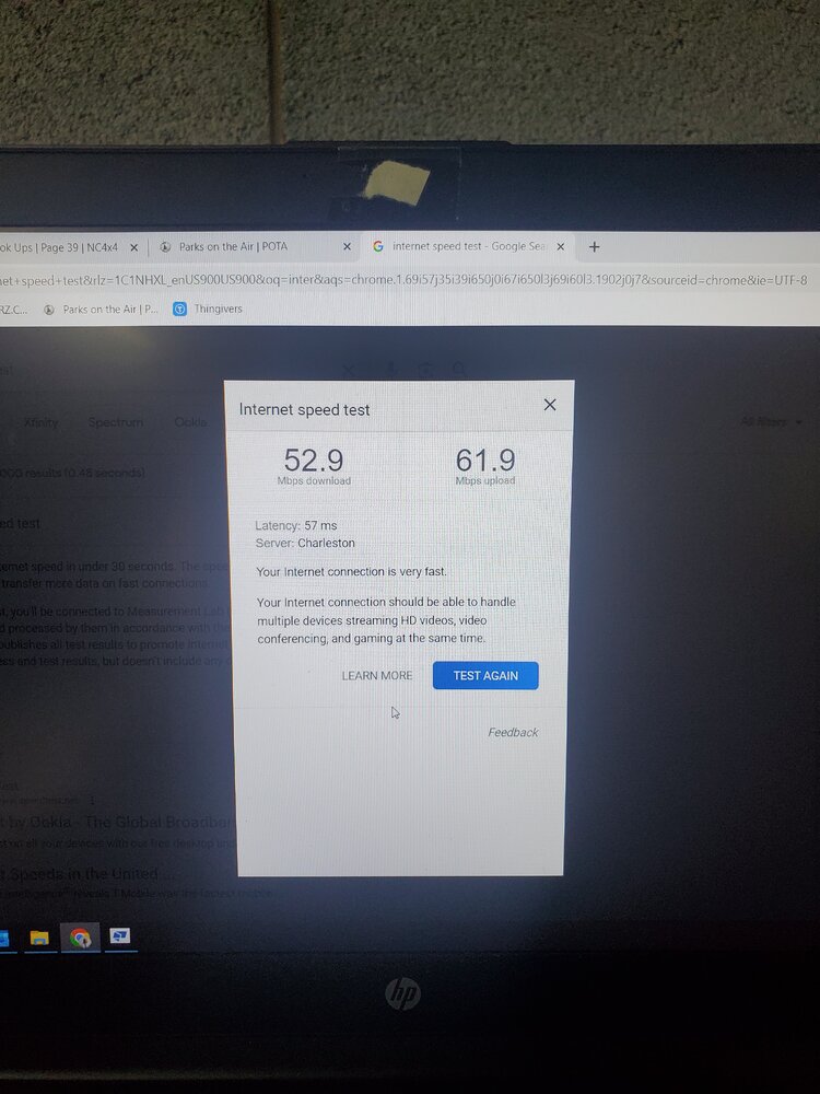

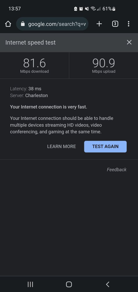

Got everything setup today. Ran 200' of cable from the house router to the shop and got a $20 net gear router. Seems to work good. The wifi is faster than the wired connection though. Is that normal?
