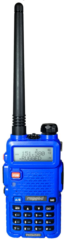

I have a Rugged Radio like the one attached and will gladly sell it to an interested party. I have no clue how to use it, no one that’s offered to program it has, and I can’t hear shit in my buggy anyway.
You and @Hoodw!nk both need the intercom system @StretchASU has in his YJ
