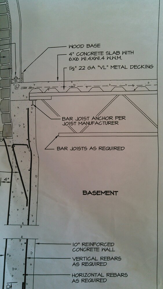

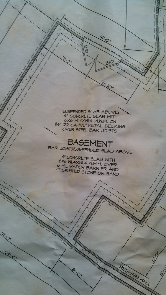

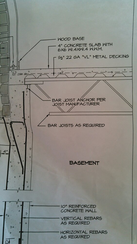

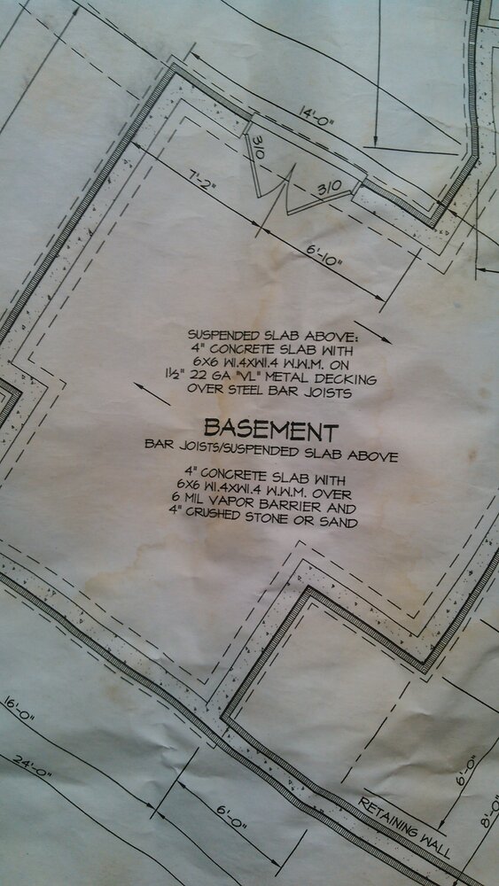

Side question for anyone that has a clue; I want to do a poured concrete steel deck for floor of the attached garage and pour the foundation walls around the perimeter so I can put the shop bays directly underneath it (doors turned 90° to the rear). Stuff like this is done for smaller parking decks as well as houses that have "safe rooms" and storage rooms under the front porches. I know it can be done but does anyone have any experience with that?
Worked on house a couple years back that had a garage poured over steel deck....somehow I ended up with a set of plans so heres a little visual info off those plans. Nothing really specific, but it's an idea of what it'll take......it'll be cheap too :lol:
"As required" let me just shift this responsibility to the contractor to follow the BARE minimum code will allow in order to get a permit. Then make the on site inspection dude liable for any and all failure

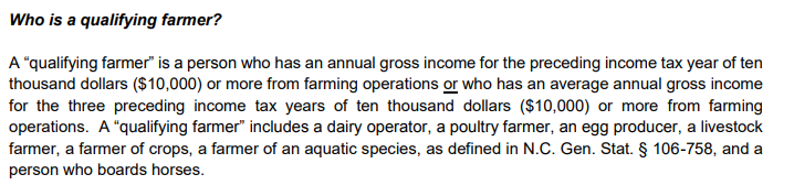

Edit: This is what the ncdor currently lists:
Haven't found the forestry requirements yet.
Edit edit:
This is the timber land requirement:
