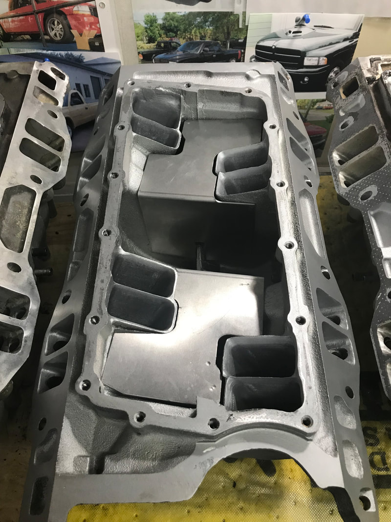

Poke around on this guy's site, he has some interesting ideas on how to ring some performance out of the magnum engines, while you are replacing the intake plenum gasket, you might want to install an oil baffle and one of the readily available thicker plenum plates to have a permanent fix on your hands.

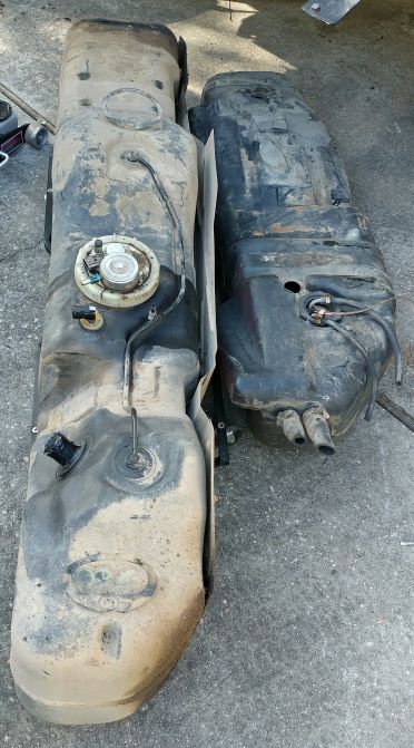

Here is the size difference between the Ram tank and the GW tank. I'm going to use a 1997 Ford Explorer tank because it has the tank inlet and over flow on the end and the fuel sender unit is in the correct location in relation to the GW tank.
