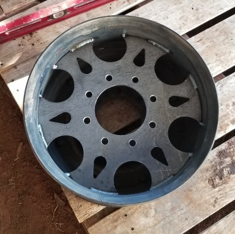

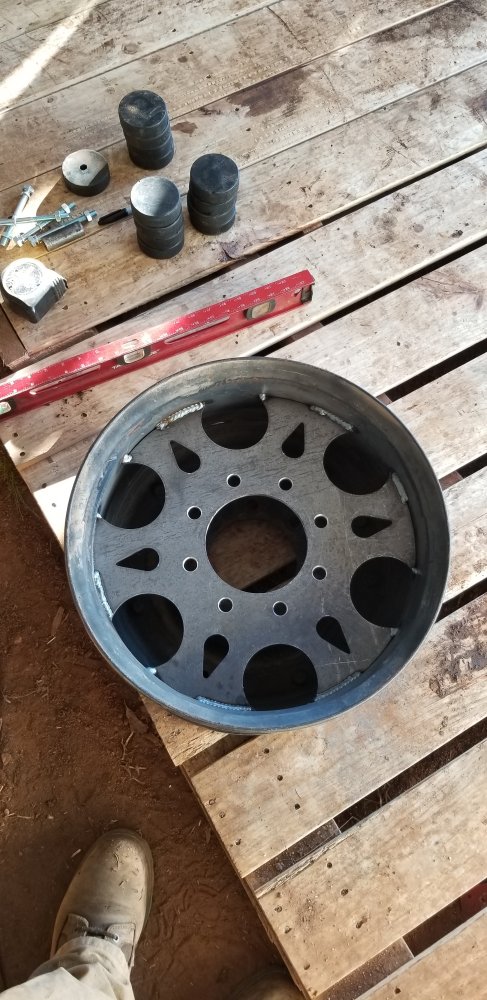

Build my first set of H1 wheels. Came out nice looking. They're stupid heavy lol (more traction) lol yes those are hockey pucks I used to get my even spacing. They get used a lot lol
It was, just cant tell in picturesClean off that paint off the metal before welding. Use a respirator as that paint is super toxic. And, need clean metal for a good weld. You sure as heck don’t want to breath those fumes from that toxic ass paint on those H1 wheels.
