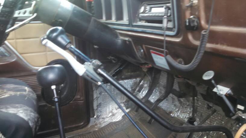

I have a bike brake handle on the shifter on my f150. I'll take a pic when I get home for lunch. I only use it occasionally if I need to start off on a hill without rolling back. If I'm already rolling I use the toe of my right foot on the brake and the outside of my right heel on the gas.

here's my set up.
